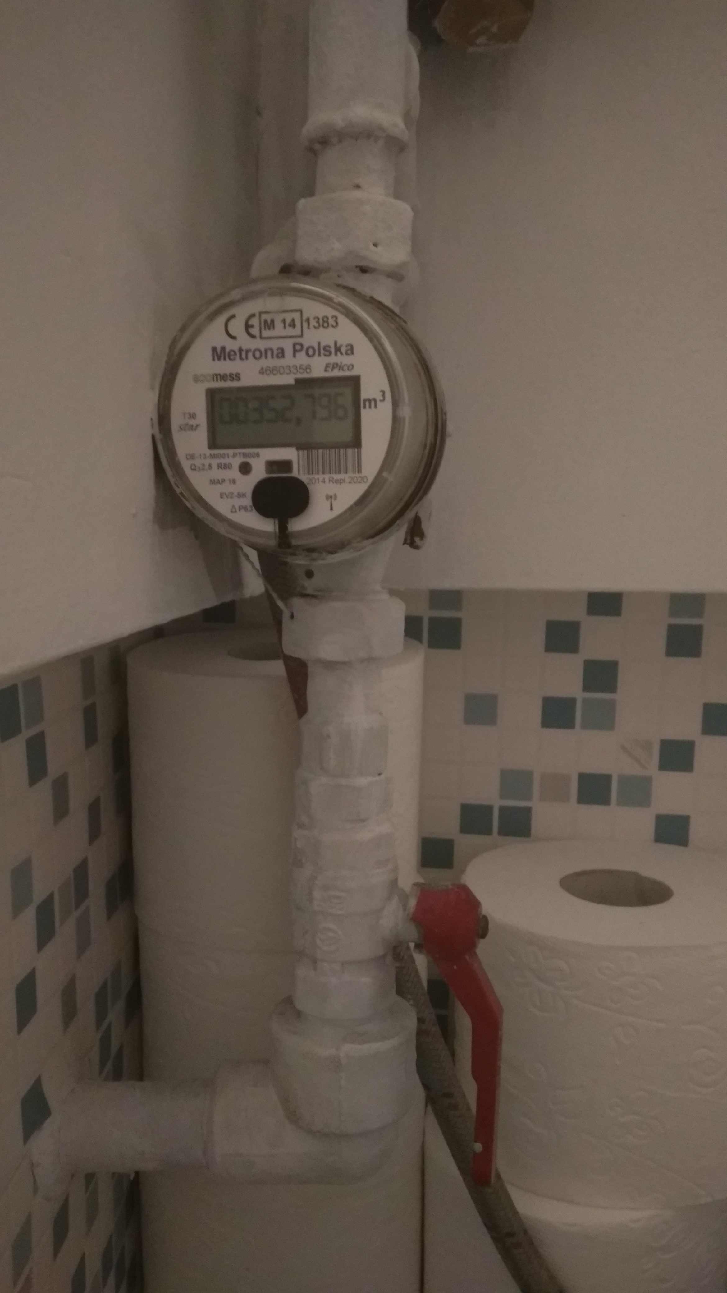

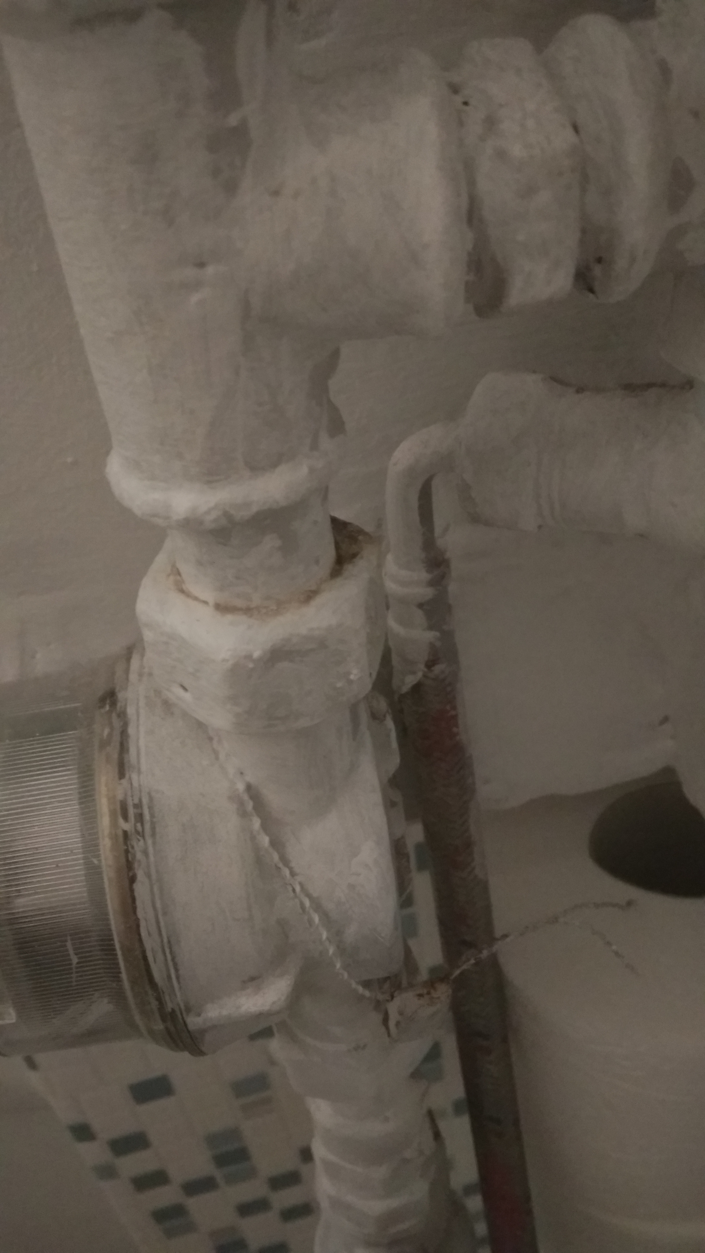

    Hello, maybe I'll start with the fact that I live in a block of flats. I have two things for you.
    1. Recently, I noticed that the water valve, despite being closed, lets water through, apart from the fact that it is damn hard to turn it at all. Does anyone know whether the replacement of such a valve is a matter for the housing cooperative or do I have to pay for it myself?
    2. Today, behind the counter on the cap, I noticed that a stone was forming there. It looks as if water seeped in there almost imperceptibly. I am uploading photos for illustration.
    Will the cooperative pay for valve and meter replacement? Do you think that it will be possible to replace both of these elements without removing the masking that adheres to the meter, you can see them on the left?

    It all depends on where the cooperative has an end of liability. If on the valve (i.e. the valve to the cooperative) then it should be replaced. This leak can be done at the same time when replacing the valve. The counter does not need to be replaced.

    Thanks for the quick reply. Do you think you can do it without any hammering and stripping down all this masking? Can the valve be unscrewed and replaced like this? I need to know all this because my spouse categorically does not agree to any demolition and forging, and unfortunately no matter-of-fact arguments appeal to her.

    Everything is possible - remember that your water meter is sealed.

    I will not do it myself, but I will call the cooperative tomorrow and I will know if they will replace this valve for me, if they do not, I will contact someone from the water supply, I will not mess with it myself.

    Rather, let the cooperative give some information on a good plumber because the waterworks can send it, but to the main meter. I don't know if they would like to come to a private apartment. But I think the cooperative has its specialists.

    Ok, that's what I will do, the most important thing for me was whether the replacement of such a valve is simple and trouble-free, but you wrote that so I am calm.

    If there is a good specialist, he will only leave traces on the painted caps and a new valve.
