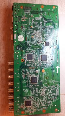

    Required memory batch for HIKVISION DS-7216HGHI-SH/A motherboard DS-80195 REV1.2
    SPI 25Q128 memory.
    Inverters started, but no reaction.
    Regards

    Did you manage to launch?
    I have the same model with damaged capacitors, I have already replaced it, but the recorder still does not start.

    I have 2 pieces and both are the same, capacitors and power supply. Could it be that the flash spilled from the power supply?

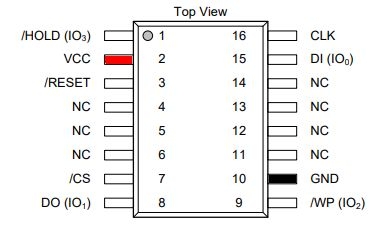

    And from the bottom, what does the board look like, is this SPI 25Q128 memory there? Does it get 2.7V to 3.6V?
    Memory Batch Requirements for HIKVISION DS-7216HGHI-SH/A, DS-80195 REV1.2 Motherboard, 25Q128 SPI Memory Batch Requirements for HIKVISION DS-7216HGHI-SH/A, DS-80195 REV1.2 Motherboard, 25Q128 SPI
    Sometimes you don't know what system this board is on, but I'm betting on HISILICON ... somehow I didn't find any information in the specification.

    25q128fvfg 16 pin. Pin 2 is 3.3v. Tomorrow I will have a programmer so I'll see what's in there.

    What exactly is the designation of this SPI.

    Exactly 25Q128FVFG Winbond.
  • #17 17899427
    pszyc
    Posts: 39
    Rate: 8
    Silence for sure. I uploaded and verified the batches, even after removing and re-reading the system, the batch was correct.
    layout description
    1. AHRF039
    2. MPFF8636
    3.RS3080
    4. RTL8211E
    5.TPF143
    Maybe someone has a schematic for this crap.

    Send a close-up photo 1 and 2 I didn't find anything after the markings.
    After replacing the capacitors, you checked with a multimeter on the diode test whether the capacitors are charging and whether there is a short circuit to ground.
    Anyway, it would be worth finding out what is under the heatsink of the main processor. They are usually glued on thermally conductive silicone. You can heat the radiator with a dryer and try to gently wrap it around it, or cut off the radiator with a thin wire, fishing line or even dental floss so as not to damage the system. Either way, it's going to be hard to come up with a diagram. It's a pity because I see that the equipment is not that bad.

    The processor is on bga, so I will not approach the meter. There are no short circuits on the risers. The voltages are even and stable. This must be a common glitch since it's the same in all cases. I read the flash from the second recorder, it was also empty.

    It turns out that this 1V is the correct system No. 2 is MPQ8636GL-10-P

    No. 1 is also ok. There is 5V. What else would you attach to? Maybe someone else has another batch. Whipped up?

    It's possible, but we don't even know what kind of process there is, the manufacturer doesn't boast either. You won't know until the radiator sits on it.
    Or the quartz fell, I just rather doubt it. You can check the voltages on the quartz, usually one side has a little more voltage than the other. Either way, it probably won't work without a frequency meter.
