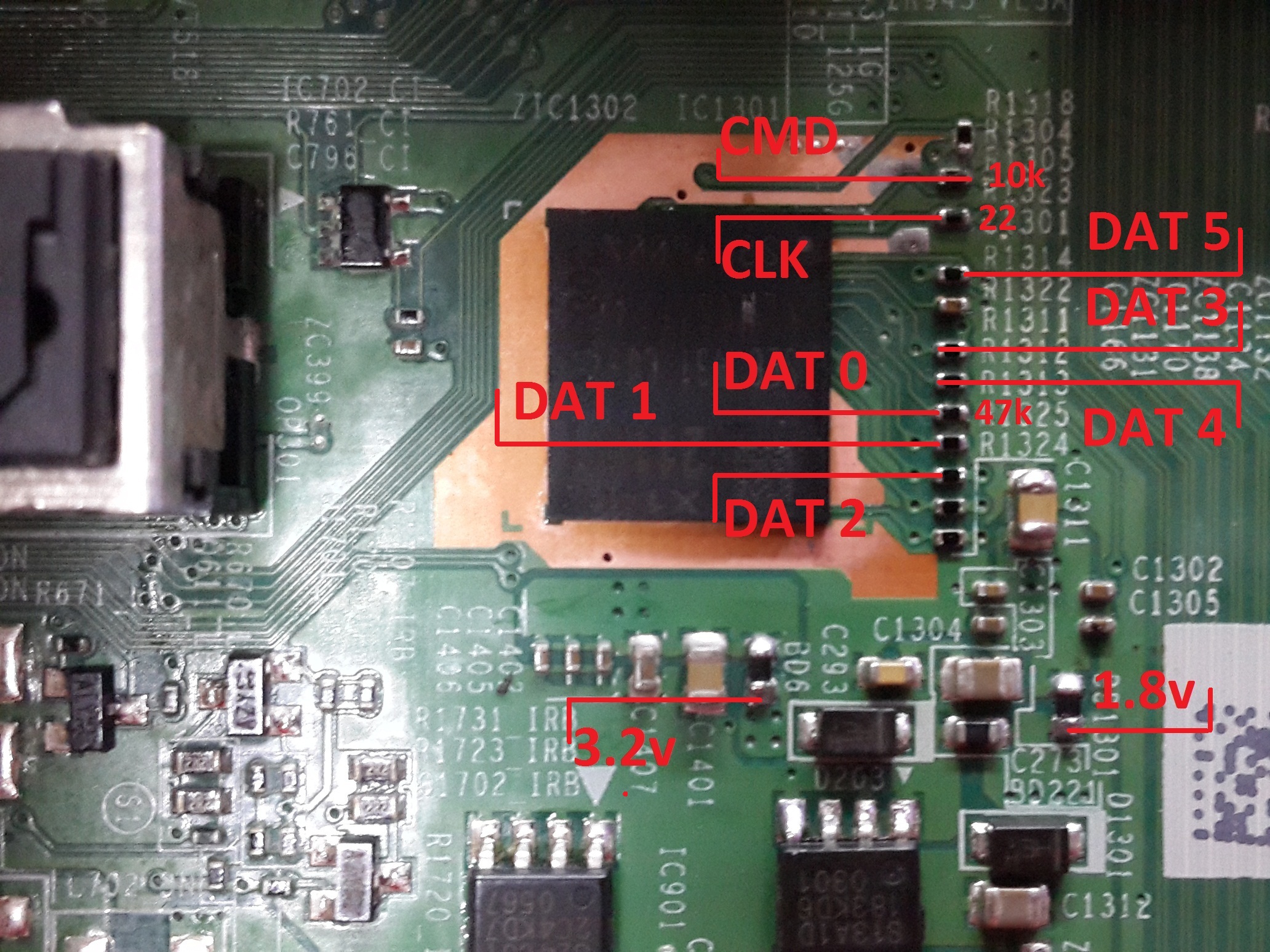

    Please help. I need this dump. The TV only writes Smart TV and it doesn't work...

    you dontn need dump ... is a nand flash problem

    EMMC It must be programmed.

    CHEK EMMC FLASH

    Thank you so much I'm fix it
