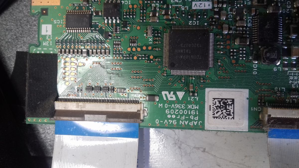

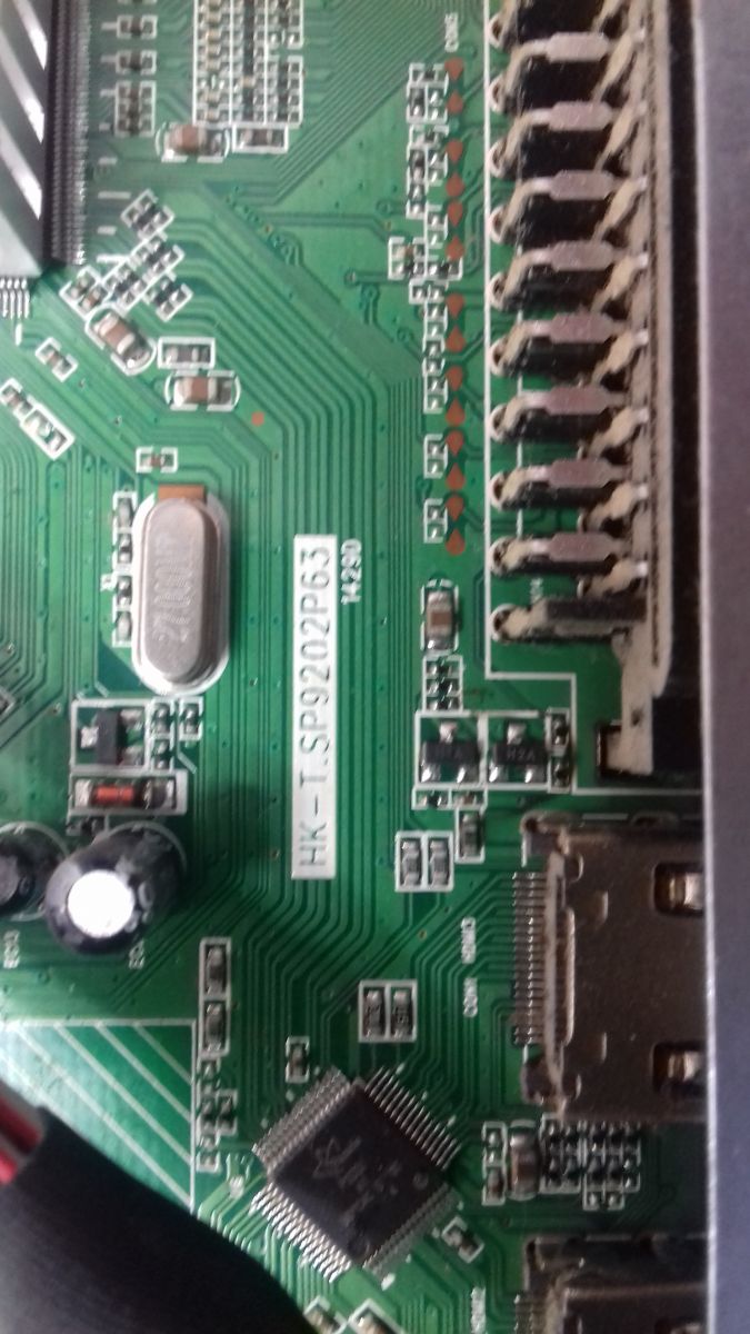

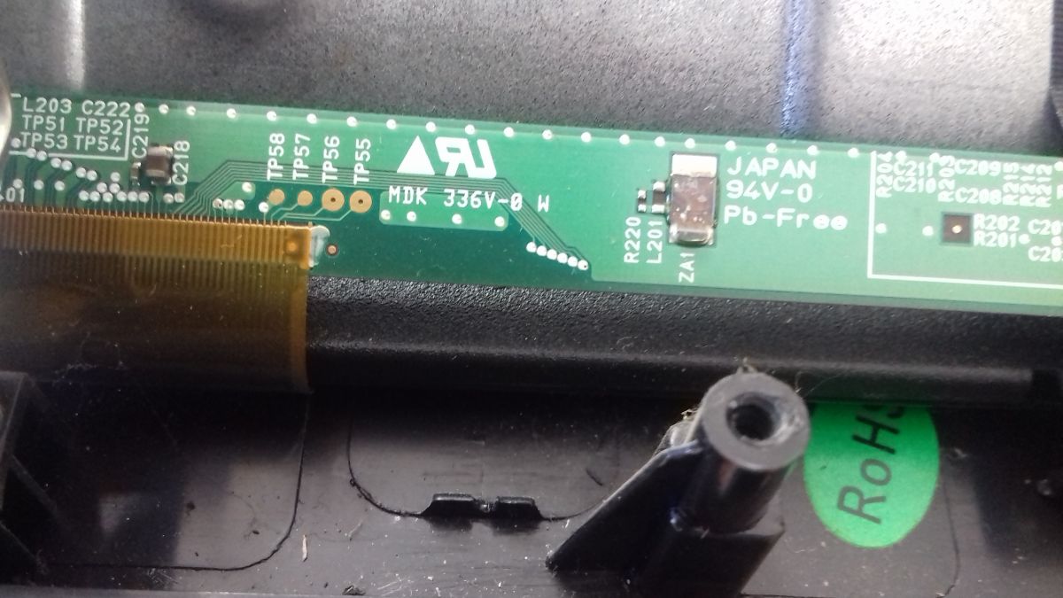

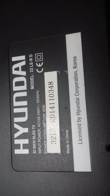

    Hi !! This TV not starting, looking for dump Searching for Hyundai 32LE-RD TV Firmware: TV Not Starting, Need Dump Files & Guidance Searching for Hyundai 32LE-RD TV Firmware: TV Not Starting, Need Dump Files & Guidance Searching for Hyundai 32LE-RD TV Firmware: TV Not Starting, Need Dump Files & Guidance Searching for Hyundai 32LE-RD TV Firmware: TV Not Starting, Need Dump Files & Guidance Searching for Hyundai 32LE-RD TV Firmware: TV Not Starting, Need Dump Files & Guidance

    jordanco
    show native dump (not working)
    #4 19212866
    jeloi
    Posts: 1745
    Help: 285
    Rate: 597
    Post the defective dump for analysis.
