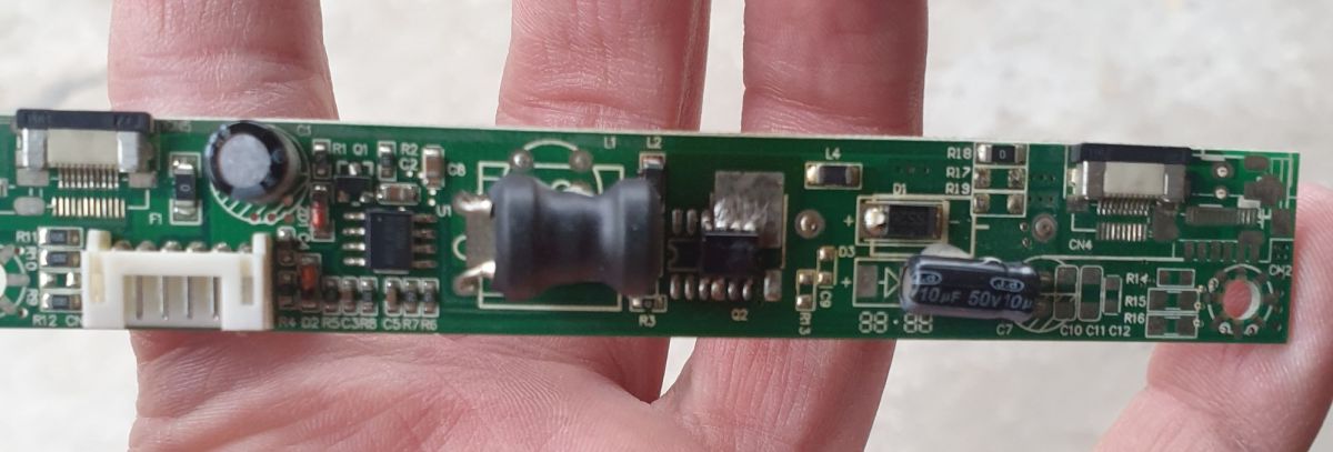

Vivax 22le31 - Led inverter failure burn IC need indentification
Zeka1975 3933 4
  • #1 19209209
    Zeka1975

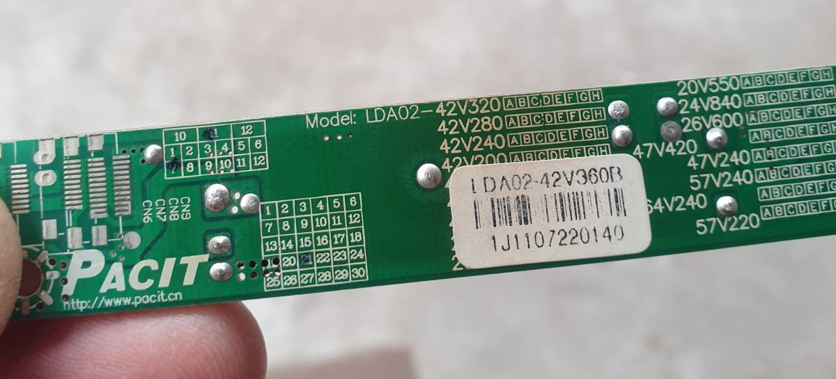

    Vivax TV 22le31 Awaria falownika LED spalić IC wymaga identyfikacji
    Pacit.cn LDA02-42v360b D
    Vivax 22le31 - Led inverter failure burn IC need indentification Vivax 22le31 - Led inverter failure burn IC need indentification Vivax 22le31 - Led inverter failure burn IC need indentification dzięki
    Vivax TV 22le31 Led inverter failure burn IC need identification
    Thanks

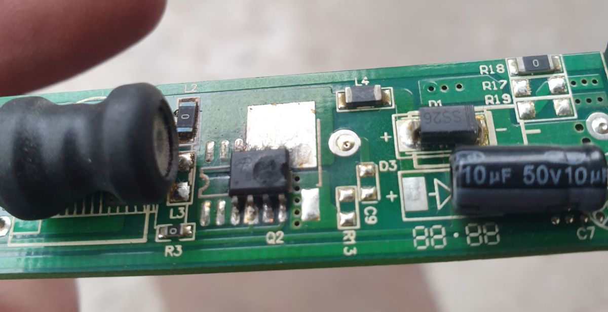

  • #2 19456558
    gerard_mensoifettoi
    Hi Zeka1975
    I have also issue with this LDA02-42V320 inverter board
    For your request, your burned CI is a AO4828 (60V Dual N-Channel MOSFET) => Alpha & Omega Brand

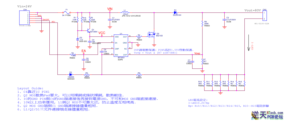

    Many thanks for this information. I don't find any schematic of this board
    Regards
    GM
  • #5 19462486
    lisek
    Service technician RTV
    Posts: 39910
    Help: 6339
    Rate: 6860

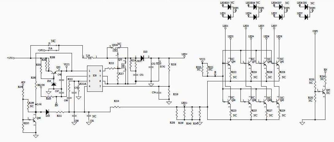

    There is such a shematic
    * Link Vivax 22le31 - Led inverter failure burn IC need indentification
