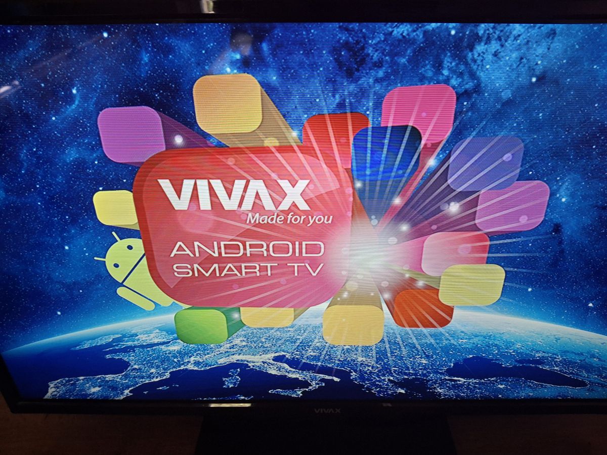

  • #4 21100569
    a063910573g
    Start screen of Vivax Android Smart TV with a colorful background.
    I just have this picture on my screen and it won't
    go online
  • #5 21100986
    waldi58
    Posts: 961
    Help: 66
    Rate: 252
    Include a photo with the serial number and a photo of the white sticker on the main pcb
