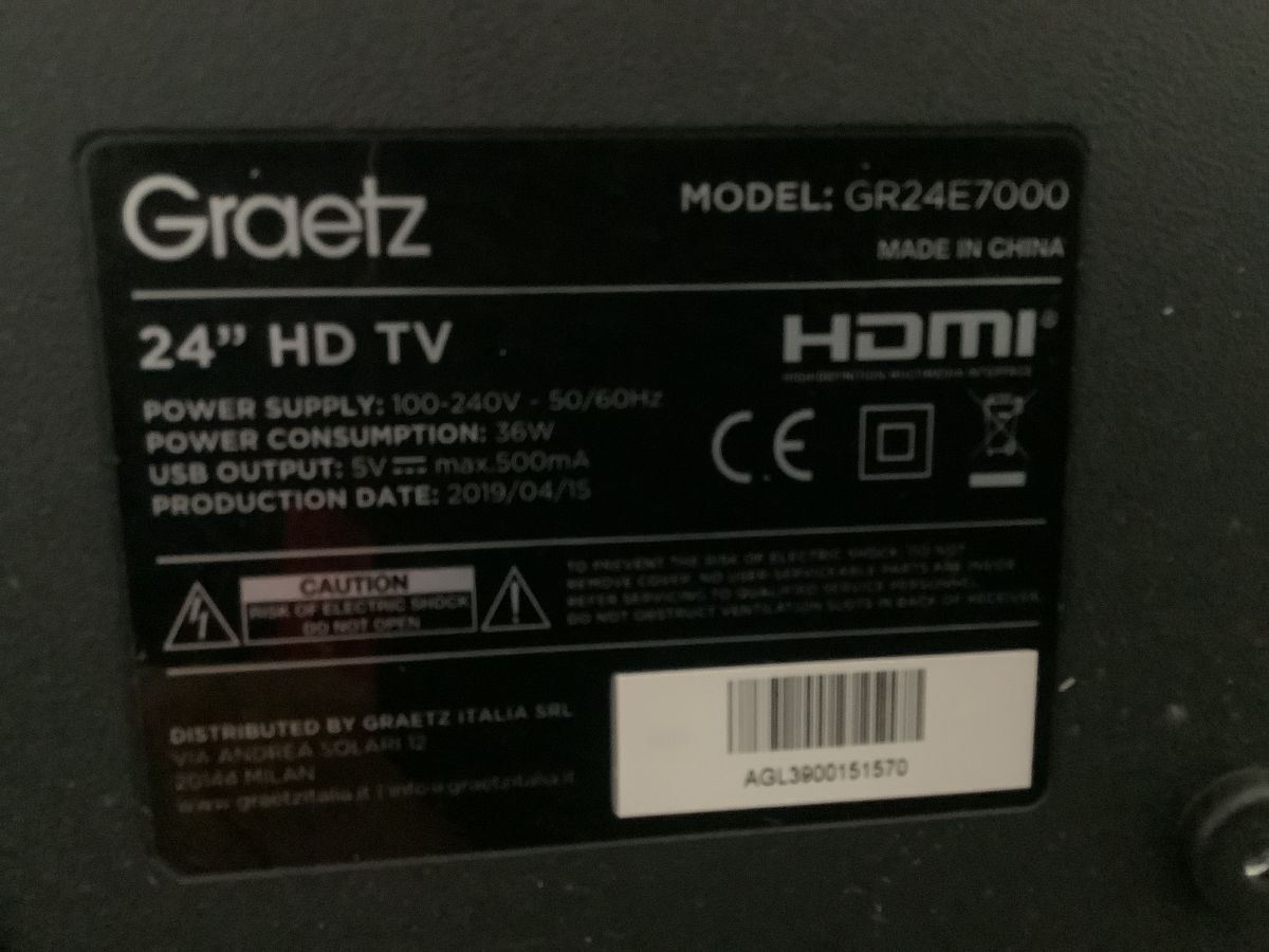

    Hi everybody nice to meet you, can you help me? I’m looking for a dump, thanks.
    Graetz
    Model 24hd tv
    Main board TP.MS3663S.PA671
    Panel V236BJ1-P01CB
    Spy 25q64
    Only standby

    post a photo of the sticker on the back of the tv
    with model, serial number, etc etc

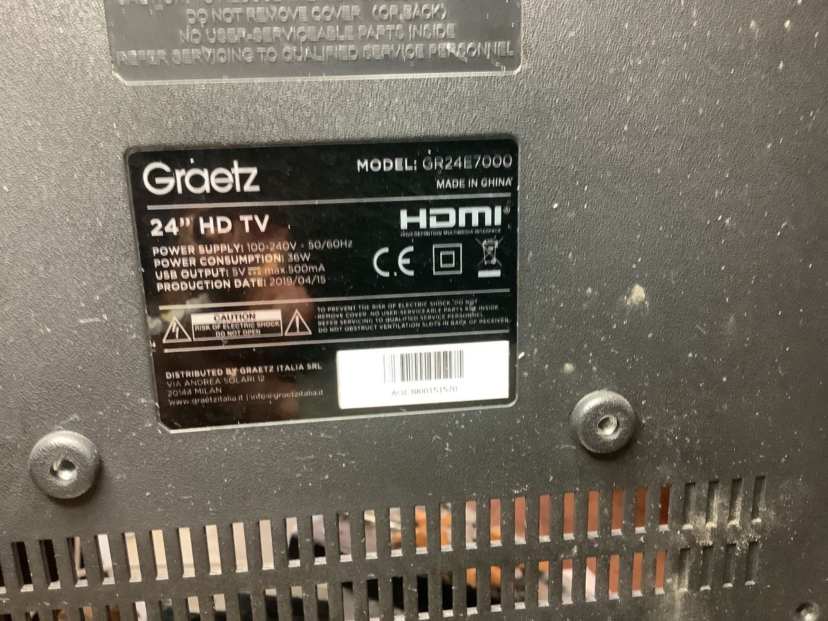

    Seeking Dump for Graetz 24HD TV, Main Board TP.MS3663S.PA671, Panel V236BJ1-P01CB, SPY 25Q64
    This is better

    write the spiflash UF1 with this bin file
    better if you use a new spiflash
    • GR24E7000_AGL390015.zip (4.77 MB) You must be logged in to download this attachment.
    It works, thanks again

    After programs the spy I solve the problem.
