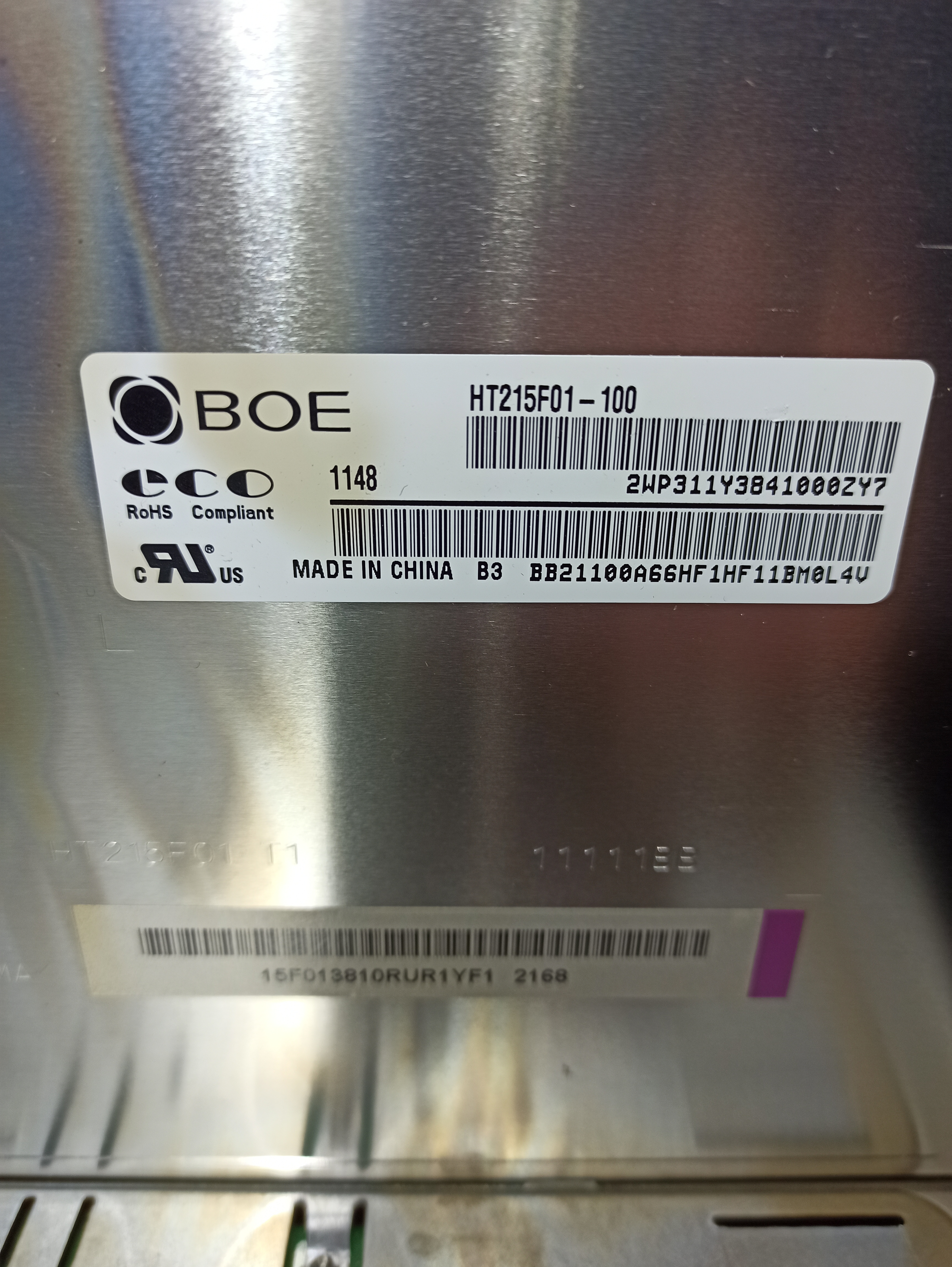

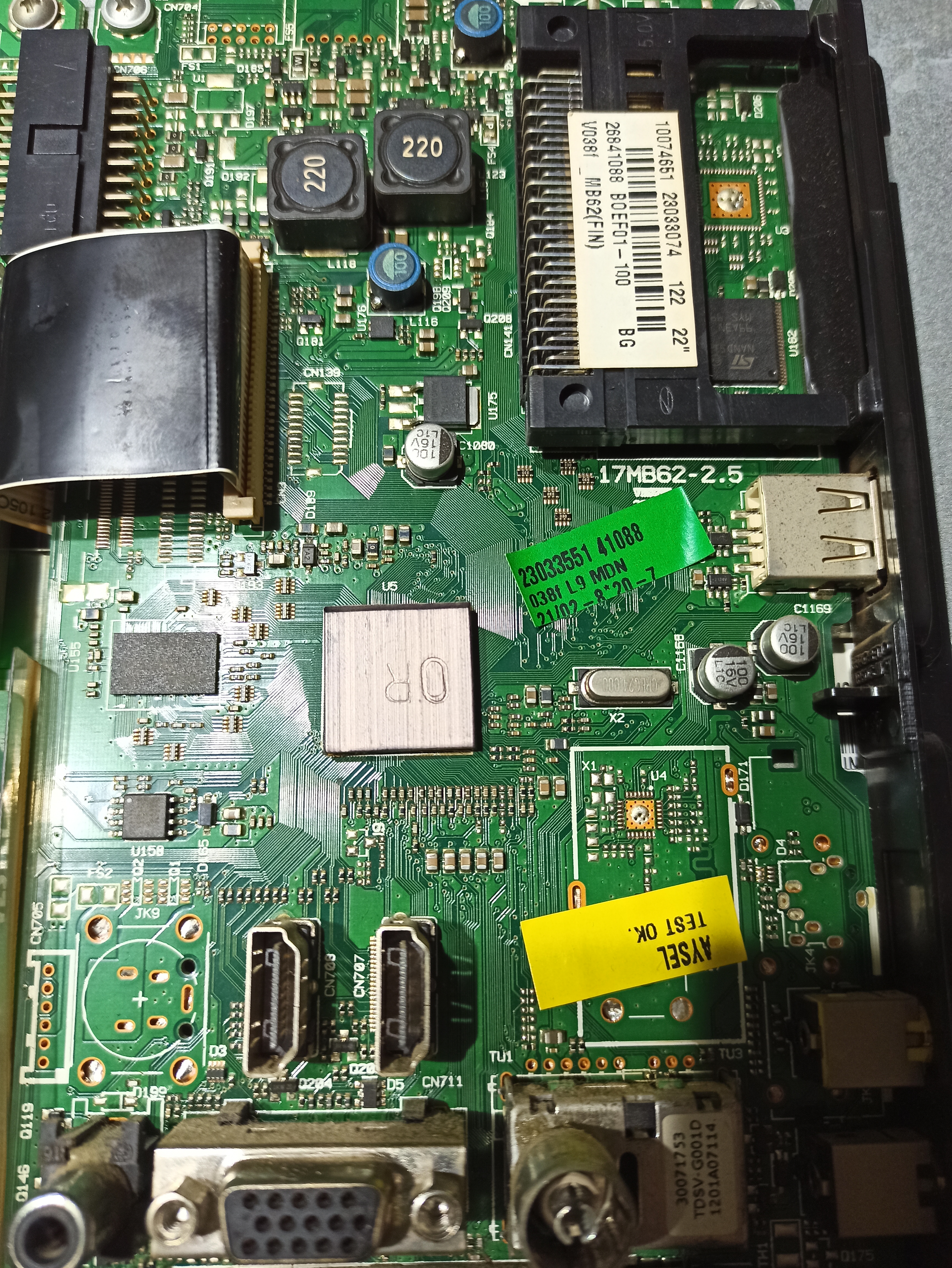

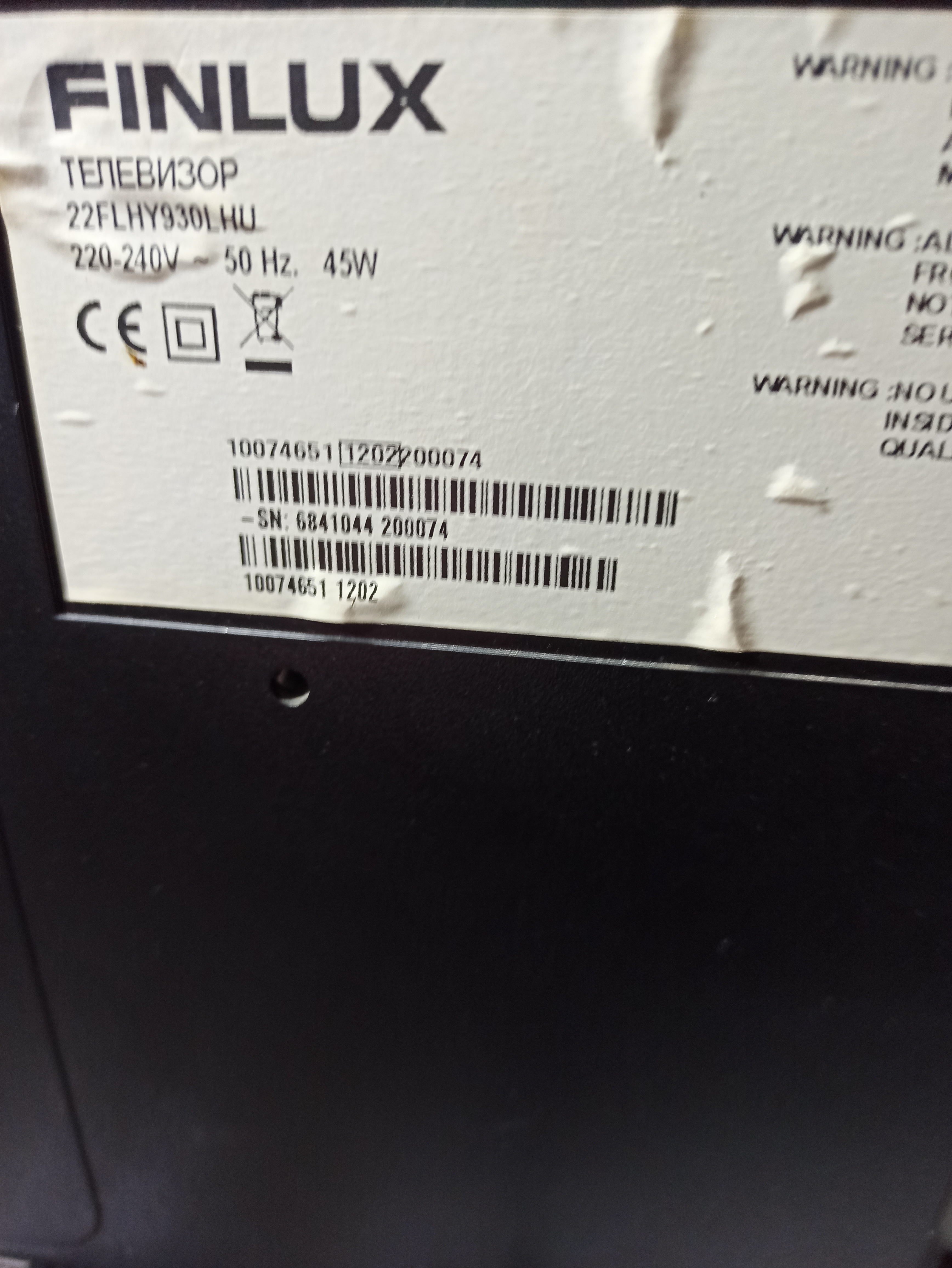

    Colleagues, I will ask you if you have software for this TV. Thanks
    • FINLUX 22FLHY930LHU TV: Seeking Software - Any Available Recommendations? IMG_20220420_185257.jpg (7.07 MB) You must be logged in to download this attachment.
    • FINLUX 22FLHY930LHU TV: Seeking Software - Any Available Recommendations? IMG_20220420_182424.jpg (4.54 MB) You must be logged in to download this attachment.
    • FINLUX 22FLHY930LHU TV: Seeking Software - Any Available Recommendations? IMG_20220418_191808.jpg (4.17 MB) You must be logged in to download this attachment.

    main 17MB62-2.5
    tuner TDSV-G001D
    panel BOE HT215F01-100
    • MB62_OEM_V075e.zip (18.34 MB) You must be logged in to download this attachment.

    I installed it
    and has a white picture
    does not show anything else ???

    Did not work at all,
    and before Led blinken
    Before you give me your Software I put this Software and present the same problem white screen !!!
    • MB62_vestel_mitsai_22vlm12_17mb62-2.6_17ip61-2.zip (18.91 MB) You must be logged in to download this attachment.

    I want to inform you that the TV was corrected.
    As I told you, I did the software installation and had a white image. I left it so operating, and some time later, the menu with the languages came up. Then I made a channel scheduling, and now the TV is working properly.
