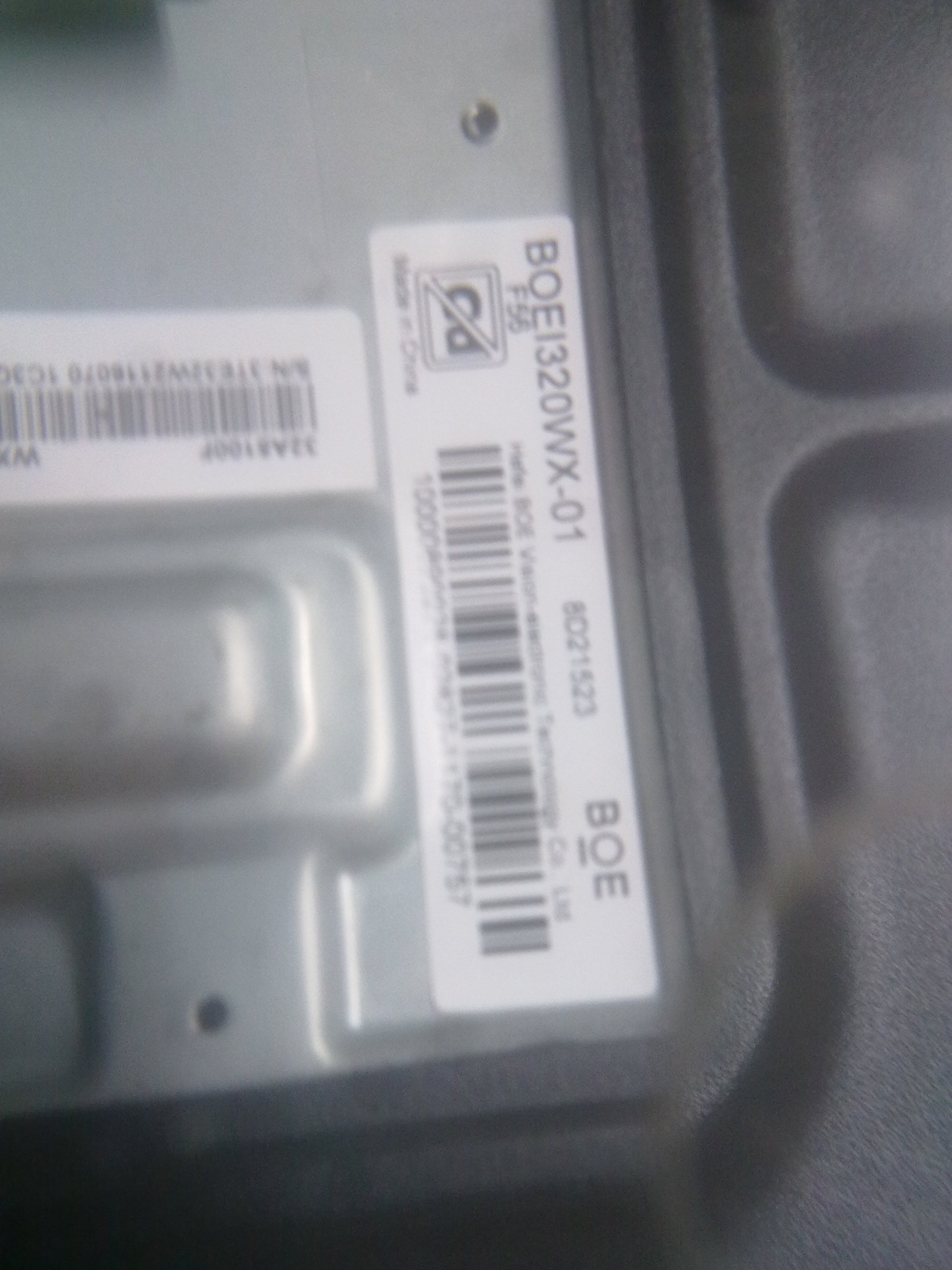

    mdaa
    Posts: 87
    marca hisense
    modelo 32a5100f
    main tp.3663t.pb708
    painel boei 320wx-01
    precisava arquivo flash

    are you sure about the panel code? post a photo of the sticker

    mdaa
    Posts: 87
    envio foto

  • #4 21013867
    billobirillo
    Posts: 1122
    Help: 336
    Rate: 780
    it's strange
    all versions of this model come out with panel JHD315...
