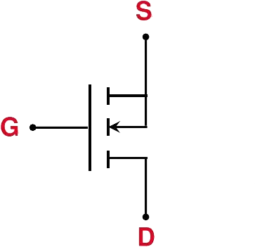

    Today, let's explain MOSFETs in the simplest way possible.
    How to Identify the Three Terminals:
    We know that MOSFETs have three terminals:
    Diagram of a MOSFET transistor with labeled terminals: gate (G), source (S), and drain (D).
    1. **Gate (G)**: The gate is the easiest to identify.
    2. **Source (S)**: Whether it's a P-channel or an N-channel MOSFET, the intersecting lines indicate the source terminal.
    3. **Drain (D)**: Regardless of the channel type, the side with the single lead is the drain terminal.
    These three terminals are used to connect the external circuit.
    G (Gate): Controls the MOSFET by changing the voltage level, which directly turns the MOSFET on or off.
    D (Drain) and S (Source): These terminals function as the two ends of the switch circuit, one connected to the power supply and the other to ground.

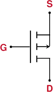

    How to Distinguish Between N-channel and P-channel:
    It’s quite simple, just look at the symbol:
    If the arrow points away from the gate, it's a P-channel MOSFET.
    Diagram of a MOSFET symbol with labels for gate, source, and drain.
    If the arrow points toward the gate, it's an N-channel MOSFET.
    N-channel MOSFET symbol with labels: G (Gate), S (Source), D (Drain).

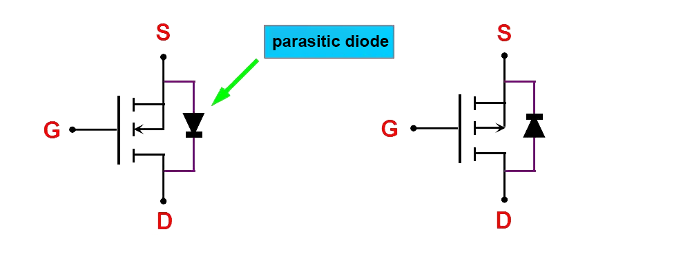

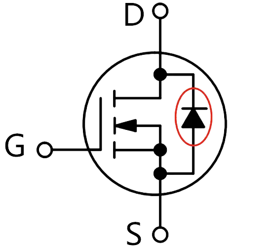

    Direction of the Parasitic Diode:
    If the arrow of the parasitic diode points from the source to the drain, it's an N-channel MOSFET.
    If the arrow points from the drain to the source, it's a P-channel MOSFET.
    Diagrams of P-channel and N-channel MOSFET symbols Diagram of a MOSFET symbol with three terminals and a marked parasitic diode.
    This parasitic diode plays a crucial role in circuit isolation. It helps in over-voltage protection by conducting excess current to the ground, preventing MOSFET damage. It also protects the MOSFET when the source and drain are reversed or when reverse-induced voltage occurs in the circuit.
