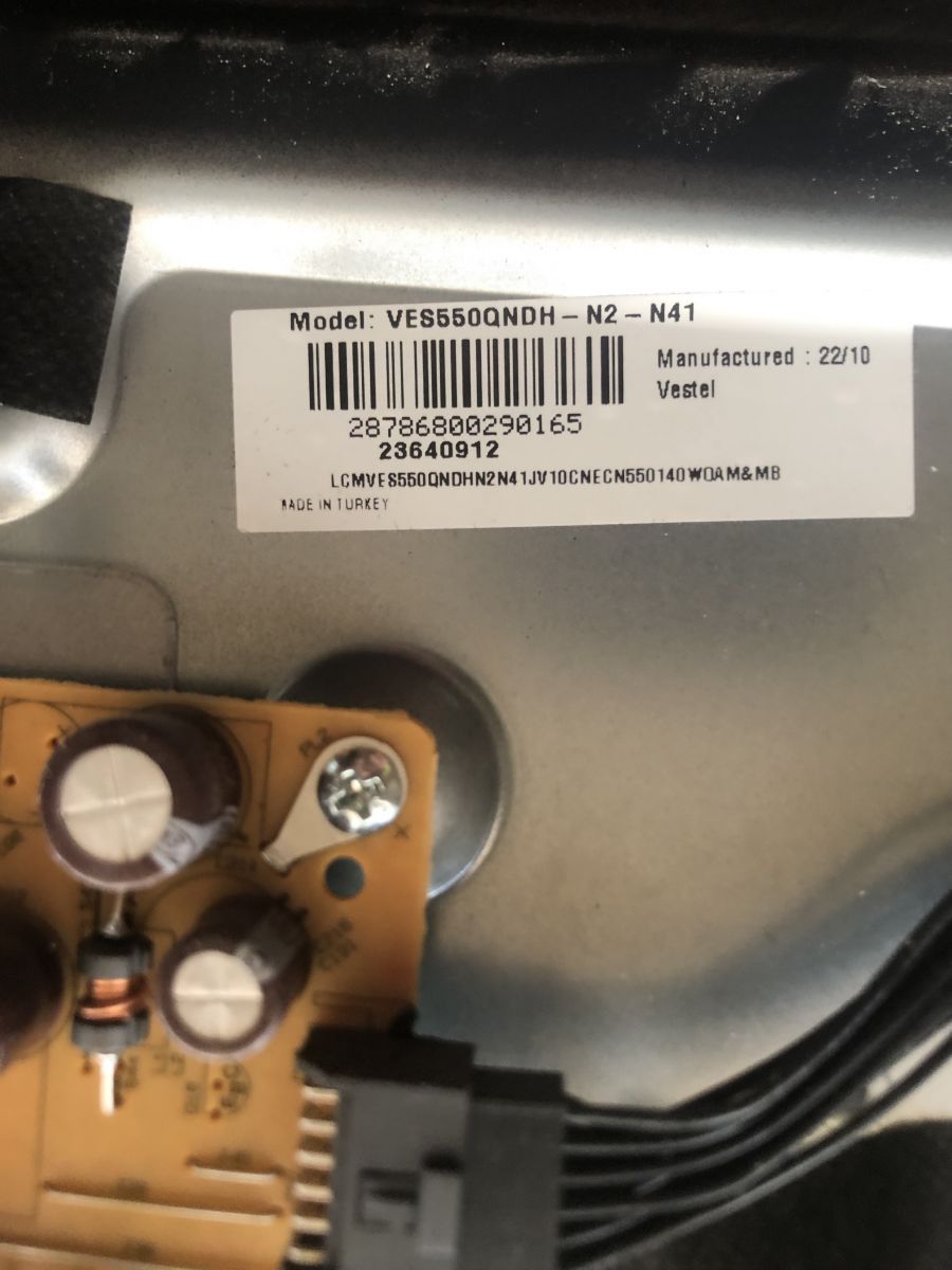

    Hi I need firmware for MAIN BOARD 17MB170, IS A TOSHIBA 55UA2B63DG TV WITH PANEL VES550QNDH,
    Sticker with model and serial number on the TV panel VES550QNDH. thank you
    AI: Are you experiencing any specific issues with your TV that require a firmware update, or are you looking to update for other reasons?
    Wrong panel firmware, picture are duplicated

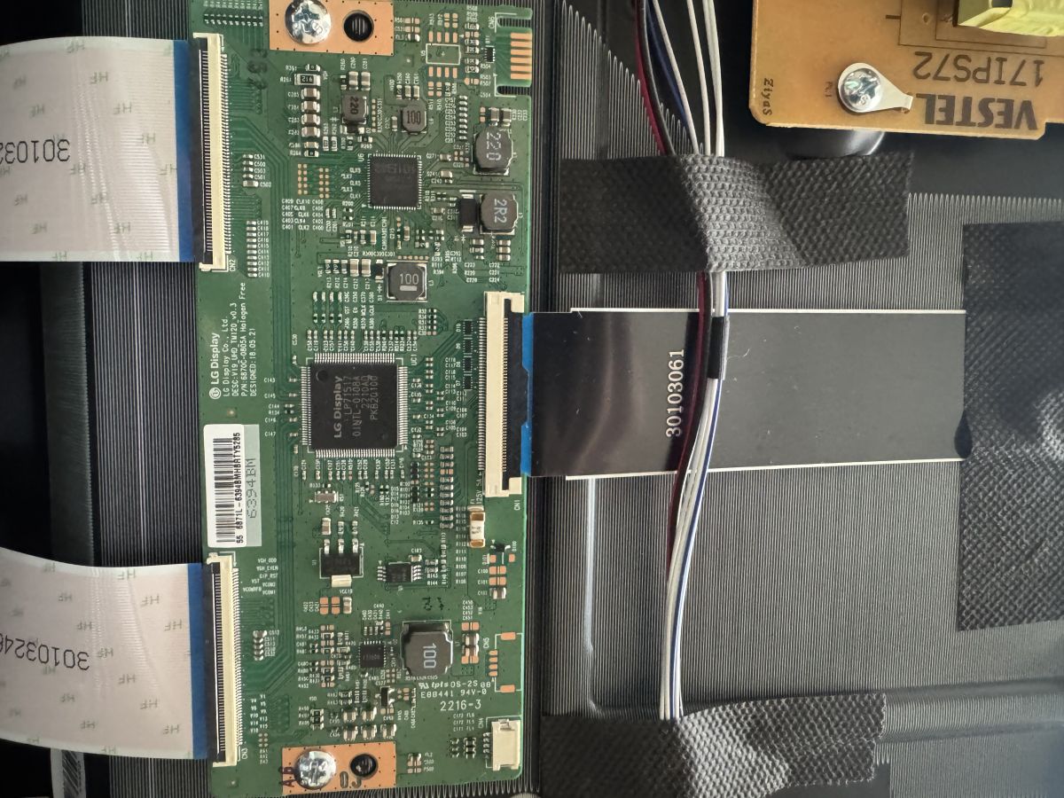

  • #8 21624095
    mahmodmnjuna1977
    Hi,
    I’ve checked my TV and took a photo of the T-CON board.
    It’s not the HKC PT550GT01-1 V1.0 – mine is an LG Display board with the following code:
    EAX69087703 (1.0) / 6934TM
    Please check the attached photo to confirm compatibility.
    Thanks!
    LG Display T-CON board EAX69087703 (1.0) with ribbon cables and connectors
  • #9 21625493
    billobirillo
    Posts: 1110
    Help: 333
    Rate: 768
    on mainboard 17MB170, the software is based on the tcon module, not on the panel code (VES550...)
    here is the software from a JVC link
    same mainboard 17MB170
    same remote control
    and same tcon LG 6871L-6394B LC550EQQ-SMA4

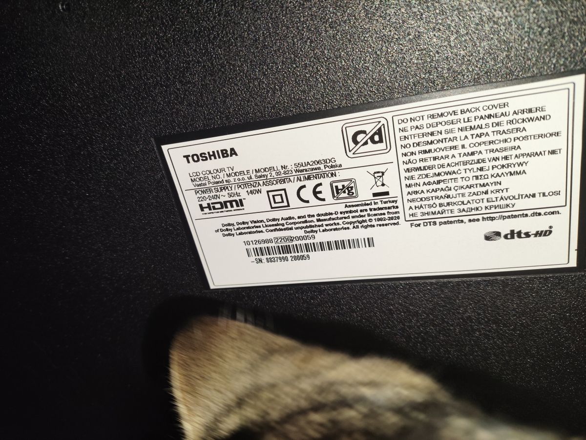

  • #13 21736190
    wolfidis
    >>21736000
    I tried to perform a reset using a USB stick formatted to FAT32 (I created a folder named 'upgrade' containing the file reset.pkg), but it doesn't proceed. It's completely stuck. How can I find out which panel my TV has?

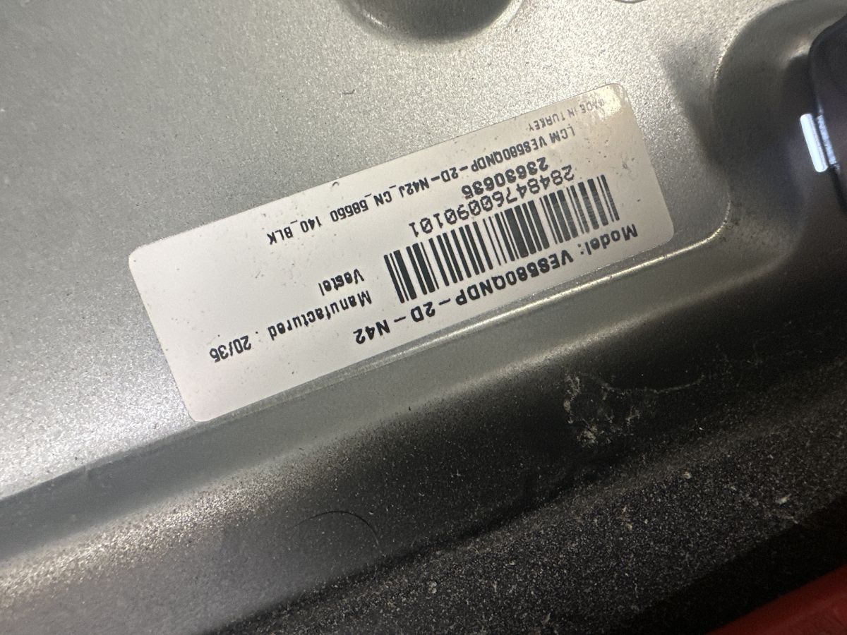

    mikeyrolo
    Hi, thanks for allowing me to join. I am desperate for the firmware for 17MB170. Could you send a link, please? Thanks in advance.
    Barcode label on a metal housing, showing model VES580NDP-2D-N42
  • #26 21858724
    billobirillo
    Posts: 1110
    Help: 333
    Rate: 768
    model and serial number of the tv
