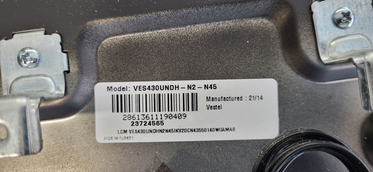

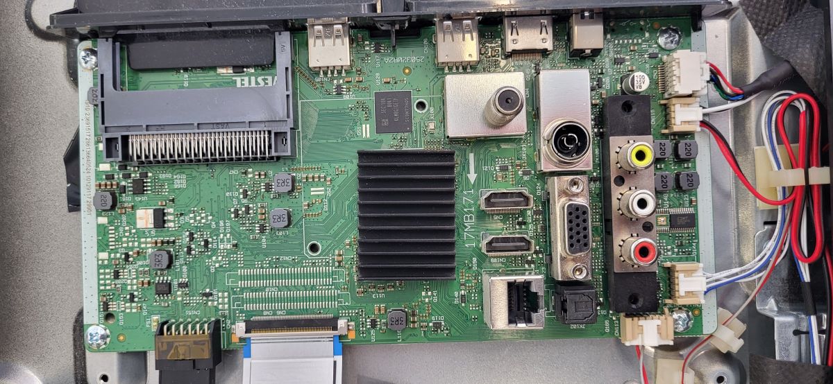

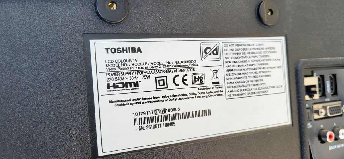

    Hi everybody!
    Looking for the firmware of this Toshiba 43la2063dg with 17mb171 main, due to the usual problem of these android TVs of the error that appears very fast
    "Storage space running out"
    Thanks in advance guys!
    TV mainboard with HDMI, USB, VGA, RCA connectors and various input/output ports.
    Label with model and serial number for Vestel VES430UNDH-N2-N45 electronic component.
    Nameplate of Toshiba TV model 43LA2063DG with technical information and warning labels.

  • #2 21575358
    billobirillo
    Posts: 1141
    Help: 338
    Rate: 793
    for TOSHIBA 43LA2063DG
    main 17MB171 panel VES430UNDH-N2-N45
    download the usb recovery file here link
    link expires in 7 days
    copy the file upgrade_no_tvcertificate.pkg on an empty usb stick
    insert the usb stick in the tv
    then plug the power cord: the recovery will start sutomatically

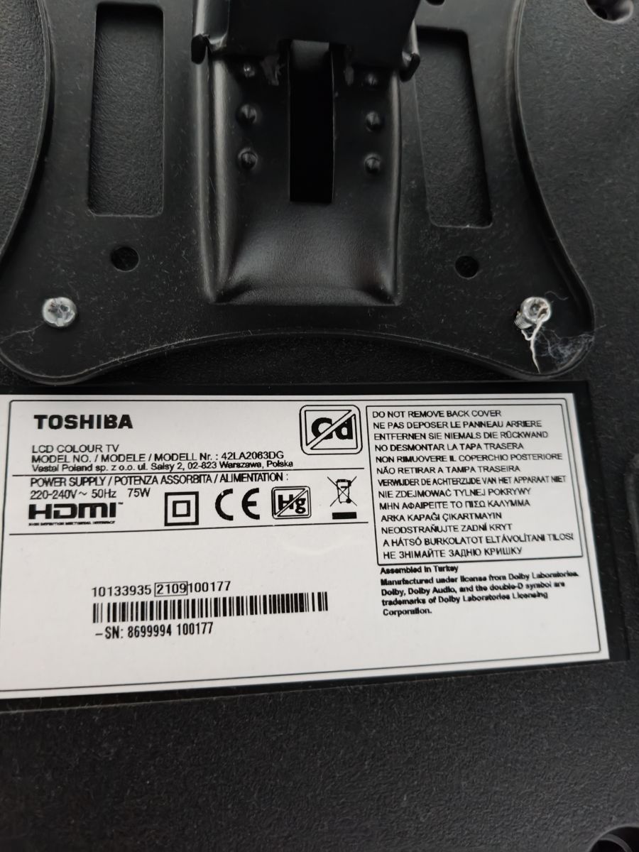

    Hi everybody!
    Looking for the firmware of this Toshiba 42LA2063DG. I have the same problem: "Storage space running out"
    Thanks in advance
    Label on the back of a Toshiba TV showing model number 42LA2063DG
  • #14 21852126
    yokoono51
    Posts: 804
    Help: 168
    Rate: 309
    Toshiba 42LA2063DG main 17MB171 panel VES415UNDR-N1-N41 ?????.
  • #15 21852271
    afasiass
    >>21852126
    The main is 17MB171, but I don't know what panel it is.
  • #16 21852541
    billobirillo
    Posts: 1141
    Help: 338
    Rate: 793
    @afasiass
    model TOSHIBA 42LA2063DG s/n 28699994
    main 17MB171
    panel VES415UNDR-N1-N41 cell JE415D3HA0L
    software link
    link valid for 7 days

    afasiass
    >>21852541
    Thank you very much, works perfectly 👌
