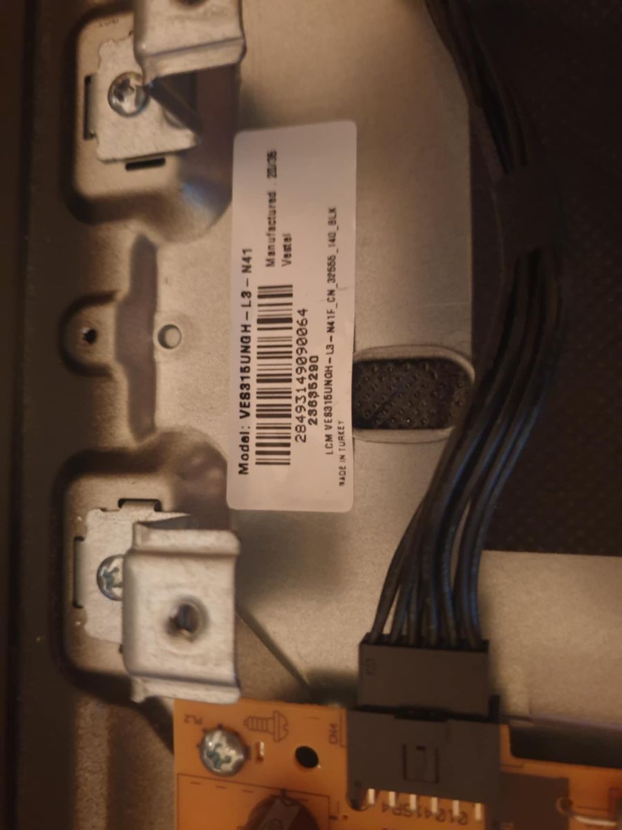

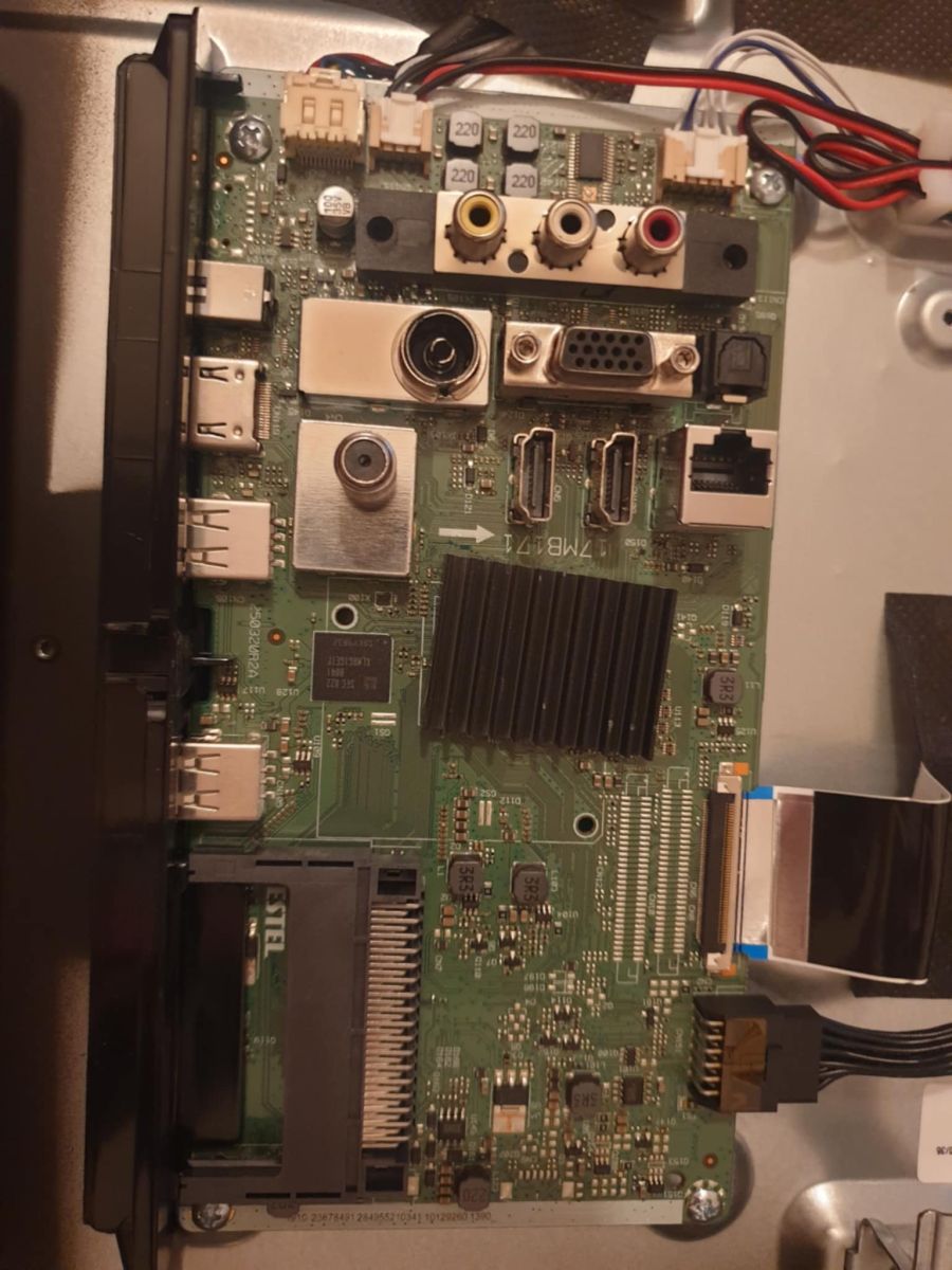

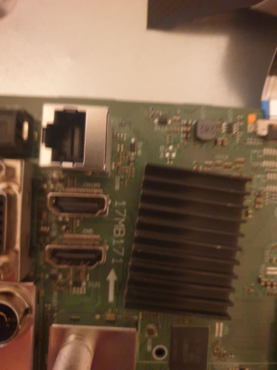

    mainboard and panel code
    mainboard should be a 17MB171
    open the tv and post a photo of the panel label, the code starts with VES315

    I think the panel is VES315UNGB-L3-N52

    here is a software from a TOSHIBA 32LA2063DG Link
    same main 17MB171, same panel VES315UNGH-L3-N41 (PT320CT01-1 V1.2) and same remote control R/C45157 as F&U FLA3221H
    copy the file upgrade_no_tvcertificate.pkg on an empty usb stick
    insert the usb stick in the tv
    then plug the power cord: the recovery will start automatically
