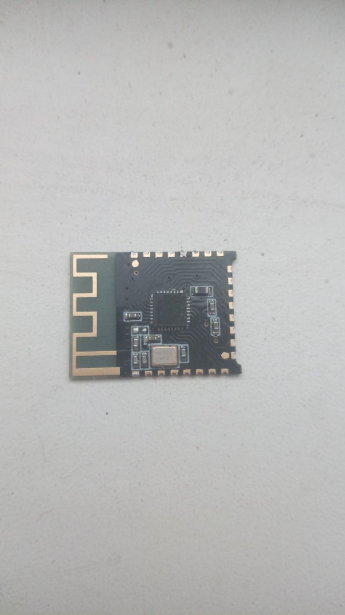

    ivan23654623 wrote:
    I have a bk3432 chip and I want to flash it via spi, it is flashed the same way as bk7231, the initialization sequence is the same?
    https://obrazki.elektroda.pl/2811169200_1753109129.jpg @elektro...

    No – the BK3432 cannot be flashed with the BK7231 “external SPI” initialisation sequence.
    Use one of the two officially documented paths instead:
    1. SWD (preferred for development, supports full debug).
    2. UART ROM download mode (sufficient for mass-programming if you do not need single-step debug).
    FT232H is ideal for both (it can speak SWD via OpenOCD or plain UART at 1.5 Mbaud).
    The CH341A is *only* useful for the UART method; it has no reliable SWD support and its SPI features are irrelevant with the BK3432.

    • SWDIO, SWCLK, nRESET are present on almost every module but are often not brought to castellated pads; you may have to bodge thin wires to the IC pins.

    The BK3432’s firmware resides in on-chip flash. Therefore the BK7231 external-SPI flashing sequence does not apply.
    Use SWD (best for development) or the ROM UART “download” mode (best for production). An FT232H can do both; a CH341A can only do the UART method and is unsuitable for SWD.
    Questions for the user
    1. Do you already have access to the SWD pads on your module, or do we need to devise a non-intrusive pogo-pin fixture?
    2. Which BLE stack (Beken, NimBLE, Zephyr) are you planning to run? Knowing that will help tailor linker scripts and flash partitioning.
