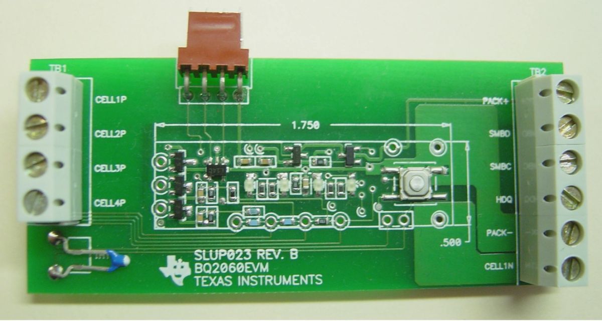

    I am looking for a PCB drawing for this device. I only found version A, but I am interested in this one. Or a finished module. Thank you all for your help
    Texas Instruments SLUP023 REV. B PCB with screw terminals and electronic components

    There you go, I have docotorized my self on bq2060. Should still have it somewhere device it self even.
    • bq2060b.pdf (697.53 KB) You must be logged in to download this attachment.
    • bq2060.pdf (253.42 KB) You must be logged in to download this attachment.

    Thank you, I found these links. I would need a drawing of the complete electronics board after revision, as the original picture sent, which I couldn't find anywhere. I want this board for experiments, to learn how to set up the BQ2060 and BQ2040 circuits, before I start working on the original battery and irreparably damage something there.
  • bq2060 uses PIC16xxx memory instead of 24c02

    I strongly advise against buying this, buy the electronics from the battery on bq2060 and test on this mostly very old HP had bq2060. There is no other revision it looks like this I know because I have bought it from TI. The problem with this device is that there is no physical 24c02 in it, it is moved to PIC16xxx memory where it is impossible to get it out and you can only export it as another file and then you need to convert and rewrite it bit by bit. You will definitely learn more from the pdf from the 2060.
