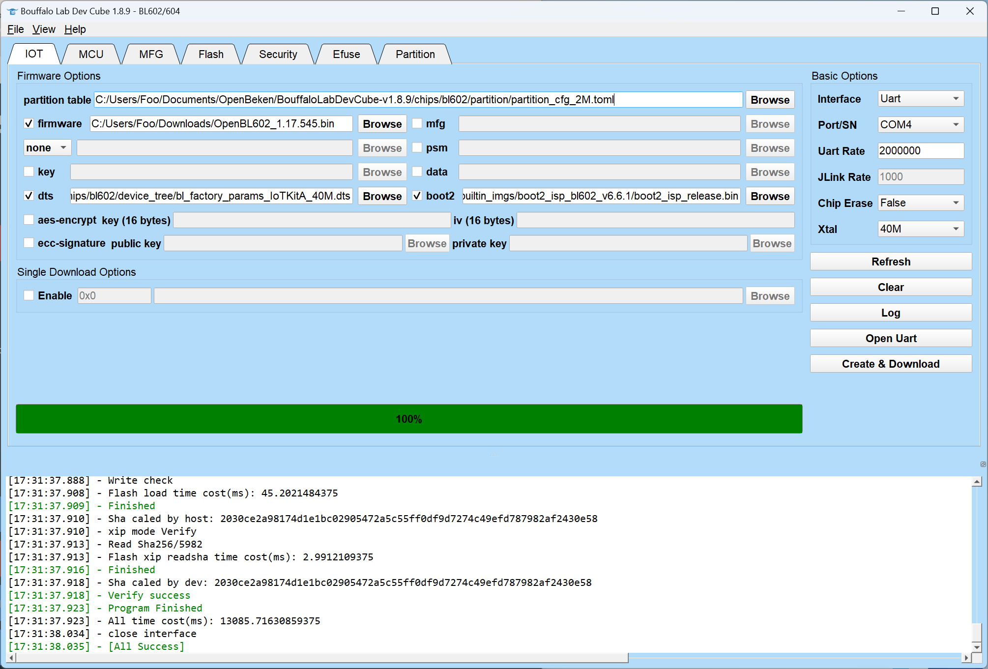

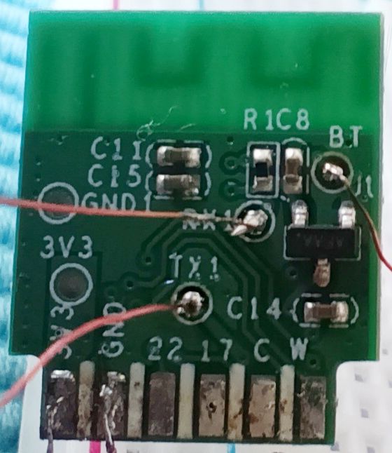

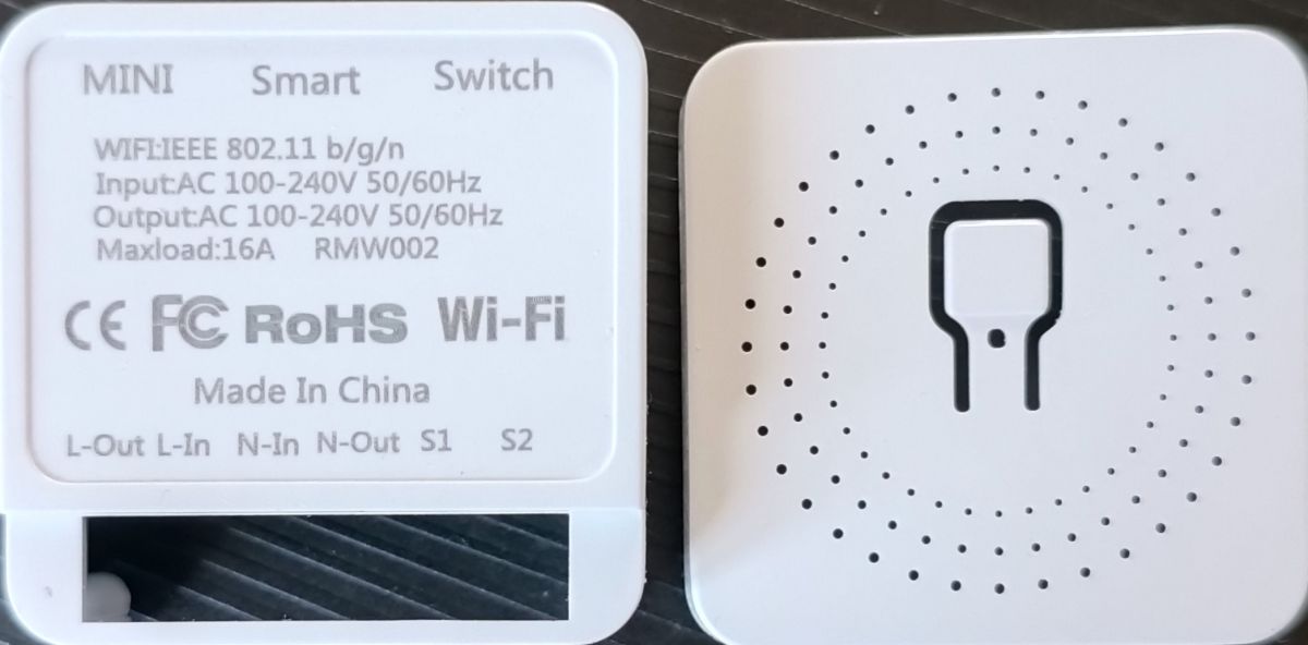

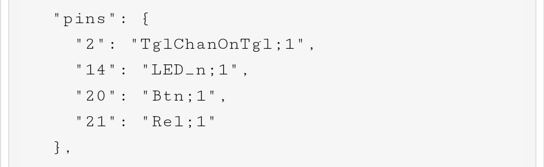

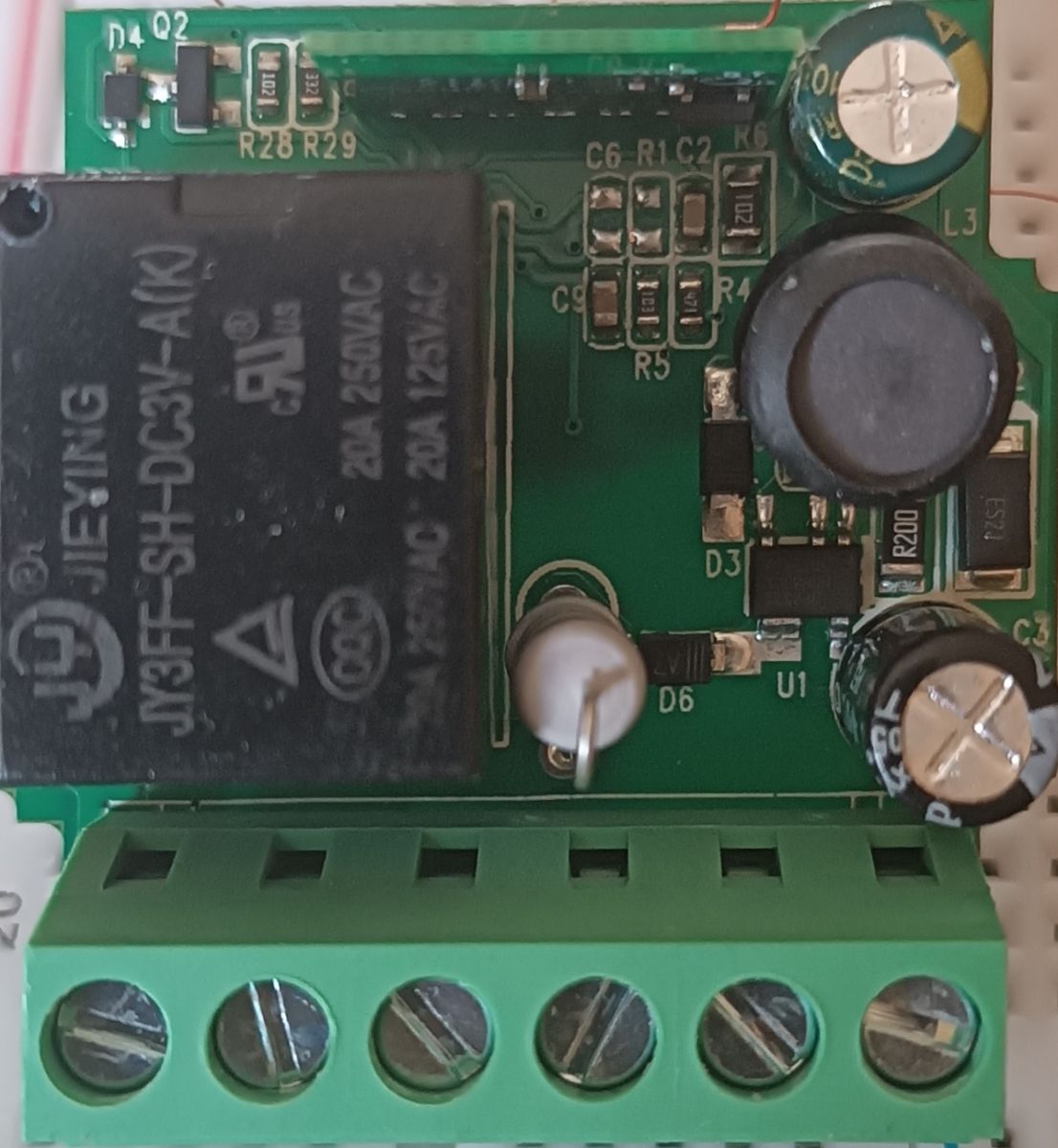

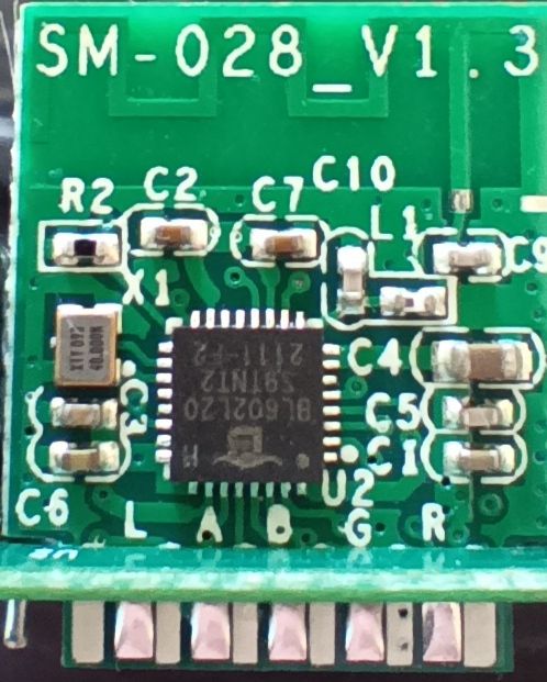

    The image shows a smart Wi-Fi switch with labels and technical specifications.
    Close-up of a green circuit board with electronic components such as resistors, capacitors, and a relay. Image of a green circuit board with markings RM-BRK001-MAC2HG and number 2349. Close-up of a green printed circuit board with electronic components.
    Close-up of a green electronic circuit board with soldered components. Screenshot of the Bouffalo Lab Dev Cube 1.8.9 user interface. JSON code snippet with pin configuration.
    How to bring this to the right place in this forum ?
  • #2 21080908
    Posts: 14767
    Rate: 12906
    Can you please post full template as JSON text (text in post, not image) so we can add it to our devices list: https://openbekeniot.github.io/webapp/devicesList.html
