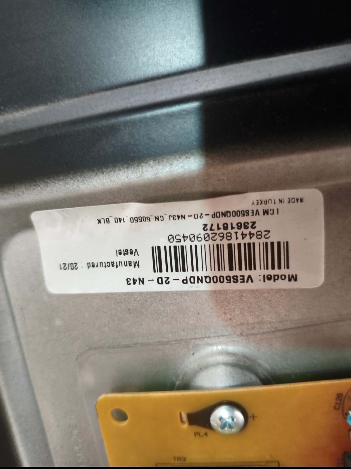

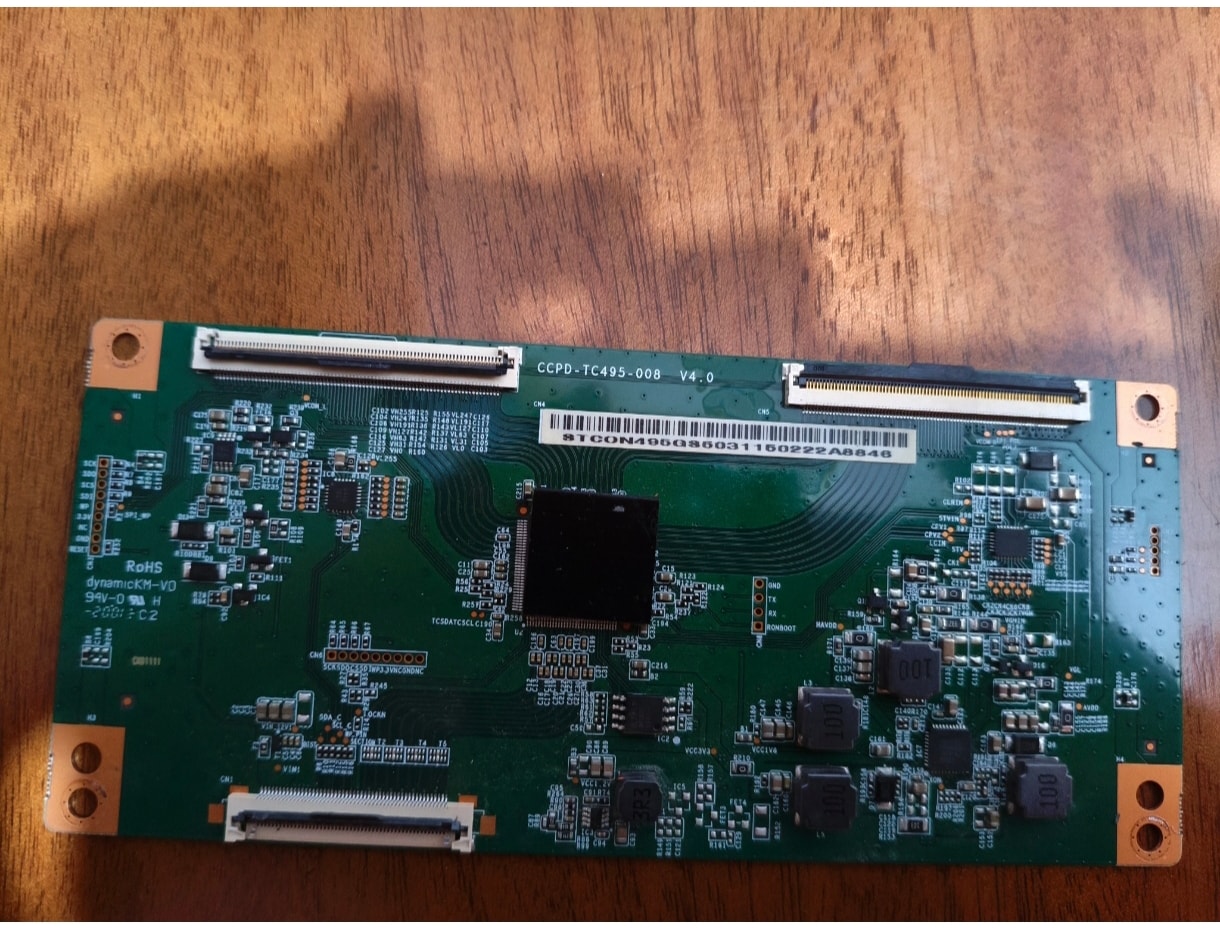

    post the photos of
    - the sticker on the back of the tv: serial number required
    - the tcon module

    Panel: VES500QNDS-2D-N13 or panel VES500QNDP-2D-N43 ???.
    Your colleague asked you for a picture of the label on the back cover.
  • #5 21647491
    blesirosi
    VES500QNDP-2D-N43 thenx

    usb full software link
    for main 17MB170 panel VES500QNDP-2D-N43 tcon CC500PV5D
    copy the file upgrade_no_tvcertificate.pkg on an empty usb stick
    insert the usb stick in the tv
    then plug the power cord: the recovery will start sutomatically
