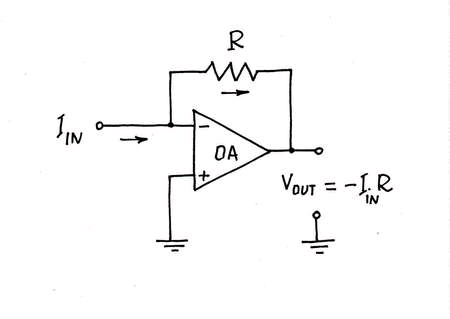

How can I measure peak current with about 100 MHz bandwidth, preferably as a voltage I can feed to a spectrum analyzer?
Use a very low-inductance current viewing resistor right at the IC, not a current probe or transformer, if you want to measure the current without disturbing the circuit too much [#21657616][#21657620] One practical implementation was a 1 ohm sense resistor made from paralleled 10 ohm PCB resistors, connected to the IC power pin through a very short 1 ohm transmission line, then taken out through an SMA connector and a 50 ohm series resistor to drive the oscilloscope directly [#21657616][#21657618] For higher-current parts like DRAM, a 0.1 ohm current viewing resistor was suggested [#21657618] The line/resistor geometry matters: keep source inductance and capacitance low, and use the PCB trace width/spacing appropriate for the low impedance line rather than a normal 50 ohm trace [#21657618] If the resistor’s inductance creates a zero, it can be compensated with a shunt capacitor at the SMA to form the matching pole [#21657618] A high-speed, high-current transimpedance amplifier is possible, but it was described as a much greater challenge than a low-inductance current viewing resistor [#21657620]

  • Need for wideband current-to-voltage measurement up to 1 GHz

The discussion focuses on methods for measuring peak current with high bandwidth, specifically targeting at least 100 MHz to 1 GHz for analyzing current frequency components in ICs, such as memory devices, to address regulatory testing failures. Two main approaches are considered: high side current sense circuits and transimpedance amplifiers, each with pros and cons. Off-the-shelf current probes like Tektronix CT1, CT2, and CT6 offer bandwidths up to 1 GHz but introduce inductance that can distort measurements. A low inductance, low resistance current sensing resistor placed very close to the IC power pins, combined with a wide, low impedance transmission line (e.g., a 1 ohm line much wider than a standard 50 ohm line), can provide more accurate real-time current measurement. The resistor output can be connected directly to an oscilloscope via a 50 ohm termination. Designing such a measurement setup requires careful consideration of parasitic inductance and capacitance, with compensation techniques like adding shunt capacitors to counteract inductive zeros. Difference amplifiers with less than unity gain compensation may offer high bandwidth but are challenging to implement stably at 100 MHz. Alternative suggestions include using a spectrum analyzer with a loop antenna to measure radiated emissions instead of direct current measurement. The key challenge remains achieving a low impedance, high bandwidth current sensing method without disturbing IC operation.
