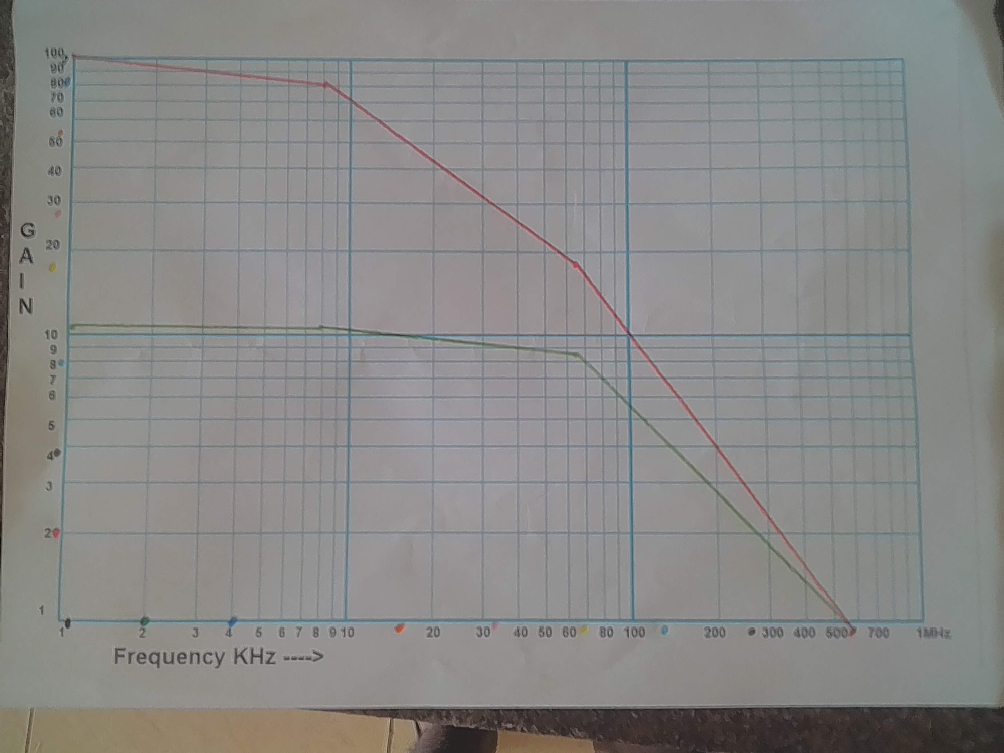

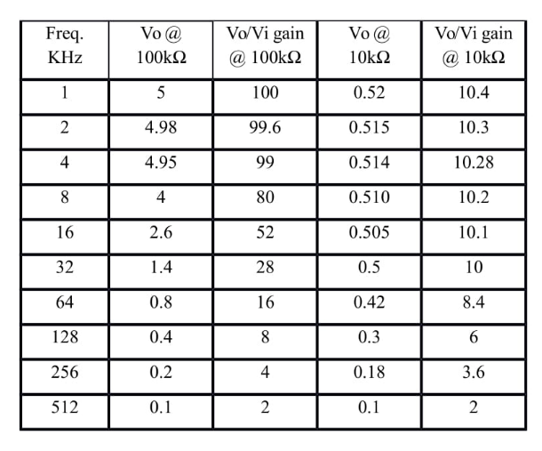

Hi please i wish to know if am drafting this graph in the right manner ?
291 22
How do I draw this graph correctly?
Your graph should be plotted as individual points first, then joined with a smooth curve of best fit, not straight line segments [#21679631][#21679637][#21679638] The points after 4 kHz were placed incorrectly in earlier versions, especially on the logarithmic frequency axis, so check that each value sits at the correct position before drawing the curve [#21679634][#21679637][#21679641] Do not force sharp corners where the response changes slope; the line should curve smoothly through the transition [#21679638][#21679641] For the cutoff frequency, mark the point where the response has dropped to about 0.7 times the gain at the corner where the two straight-line sections meet, and draw the curve through that point [#21679644]

  • Half-voltage point defines cutoff frequency
    #4 21679630
    Elizabeth Simon
  • Correct gain points and curve plotting needed

  • Need to plot all frequency points on the graph
    #8 21679634
    David Ashton

  • Points plotted at wrong frequencies above 4 kHz
    #11 21679637
    David Ashton
  • #12 21679638
    Elizabeth Simon

  • Correcting log graph points and curve shape
    #15 21679641
    David Ashton

  • Suggesting gain and phase measurements across frequency
    #20 21679646
    PeterTraneus Anderson

  • #23 21679649
The discussion centers on correctly drafting frequency response graphs for electronic circuits, specifically plotting gain versus frequency for different load resistances (10K and 100K ohms). Key issues addressed include accurate placement of data points on logarithmic frequency scales, proper representation of gain values at specified frequencies, and the importance of plotting points before drawing smooth curves rather than connecting points with straight lines. The concept of cutoff frequency is clarified as the frequency where the output voltage drops to approximately 70% (or -3 dB) of its low-frequency value, with references to Wikipedia articles on cutoff frequency and decibels. Participants emphasize simulating or measuring gain at multiple frequencies to obtain detailed data points, then plotting these points accurately on the graph. The need to create smooth curves that reflect the actual frequency response, avoiding sharp corners, is highlighted. Suggestions include using graph paper with logarithmic scales, marking points precisely, and understanding terms like closed-loop gain, open-loop gain, and loop gain. Tutorials and example graphs are recommended to improve graphing technique. The overall goal is to produce clear, accurate frequency response plots that correctly identify cutoff frequencies and reflect the circuit’s behavior under different loading conditions.
