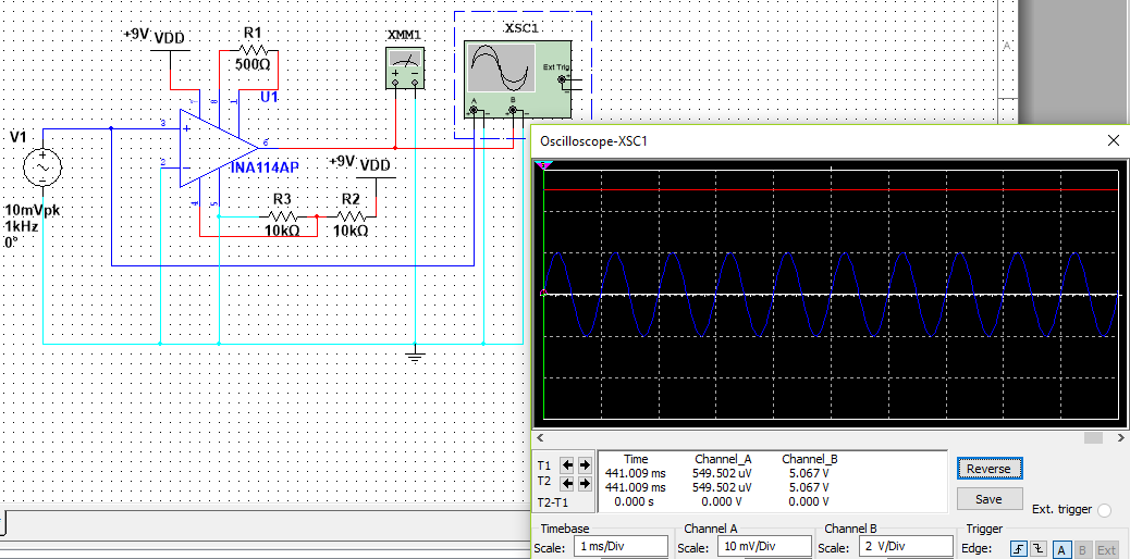

Question on reference voltage of the instrumentation amplifier (INA)
348 4
  • #1 21680715
    Mo Tuk
  • Swap INA pins 4 and 5 and reference input to 4.5V
    #2 21680716
    Elizabeth Simon
  • Use ICL7660 or buffered 4.5 V reference for INA
    #3 21680717
    Aubrey Kagan
  • Suggesting a TLE2426 buffered 4.5 V reference
    #4 21680718
    Aubrey Kagan
  • Single-supply INA supply range and reference pin question
    #5 21680719
