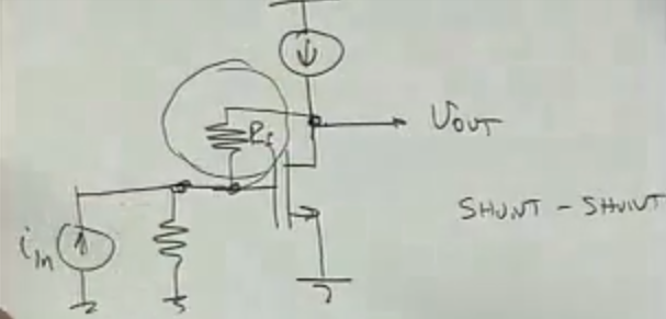

How to Identify Series-Shunt Feedback Type in a Given Circuit Diagram?
354 5
  • How to identify series-shunt feedback from a circuit
    #1 21682766
    Ryan Mco
  • #2 21682767
    David Ashton
  • #3 21682768
    Ryan Mco
  • Shunt-shunt feedback means voltage feedback
    #4 21682769
    David Ashton
  • Clarifying voltage feedback across the load
    #5 21682770
    Ryan Mco
  • Series resistor needed to sense load current
    #6 21682771
    David Ashton
