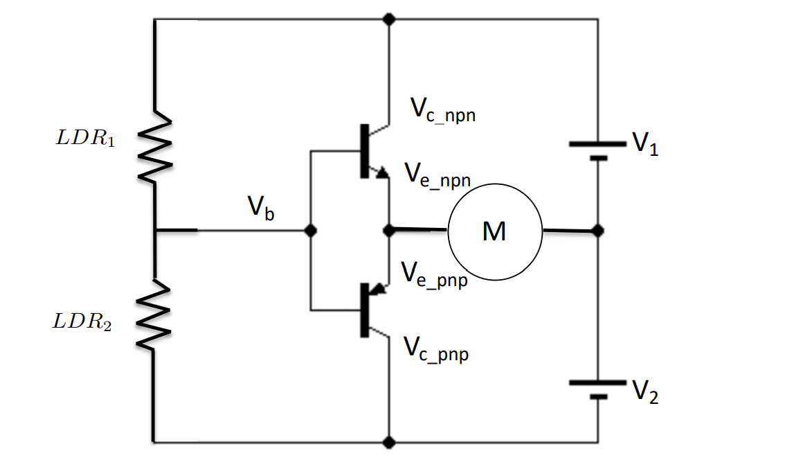

How to Calculate Base or Emitter Current with LDR1=100Ω, LDR2=200Ω, V1=V2=1.5V

  • Need transistor type and divider junction voltage

  • Base bias below 0.7 V leaves both transistors off
