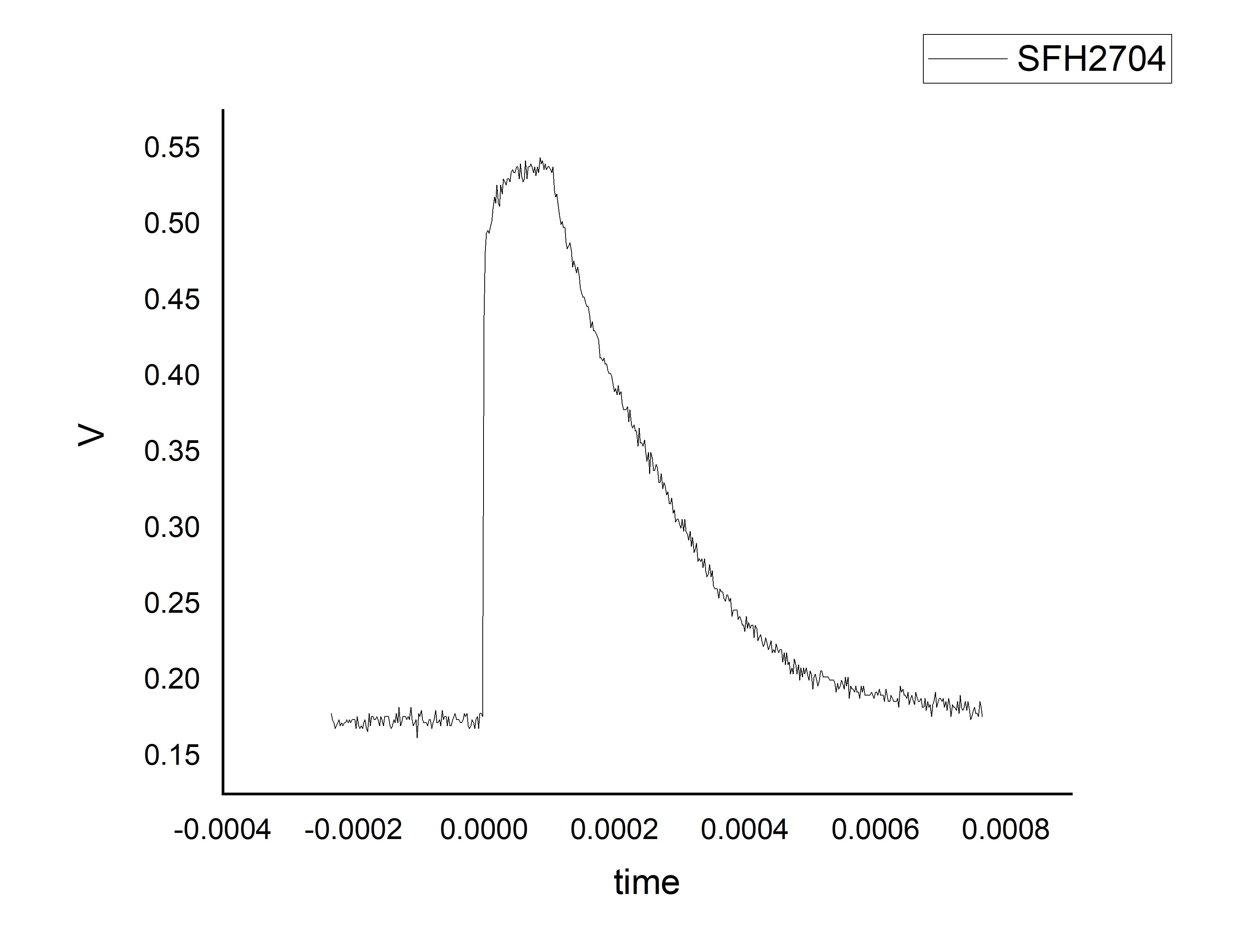

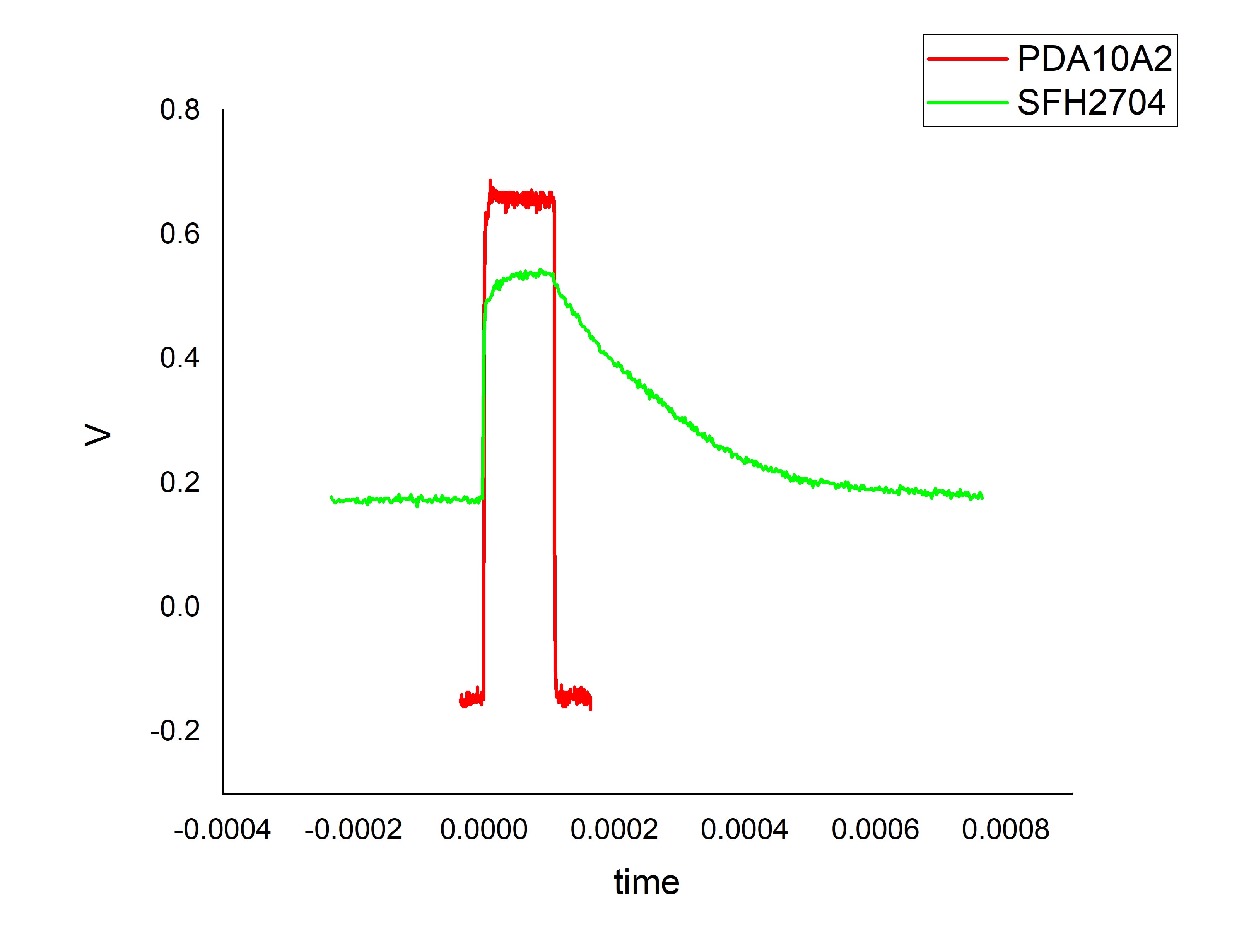

SFH 2704 Photodiode Fall Time Much Longer Than Datasheet—Why Is This Happening?
273 2
  • Light source pulse width explains slow photodiode fall time
    #1 21685301
    pooyaBA
  • #2 21685302
    Giovanni Di Maria
  • #3 21685303
    Richard Gabric
