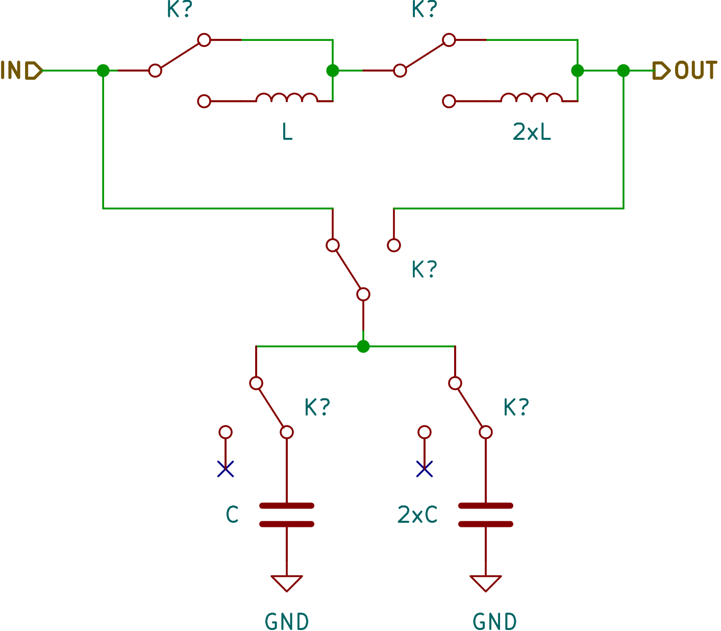

Solid-State Switches for 3-30MHz Antenna Tuner: Alternatives to DPDT Relays?
711 3
  • Solid-state RF switches are possible but need low parasitics
    #1 21685983
    KevinZ
  • RF MEMS switches as relay alternative
    #2 21685984
    Richard Gabric
  • Relays still best for HF tuner power handling
    #3 21685985
    KevinZ
  • Relays still best for 100W HF switching
    #4 21685986
    David Ashton
