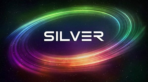

    Write new chip
    Colorful ring-shaped gradient with the word SILVER on a cosmic background 25VQ32
    • 25VQ32 BIN OK.bin (4 MB) You must be logged in to download this attachment.
