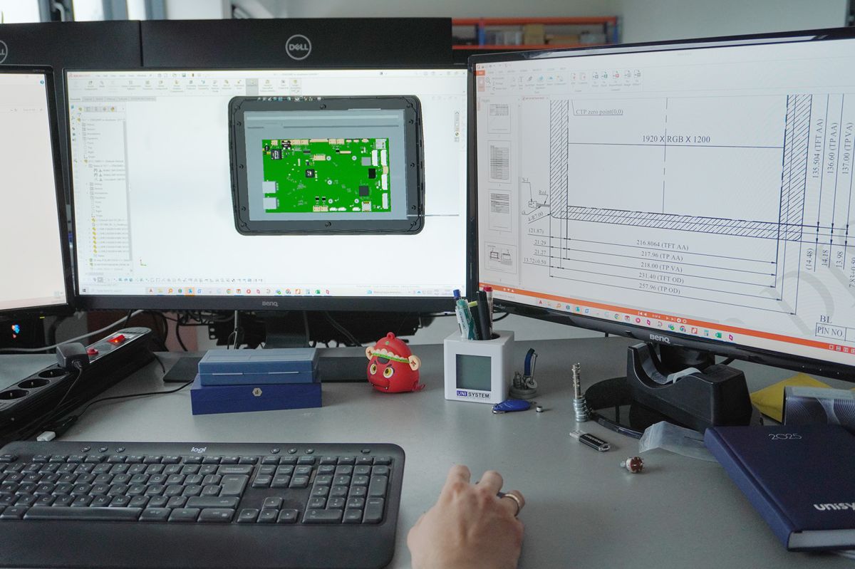

    Once the cost estimate is approved, we move on to the design phase. In an ideal scenario, work proceeds in parallel – electronics engineers develop schematics, select components, and design the PCB; the mechanical engineer prepares the enclosure design; and the software developer works on the environment and firmware. In practice, however, harmonious collaboration may depend on the specifics of the project, the availability of data or components, or the level of advancement of work on the customer’s side. Regardless of the sequence, the result is the creation of the first working prototype.

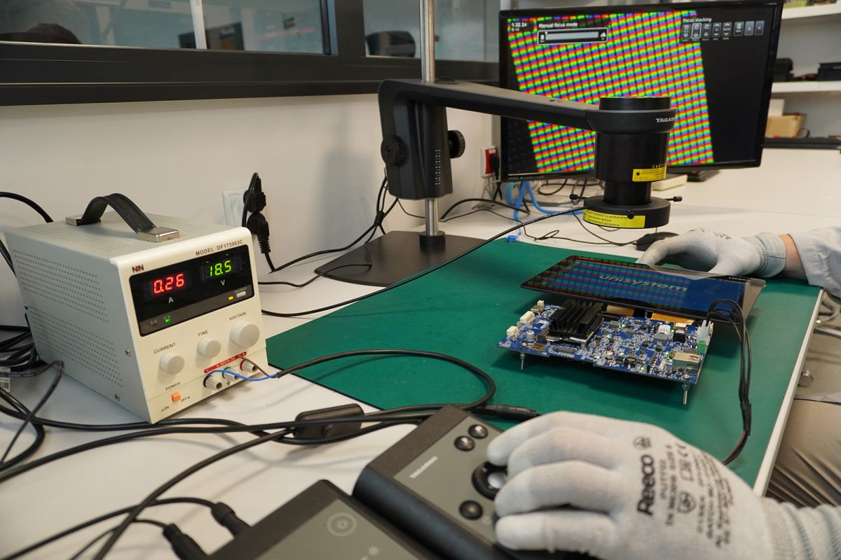

    The prototype undergoes testing and validation in two stages – first internally at Unisystem, and then at the customer’s site. This is the point at which comments and suggestions may arise, and the entire team still has the opportunity to introduce possible adjustments. When both parties agree that the solution is ready and meets all assumptions and standard requirements, we move on to preparation for production.
    Importantly, the entire process is based on continuous communication – the customer has full control and insight into progress at every stage of the work.

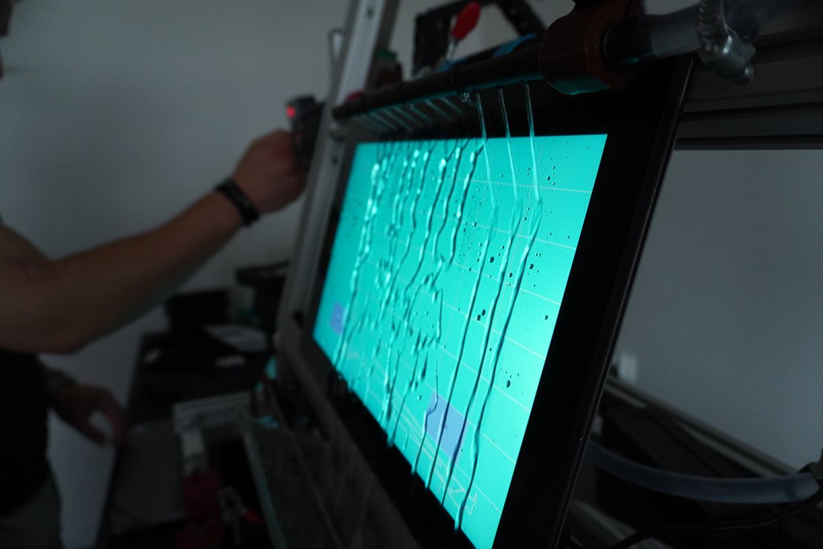

    Which environmental conditions you have encountered would you consider the greatest challenge?
    The most significant challenges emerge during the development of devices designed for outdoor operation. These are environments in which equipment is exposed to many factors that significantly affect reliability, such as changing weather conditions, contamination, vibration and shock, intensive use – often with the risk of mechanical damage – and the need for continuous operation.
    In such cases, it is not sufficient to simply select appropriate components for a display module. It is also crucial to ensure effective protection of the entire structure. This includes a properly designed enclosure, optimal glass thickness, specialized coatings such as Anti-Glare or Anti-Reflective, seals, and other protective measures that help maintain durability and functionality. It is often also necessary to meet specific environmental standards, such as IP protection classes defining resistance to water and dust, and IK impact resistance classes relating to mechanical strength.

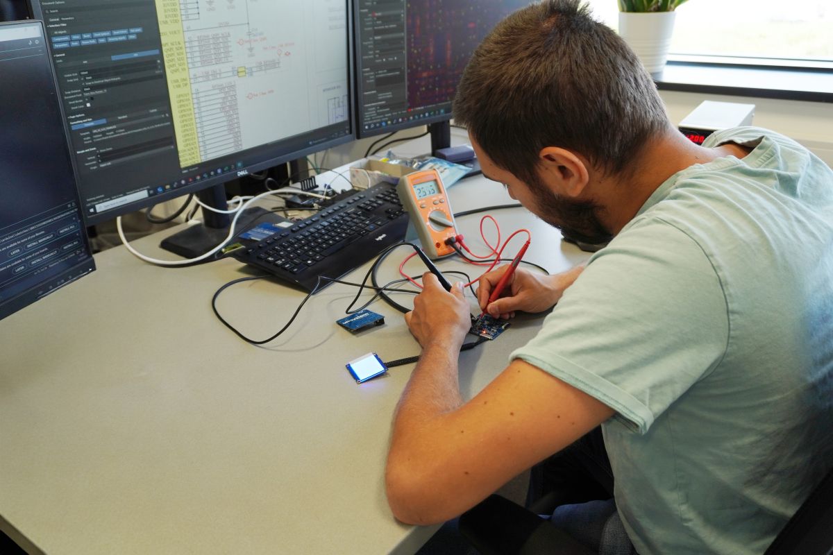

    Man testing a circuit board using a multimeter and soldering tool
    What are the biggest technical problems faced by Unisystem’s customers?
    Paradoxically, the greatest challenges often do not concern the technology itself, but business aspects. The most difficult task is finding a compromise between quality, cost, availability, and delivery time – and this is where project complexity most often arises.
    From a technical perspective, many issues are recurring: difficulties in assembling components, ensuring electromagnetic compatibility, or launching and configuring displays that appear simple at first glance but become complicated due to the use of less common interfaces. These are situations for which we have proven approaches.
    There are also, of course, complex problems requiring deep analysis, testing, and an iterative approach. These include irregular faults, hard-to-detect interference, or system integration issues with no obvious cause at first sight. In such cases, not only knowledge and experience are essential, but also the ability to maintain dialogue with the customer – both at the technical and organizational levels.

    The worker in the second photo is wearing work gloves, but the one in the third photo is not wearing any ESD protection. Do the authors of this article think that the readers of this forum are idiots?
  • #7 21821226
    Unisystem_Displays
    >>21820951
    Elektroda readers are vigilant - and very good 😉
    The ESD gloves didn't escape - it's just that in this photo we're in the R&D area, not in the lab.
    The photos were meant to show the nature of the team's work, and the equipment itself is "alive and well" 😉
