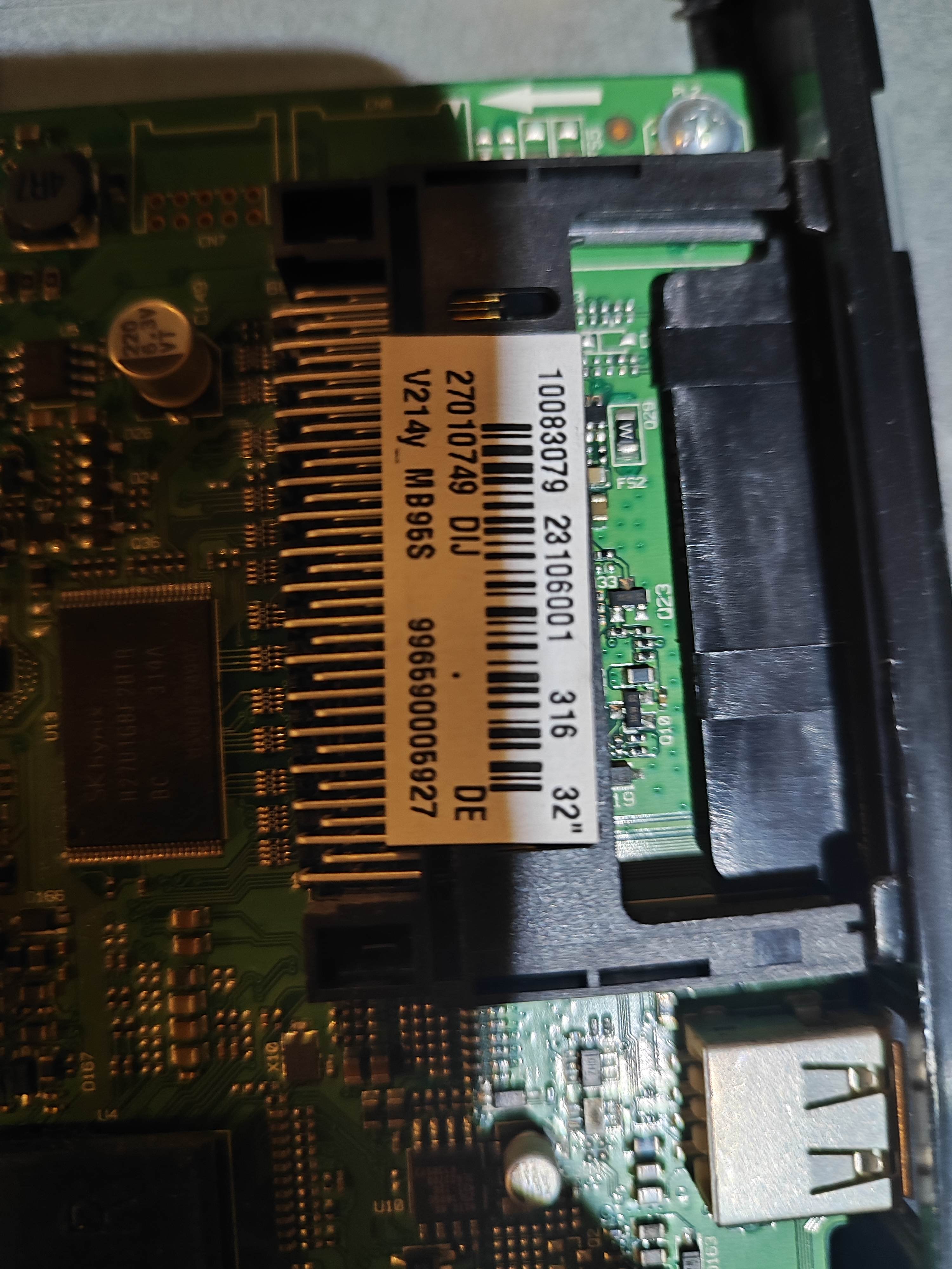

    Firmware Needed for Vestel TV with 17MB95S Mainboard & VES315WNDB-01 Panel - 17MB95S V214y.
    • Firmware Request for Vestel 17MB95S Mainboard VES315WNDB-01 Panel V214y IMG_20260301_231537.jpg (853.82 KB) You must be logged in to download this attachment.

    What's wrong with the TV? I remind you that 17MB95 motherboards are very easy to brick and difficult to repair.

    Hello, I need a correct firmware.Tv stucks at logo!!

    For the stick I only have this software in the archive. Try it at your own risk. Reread what I wrote in post #2.

    Thank you very much, sir. I just tried it, but something strange happens here. The upgrade procedure starts OK (red LED blinks rapidly), and after finish the TV starts with the old logo and gets stuck there. How is that possible? Maybe it is write-protected?

    If you have a programmer, you can try rewriting the flash memory.

    It worked!! Thank you sooo much! I appreciate your professionalism!
