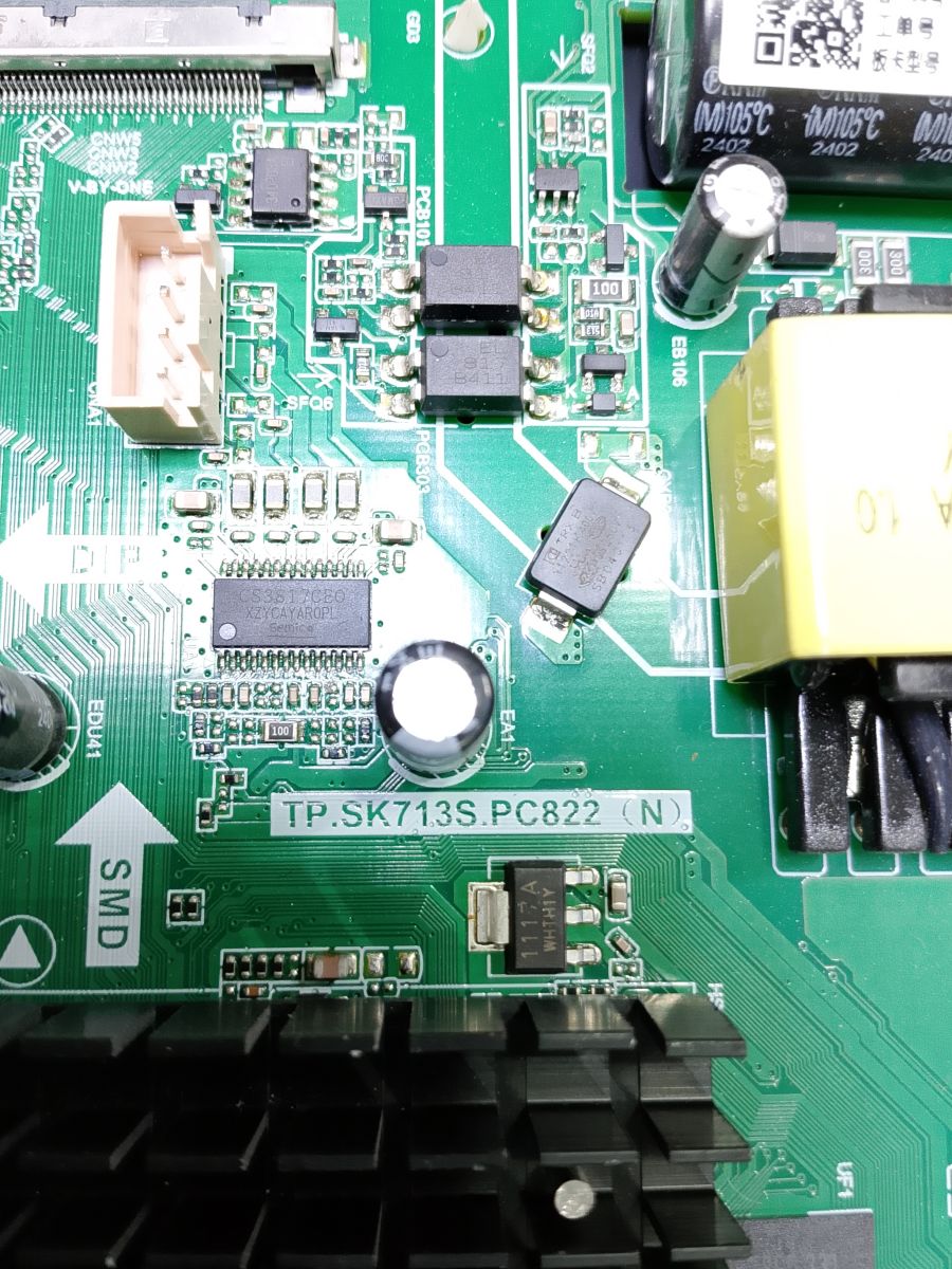

    Close-up of a green PCB with SMD components, capacitors, and the marking TP.SK713S.PC822
    Firmware @ElektrodaBot
  • Need exact TV model and panel sticker for firmware match

    Initial assessment of available information
    - Your photo clearly shows the board variant: TP.SK713S.PC822 (N). Good—this “(N)” vs “(T)” suffix is critical for firmware choice.
    - This chassis is a 3‑in‑1 Smart TV mainboard used across multiple brands (including Nikai). It is built on the Amlogic T962D4 family and typically uses 8 GB eMMC (e.g., KLM8G1GETF). Panel presets and device options are model‑specific, so the exact firmware must match both the board variant and LCD panel. (gmctechgroup.com)
    Direct answer to the question
    - Yes, I can help you with firmware for TP.SK713S.PC822 (N) used in a Nikai TV—but to provide a safe, working image I need the TV’s exact model and, most importantly, the LCD panel model from the sticker on the panel frame. With those two, I can point you to a tested USB package or a full eMMC dump if USB recovery fails. (firmware.dou.pt)

    TP. SK713S. PC822 is the description of bare tile without elements, crosslinking and Firmware
    Important white sticker that describes the TV model and its matrix
    from CVTE Dream-Future/ Mainland China
    Look for example Link
    The TP.SK713S.PC822 is a supported analog and digital 4K UHD smart Android board with the most recent Android version of 13.0.
    - Link
