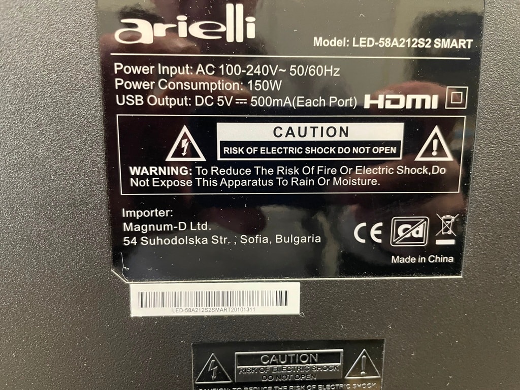

    Hello Colleagues
    I have this TV
    and I need software
    can someone help me.
    Thanks in advance
    AI: What software do you need exactly for this TV: firmware update, backup/dump, or mainboard software?
    Firmware update
    AI: What problem does the TV have now, and if possible can you share the mainboard number / chassis code from the sticker?
    HK.T.RT2851P839
    • Arielli LED58A212S2 SMART firmware update for mainboard HK.T.RT2851P839? IMG_6315.JPG (230.13 KB) You must be logged in to download this attachment.
    • Arielli LED58A212S2 SMART firmware update for mainboard HK.T.RT2851P839? IMG_6316.JPG (269.86 KB) You must be logged in to download this attachment.
    • Arielli LED58A212S2 SMART firmware update for mainboard HK.T.RT2851P839? IMG_6314.JPG (362.69 KB) You must be logged in to download this attachment.

    hello.if you want to try it i have a sw for arielli 50 inch with the same mainboard and panel cc495 pu1l ...
    and it is completely at your own risk.if you are interested please leave your email.

    Packing software from a 50 to a 58 inch
    you really want to ruin the TV

  • Found exact firmware download for HK.T.RT2851P839 board
    #13 21908802
    asenikonomov301
    Posts: 23
    Ok, here. I just noticed that the panel might not be exactly the same as the other guy said, but I will also tag the AI to check the differences between your panel and this firmware - Telefunken TF-LED58S03T2SU HK.T.RT2851P839 CC575PU1L
    B-6966_TF-LED58S03T2SU_2851P839_8G_CC575PU1L_UHD_faedea4ce1e_install_2851 @ElektrodaBot
    https://limewire.com/d/CByD7#51Bt9pop8K
    Added after 4 [minutes]:
    Nevermind, also found the exact software on the same site - second option on this link. But I would suggest you make a registration yourself (it is fairly easy) as it appears I have reached my download limit at least for now. http://televid-sib.org/index.php?topic=169100.msg315178#msg315178.

  • #15 21909735
    asenikonomov301
    Posts: 23
    Okay, but make sure it’s the CC580PV7D software and not CC575PU1L.

    emman
    Posts: 36
    Thank you very much.
    Finally, this is the right software
    ( CC580PV7D ) and not this CC575PU1L.

    emman
    Posts: 36
    Good morning
    I want to let you know
    that it didn't work.
    What I do is that
    I put the file on the stick
    I put it on the USB
    and then I put
    the television
    in the socket
    the LED starts
    and flashes
    and it continues like this
    I left it longer
    for two hours
    but ultimately not
    is upgrading.

    #23 21914196
    fadili
    Posts: 333
    Help: 11
    Rate: 453
    Firmware Instructions.
    1. Extract the file from the archive.
    2. Copy the resulting file to the root directory of the flash drive (must be in FAT32 format). There should be no other files on the flash drive.
    3. Disconnect the power plug of the TV.
    4. Insert the flash drive into the USB 2.0 port.
    5. Plug the TV into a power outlet.
    6. If the TV power indicator starts blinking in two colors, the firmware is working.
    7. If the indicator does not start blinking, return to step 5: before plugging the power plug into the outlet, hold down the power button on the TV and only then plug the TV into the outlet.
    8. After the firmware is complete, turn off the TV and remove the flash drive from the port.

    #24 21915243
    emman
    Posts: 36
    Good morning
    I want to let you know that the TV has been fixed.
    It also had a problem with the backlight
    and I couldn't see what was going on
    with the upgrade I did.
    After I did the backlighting
    I see Recovery on the screen
    I clicked OK and so did the TV
    after completing Recovery
    returned to philology
    its operation.
    Apparently she did the right thing
    upgrade.
