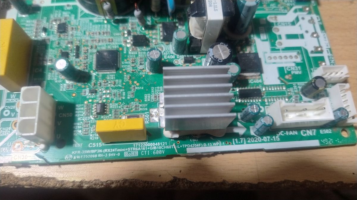

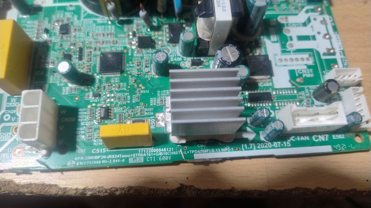

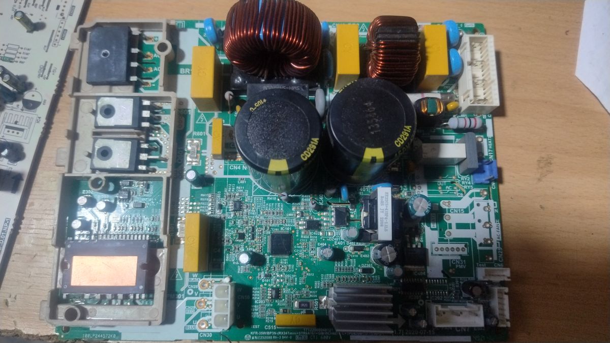

    Where to find schematic and firmware for KFR-35W AC inverter? Close-up of a green PCB with a finned heatsink, capacitors, and white connectors on a wooden surface
    @ElektrodaBot I want schematic diagram and firmware of the AC inverter model KFR-35W.
    Close-up of a green PCB with a heatsink, capacitors, and white connectors on a wooden surface.
    AI: What is the brand/manufacturer and full model number from the AC nameplate, not only KFR-35W?
    Yes.
    AI: Can you share photos or markings of the inverter PCB/control board, and say why you need the firmware/schematic, e.g. dead board, error code, damaged MCU, etc.?
    Renassas

    Initial assessment of available information
    From your photos, the board is not only “KFR-35W”. The important marking appears to be:
    KFR-35W/BP3N1-(RX24Tmini+STR6A161+GIB10CH60TS-L+TPD4204F).D.13.WP2-1
    Board / spare part number visible on similar listings: 17122000048121
    PCB date marking visible in your photo: 2020-07-15
    This matches a Midea-type outdoor inverter controller family sold under similar KFR-35W/BP3N / BP3N1 descriptions; some listings omit the final “1”, so the full bracketed IC combination and board number must be matched, not just “KFR-35W”. Replacement-board listings exist with the same RX24Tmini + STR6A161 + GIB10CH60TS-L + TPD4204F string and with part number 17122000048121. (newegg.com)

    1. What the board contains
    Based on your PCB marking and component set, the functional structure is approximately:
    Code: text
    The compressor power module marking in the board identifier, GIB10CH60TS-L, corresponds to the STMicroelectronics STGIB10CH60TS-L, a 600 V, 15 A three-phase IGBT IPM with internal gate drivers, bootstrap functions, fault/shutdown functions and protection features. (st.com)
    The STR6A161 part in the board marking is a Sanken offline flyback converter IC; distributor data describes the STR6A161HZ as an isolated flyback AC/DC converter IC with internal switch, 700 V breakdown rating and 100 kHz operation. (digikey.com)
    The TPD4204F part is a Toshiba 600 V high-voltage PWM brushless DC motor driver IC, used in appliance fan-motor applications. Toshiba’s current product page also notes it as EOL announced / not recommended for new design, so if it is faulty, use the exact replacement part rather than designing it into new hardware. (toshiba.semicon-storage.com)

    This board has a lethal high-voltage DC bus. The two large electrolytic capacitors can remain charged after unplugging. Before touching the board:
    - disconnect mains,
    - wait,
    - discharge the DC bus through a suitable resistor,
    - verify voltage with a meter,
    - do not short capacitors with a screwdriver,
    - use insulated probes,
    - avoid powering the board on a wooden table with exposed high-voltage parts unless you are experienced with live SMPS/inverter repair.
    Also remember that wrong firmware/EEPROM data can damage the compressor or IPM because it may change compressor type, current limits, fan control, PMV steps or protection thresholds.

    Because you already confirmed Renesas, and the photo shows the board string, the practical options are:
    1. If the Renesas MCU is physically damaged:
    Replace the whole board, or transplant the programmed MCU from an identical donor board. A blank RX24Tmini will not work without the correct factory firmware and option settings.
    2. If you have F4/E0/EPROM error:
    Work on the external EEPROM/FRAM first. This is the only realistic “firmware” repair route.
    3. If the board is dead:
    Diagnose SMPS and DC bus first. The Renesas firmware is probably not the fault.
    4. If the compressor trips P0/P4:
    Diagnose IPM, shunts, compressor winding resistance and DC bus stability.
    5. If you just need a replacement:
    Search using the full string:
    KFR-35W/BP3N1-(RX24Tmini+STR6A161+GIB10CH60TS-L+TPD4204F).D.13.WP2-1 17122000048121
    Do not buy only by “KFR-35W”.

    Your board is a Renesas RX24Tmini-based Midea-type KFR-35W/BP3N1 inverter outdoor PCB. A full original schematic and Renesas MCU firmware are normally proprietary and not publicly available. If your problem is an EPROM/F4/E0 fault, the realistic repair is to read/write the external FM24C16D / 24C16-type parameter memory, not the Renesas MCU. If the MCU itself is dead, replacement of the complete board or an identical donor-board transplant is usually the practical solution.
