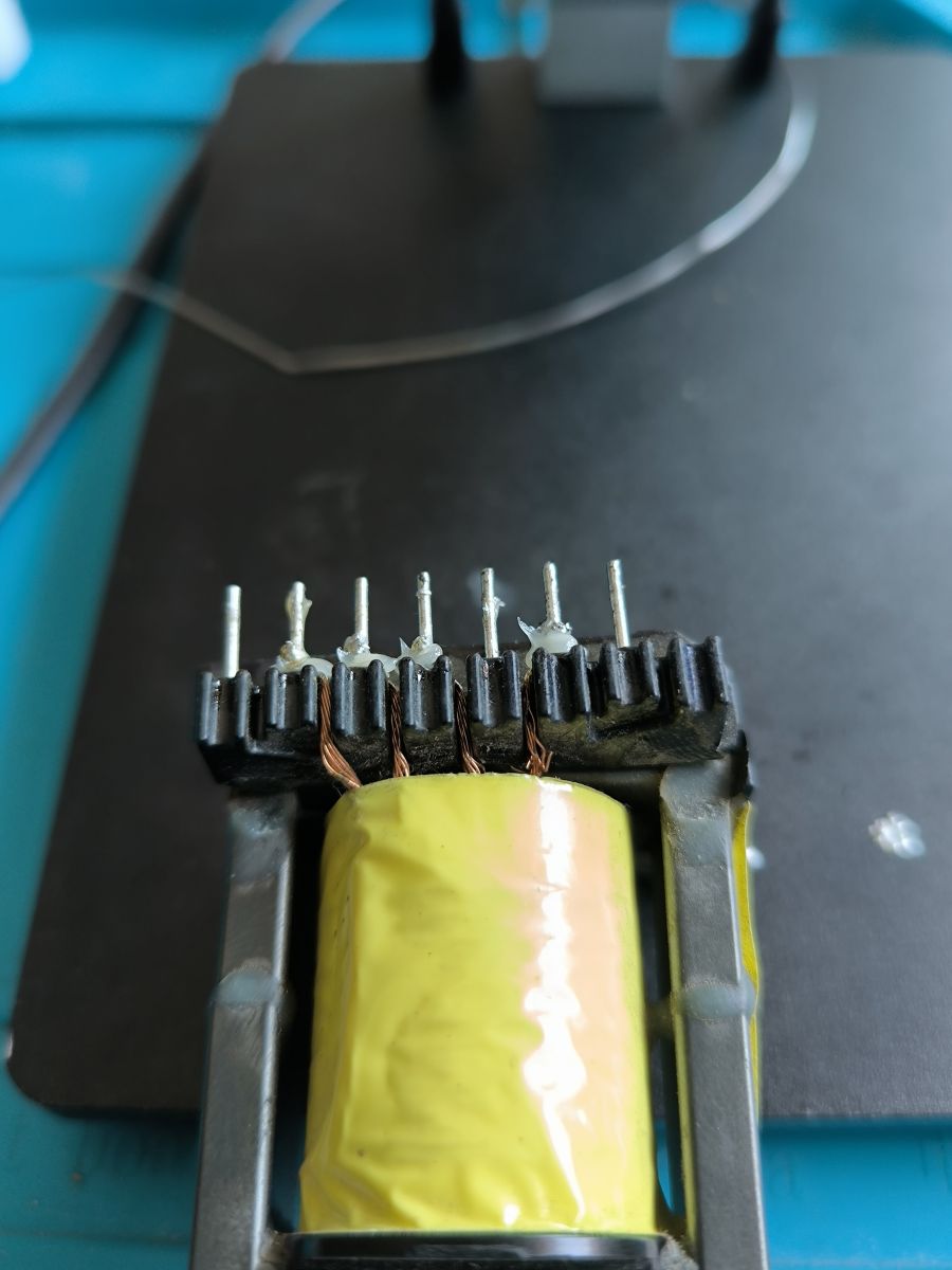

    nabijacD2X8A231Eka Hilti C 4/36-ACS sa po vložení baterky po 5 s vypne.T1 D2X8A231E je poškodene, poraďte kde ho kúpim? alebo nejakú

    Je poškodený iba tento diel T1, alebo ste merali/skontrolovali aj okolité súčiastky, poistku, tranzistory/triaky a kondenzátory v nabíjačke?
    Nekontroloval som ďalej.

    slavo117 wrote:
    The T1 D2X8A231E model is faulty
    How did you come to that conclusion? It very rarely breaks down.

    >>21924907 The wires have been torn off.

    Please note that this is a Polish forum and Polish is the language used here.
    This transformer does not fail and is therefore not available as a spare part. You can only buy one from second-hand equipment.
    slavo117 wrote:
    It switches off 5 seconds after the battery is inserted.
    This fault is not caused by damage (broken wires) to the transformer. You have a different underlying fault, and you have caused mechanical damage to the transformer.
