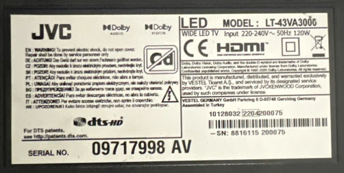

    I have a JVC TV that keeps displaying a "Memory full" message; it won't let me access the menu to reset it or do anything else.
    Model: JVC LT-43VA3000

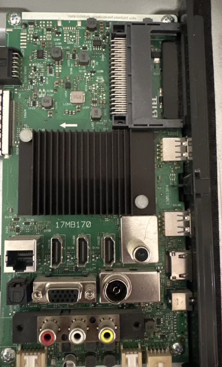

    Chassis: Vestel 17MB170

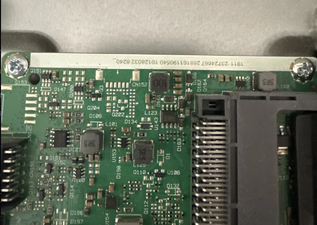

    Board code: 23724667
    Symptom: "Low space" / "Storage full" message; no menu access.
