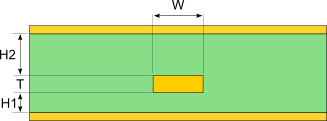

| Trace Thickness | T | ||
| Substrate Height | H1 | ||
| Substrate Height | H2 | ||
| Trace Width | W | ||
| Substrate Dielectric | Er |

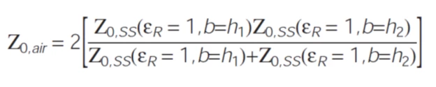

ΔZ0,air is given by the following equation:
Eq. 2
Where h1 is the distance between the signal line and the lower reference plane, h2 is the distance between the signal line and the upper reference plane, and Z0,air is given by:
Eq. 3
Z0,SS is the symmetric stripline impedance computed according to Eq. 1 or Eq. 3 of the Symmetric Stripline Impedance tool, providing, in turn, the following input values:
