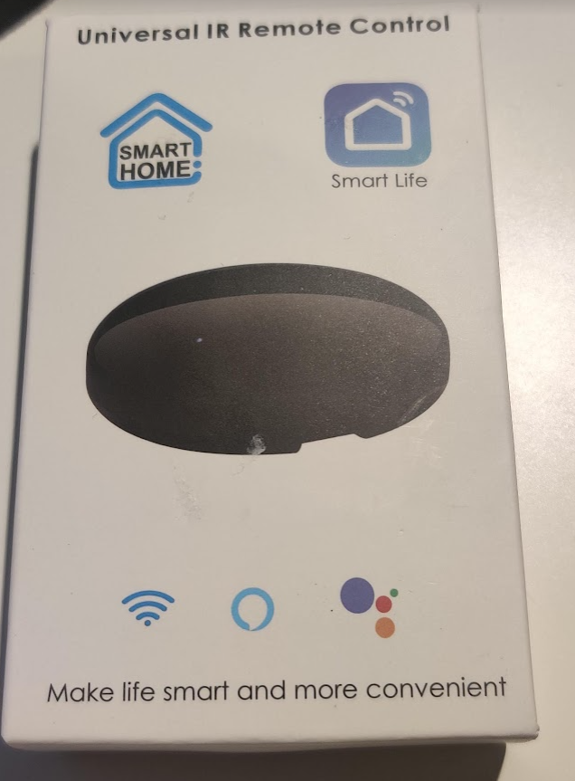

  • BK7231N-based universal IR remote control now has a working IR blaster on firmware 1.15.x, tested on a Model S08 / PCB S06-CBU-V1.2.
  • All flashing pins are exposed on the board, including TX1, RX1, GND, 3.3v, and CEN for reset.
  • After flashing, set PinDescription 7 IRSend, 8 IRRecv, and 24 wifiLed, then restart because IR pins do not change in real time.
  • Firmware 1.15.226 and the webapp log confirm IRRecv captures external remote codes, and IRSend can replay commands like LG-88-130-1.
disassembly pictures:
December 2022 update:
* the IR blaster is now working (firmware 1.15.x , i tested mine on 1.15.226)
* this device is Model S08 / PCB: S06-CBU-V1.2
* all the pins needed for flashing are easily accessible on the board (TX1,RX1,GND,3.3v and CEN for reset)
* After flashings set pins as follows and restart the device! (IR pins are not changed at real-time)
PinDescription
7IRSend
8IRRecv
24wifiLed
* Testing the IRRecv: go to the webapp log and shot some coded for external remote, you should see something like that:
Info:IR:IR IR_LG 0x88 0xC005 0
Info:IR:IR IR_LG 0x88 0x160 0
Info:IR:IR IR_LG 0x88 0x970 0
Info:IR:IR IR_LG 0x88 0x980 0
Info:IR:IR IR_LG 0x88 0x990 0
* Testing the IRSend: copy the protocol and command from the log to create ir-send command as in the example below
IRSend LG-88-130-1
