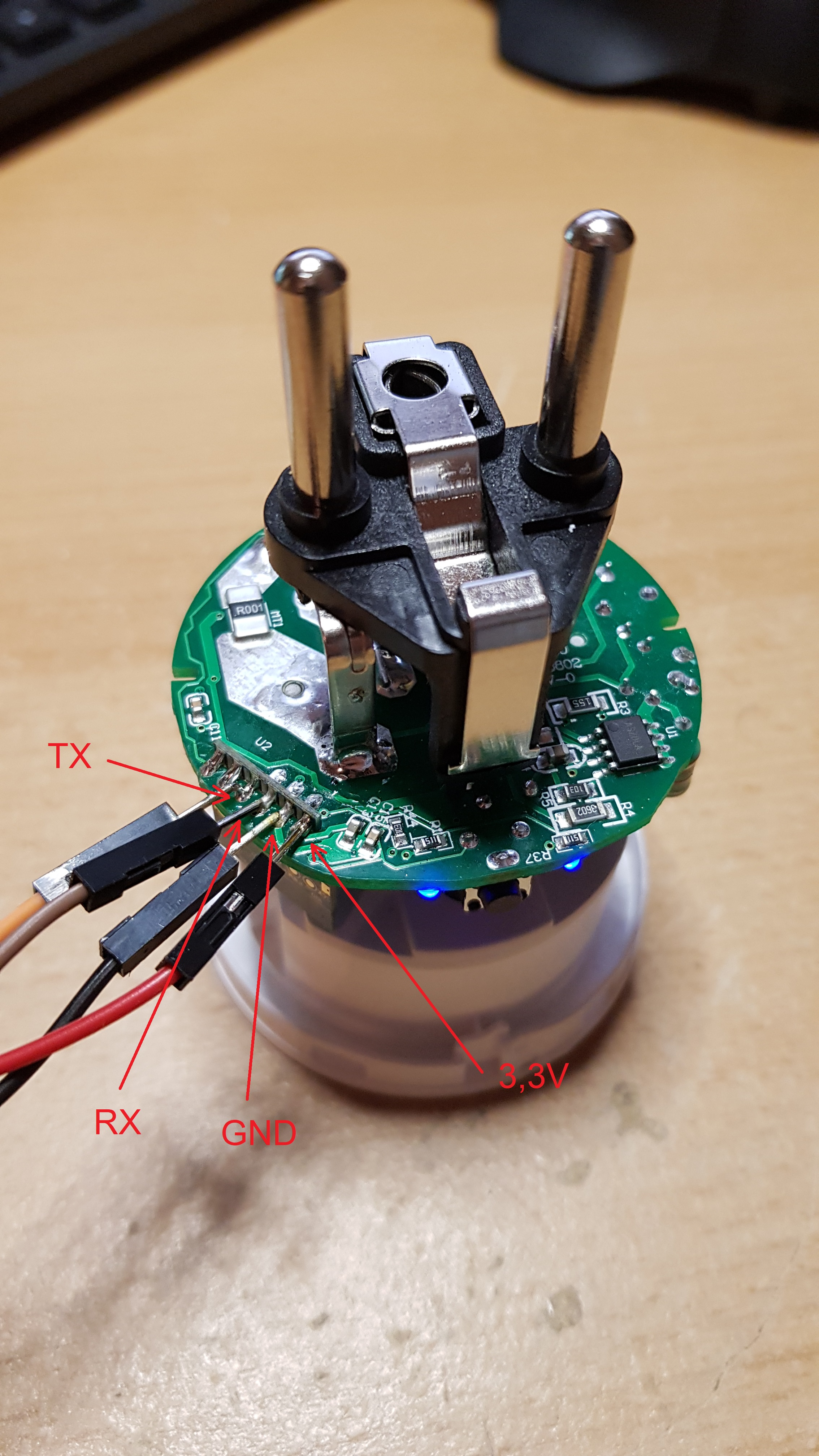

Hi Community,
I would like to contribute my teardown to a power plug with energy monitoring.
The power plug is from ANTELA and is called "ANTELA Smart Plug Model: F1s202-EU".
I bought it on Amazon Germany Link.
The Tuya module WB2S is used for this power plug, which is based on the BK7231T. The energy monitory IC is the known BL0937.
The flashing was pretty easy since I could use "bk_writer1.60.exe" to get a backup of the original firmware and the same program to flash the firmware. Before writing the firmware "OpenBK7231T_UA_1.15.52.bin" I needed to erase the original one.
But before flashing we need to open the device, which is to be hones not very easy and will not happen without any damage on the housing.
With two small screwdrivers between the inlet and the housing we can manage this. Connect 3,3V, GND, TX1 and RX1 (see pictures) with your UART device of trust.
Ones we flashed it, use the following config:
In short:
Brand: ANTELA
Module: WB2S
MCU: BK7231T
Power monitoring IC: BL0937

@Tilator thanks, is Denver SHP-102 BK7231T or BK7231N?
https://obrazki.elektroda.pl/4260076700_1682363154_thumb.jpg
https://obrazki.elektroda.pl/4338606900_1682363169_thumb.jpg [Read more]
Tilator
24 Apr 2023 22:11
https://obrazki.elektroda.pl/5758567100_1682368938_thumb.jpg
It's BK7231T as well as the Antela.
Seems to have same WB2S board. [Read more]

Hi community
First of all, special thanks @nkuehnel86 for the tear-down.
I recently bought some of these smart plugs and wanted to try out OpenBeken, because it looks quite nice.
So I started by... [Read more]
25 Apr 2023 21:15
Have you tried the second method, doing power cycle by disconnecting 3.3V from device (maybe connecting it to GND from device side) and reconnecting it?
Where do you get 3.3V from, can it supply enough... [Read more]
lechndo
26 Apr 2023 21:46
Thank @pkaczmarek2 for your thoughts.
Seem I finally got it to work.
At least I was able to properly connect and read a backup of 1150976 bytes (0x119000) and a CRC of 0x1e9b0464
followed by one failed... [Read more]
