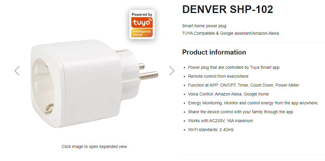

  • Denver SHP-102 pinout and Cloudcutter flashing
    #6 20553564
    Tilator
    Posts: 139
    Rate: 13
    Denver SHP-102 seems to be the same device.
    Can be flashed using Cloudcutter. Package is simply glued, but no need to open it.
    Configuration:
    P6 (PWM0) LED 0
    P7 (PWM1) BL0937CF
    P8 (PWM2) BL0937CF1
    P9 (PWM3)
    P10 (RXD1) LED_n 0
    P11 (TXD1) Btn 0 0
    P24 (PWM4) BL0937
    P26 (PWM5) REL 0
  • #7 20554100
    Posts: 14767
    Rate: 12907
    @Tilator thanks, is Denver SHP-102 BK7231T or BK7231N?
    [BK7231T - WB2S] ANTELA WiFi power plug with energy monitoring (BL0937)
  • #8 20554187
    Tilator
    Posts: 139
    Rate: 13
    It's BK7231T as well as the Antela.
    Seems to have same WB2S board.

Can the Denver SHP-102 be flashed the same way?
Yes. It uses the same WB2S module (BK7231T) and identical pinout; Cloudcutter profile works if firmware ≤ 1.1.8 [Elektroda, Tilator, #20553564; p.kaczmarek2, #20554187].
