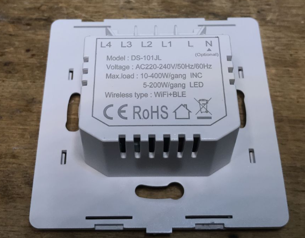

Here is a short teardown and flashing instruction (and how-to-free-from-cloud guide) for another popular Tuya wall switch, the WiFi DS-101JL, although you can also do the same with its 2gang and 3gang version. This switch is based on BK7231N, so you can upload OpenBeken . There is a module inside CB3S which directly controls the relays, as well as touch buttons and additional LEDs (WiFi status LED and relay status LEDs). Both LEDs are on separate GPIO, which is very good, because it gives us the ability to freely configure their behavior (some people prefer the LED to be on when the light is off, and others to have the LED turn on together with the light).
Purchase of DS-101JL
The product was bought on a Polish auction site for less than PLN 55 (12$ or so) with free shipping, it was bought by a reader so that I could change the firmware for him:
The specification reveals that it may be something on the BK7231, because Bluetooth is mentioned in it, the ESP8266 itself does not support BT:
Product Parameters:
Installation:
The above switch can work without the N cable! Connection details in the diagram.
The seller does not display the model of the product, but one of the graphics from the auction shows that it is DS-101:
Parcel received
Let's see what do we get in the package?
The set also includes a capacitor to be mounted in parallel:
Description of the assembly in Polish (a plus for the seller for writing "capacitor" and not an adapter):
By the way, this capacitor also has a built-in resistor, does anyone know, maybe for what purpose it is? Is this just against holding a load longer or does it have another role?
And the switch itself:
DS-101JL teardown/b]
We pry the front cover with a screwdriver:
We pry the board, which is held only by a pin connector:
The switch uses the CB3S WiFi module. The chip in the SOIC is not a TuyaMCU, it's just a touch button controller.
PCB designation: A-1011WL3B2-REV A0 2022-08-18
I haven't analyzed the power section yet, but here are some pics:
On the board you can see S7142S:
As usual, we have a small flyback converter here. You can also see elements that look like triacs or MOSFETs, NP3095. The small A63A chip is probably the LM321, but I have not analyzed its role in this system, and I have not deciphered the meaning of the LPS A60T1.

The firmware change went smoothly. Now you can use Home Assistant Discovery in OBK to pair the switch with Home Assistant. The double and triple gang versions can also be handled in the same way. Fortunately, there was no additional MCU inside handling anything but communication, it is not a TuyaMCU based switch, so there are no complications or difficulties to set up.
By the way, this switch may be better to buy in some cases, because it is able to run without N, and also because there are two LEDs on separate GPIOs.
