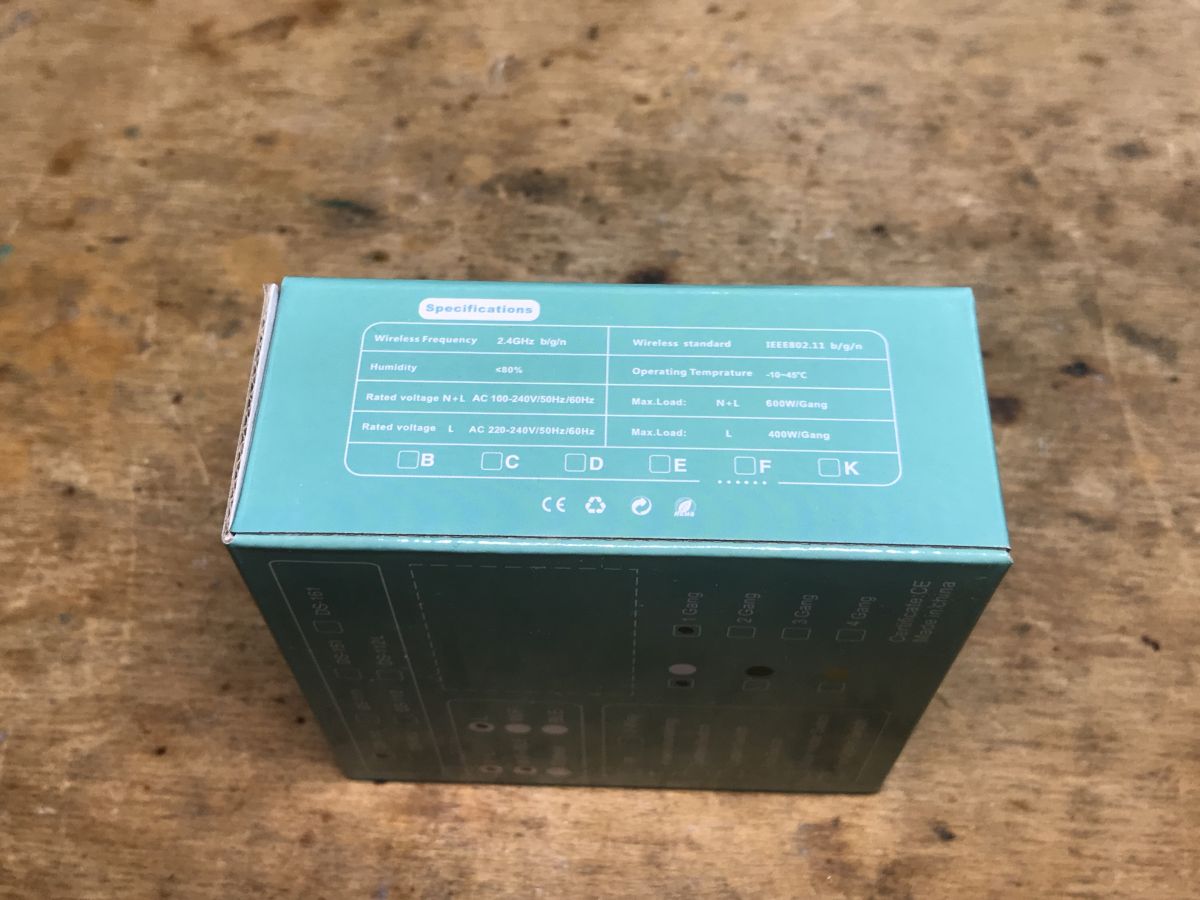

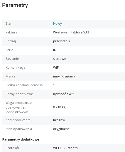

    Purchase of DS-101JL
    The product was bought on a Polish auction site for less than PLN 55 (12$ or so) with free shipping, it was bought by a reader so that I could change the firmware for him:
    [BK7231N/CB3S] DS-101JL WiFi Single Light Switch Teardown and Flashing Guide for Home Assistant
    The specification reveals that it may be something on the BK7231, because Bluetooth is mentioned in it, the ESP8266 itself does not support BT:

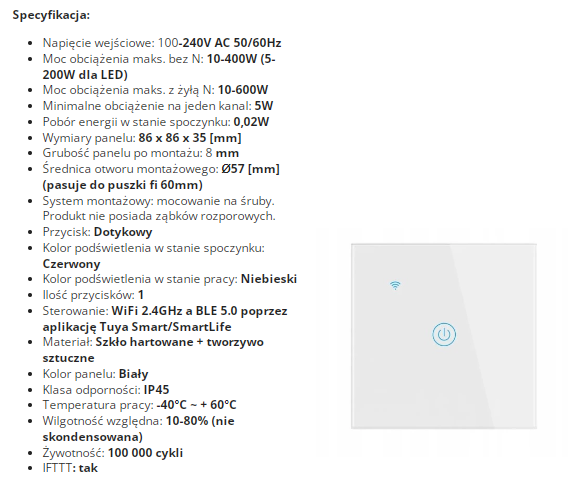

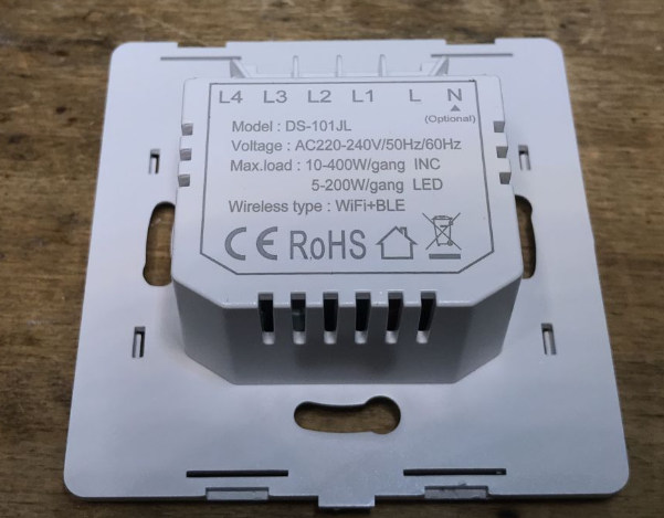

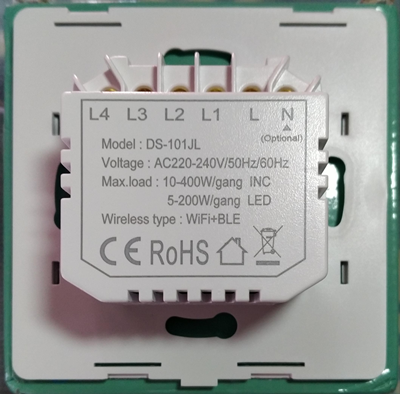

    Product Parameters:

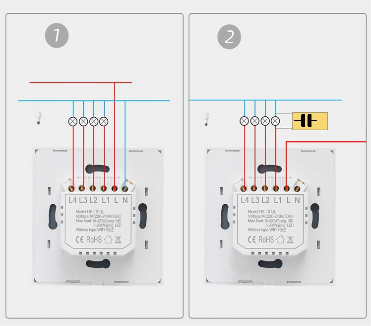

    Installation:
    The above switch can work without the N cable! Connection details in the diagram.
    The seller does not display the model of the product, but one of the graphics from the auction shows that it is DS-101:

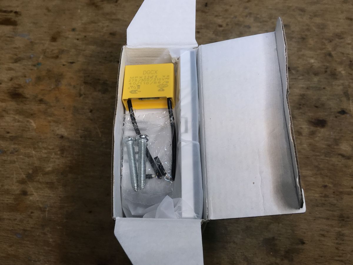

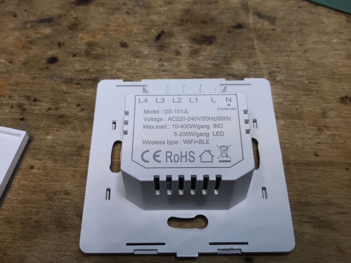

    Parcel received
    Let's see what do we get in the package?
    [BK7231N/CB3S] DS-101JL WiFi Single Light Switch Teardown and Flashing Guide for Home Assistant [BK7231N/CB3S] DS-101JL WiFi Single Light Switch Teardown and Flashing Guide for Home Assistant [BK7231N/CB3S] DS-101JL WiFi Single Light Switch Teardown and Flashing Guide for Home Assistant [BK7231N/CB3S] DS-101JL WiFi Single Light Switch Teardown and Flashing Guide for Home Assistant

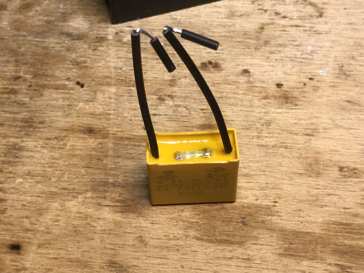

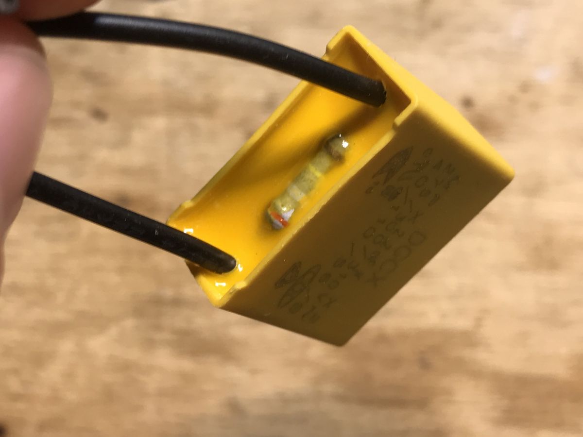

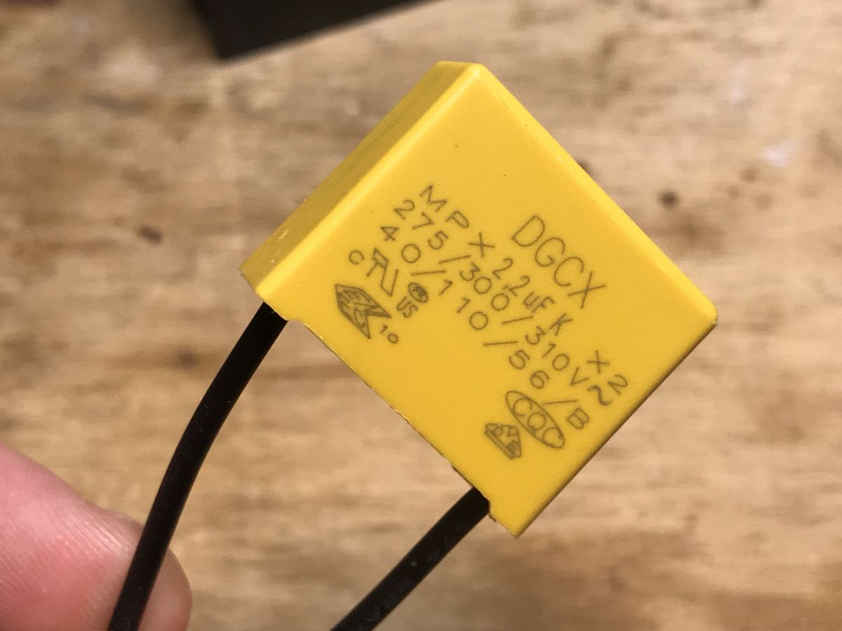

    The set also includes a capacitor to be mounted in parallel:
    Description of the assembly in Polish (a plus for the seller for writing "capacitor" and not an adapter):
    By the way, this capacitor also has a built-in resistor, does anyone know, maybe for what purpose it is? Is this just against holding a load longer or does it have another role?

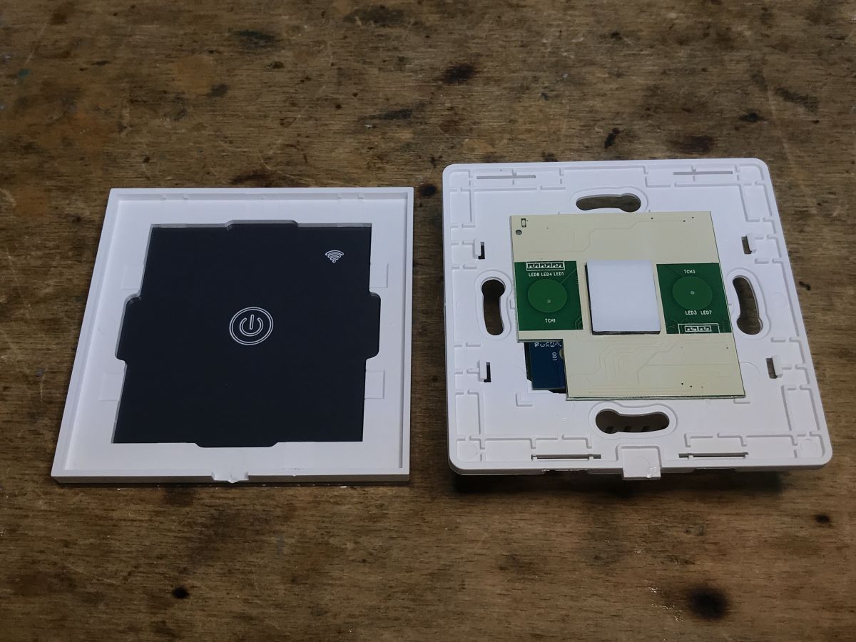

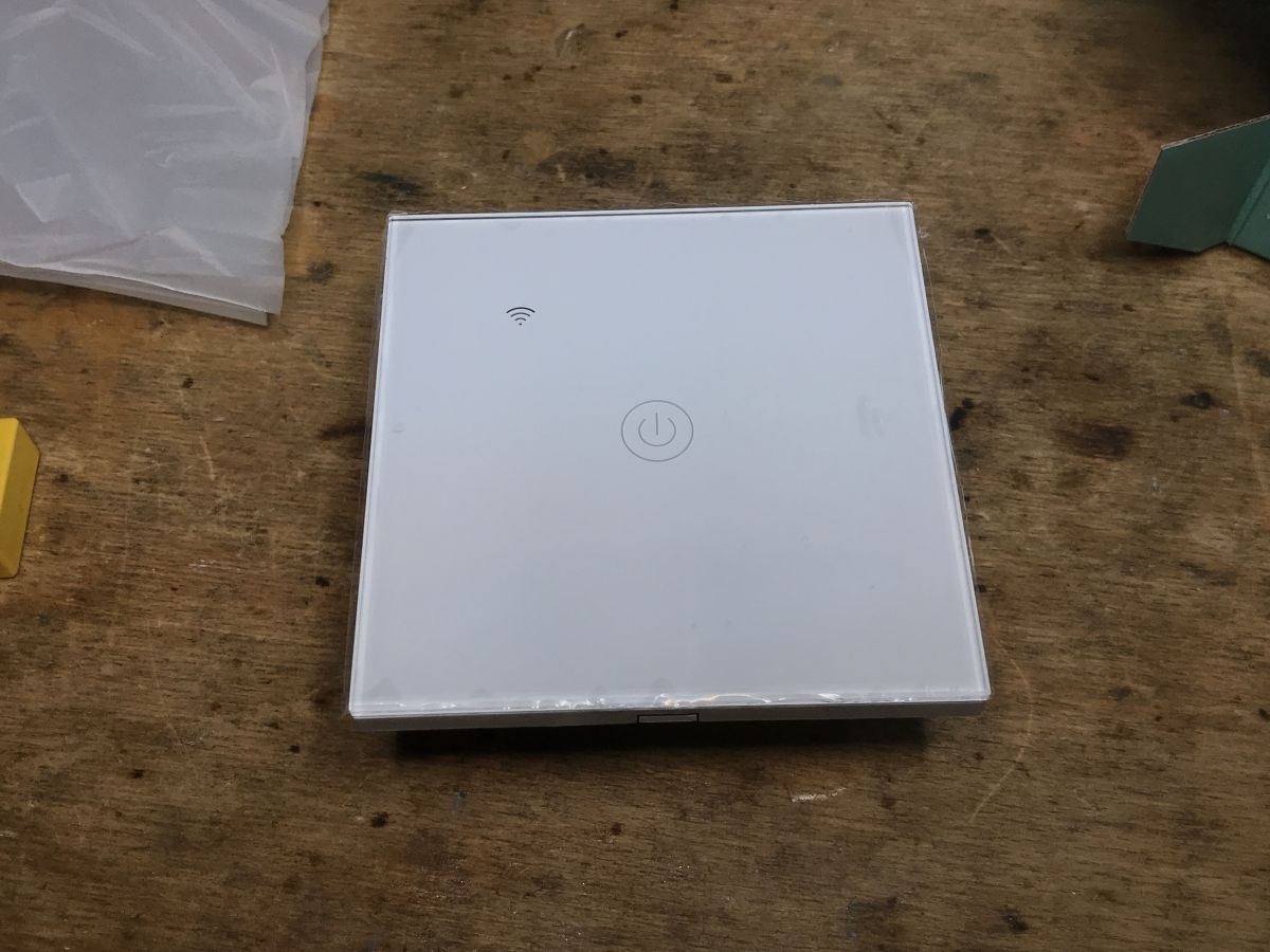

    And the switch itself:
    DS-101JL teardown/b]
    We pry the front cover with a screwdriver:

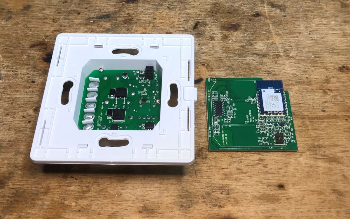

    We pry the board, which is held only by a pin connector:

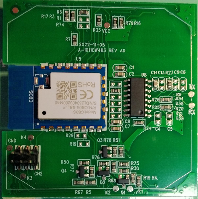

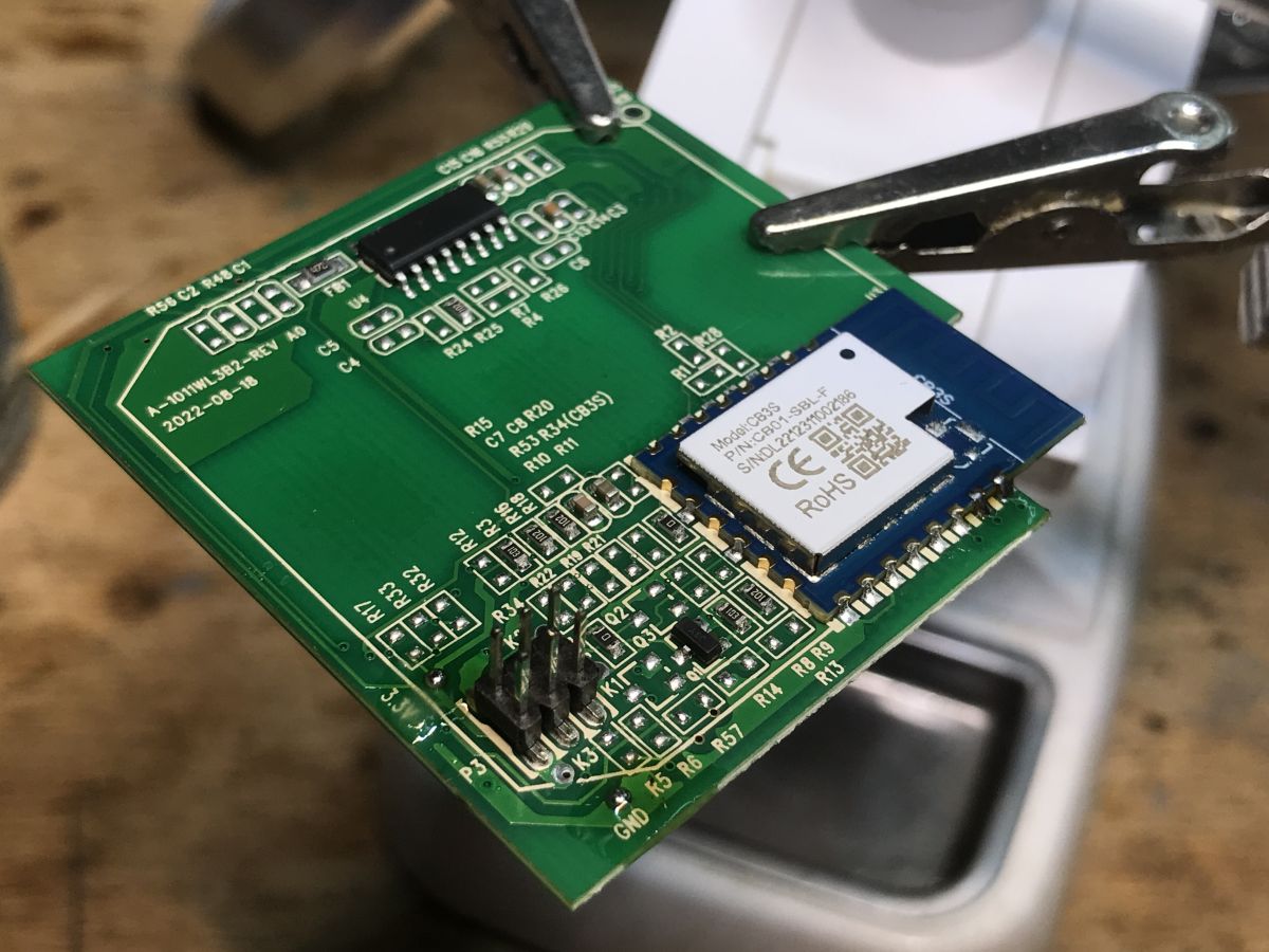

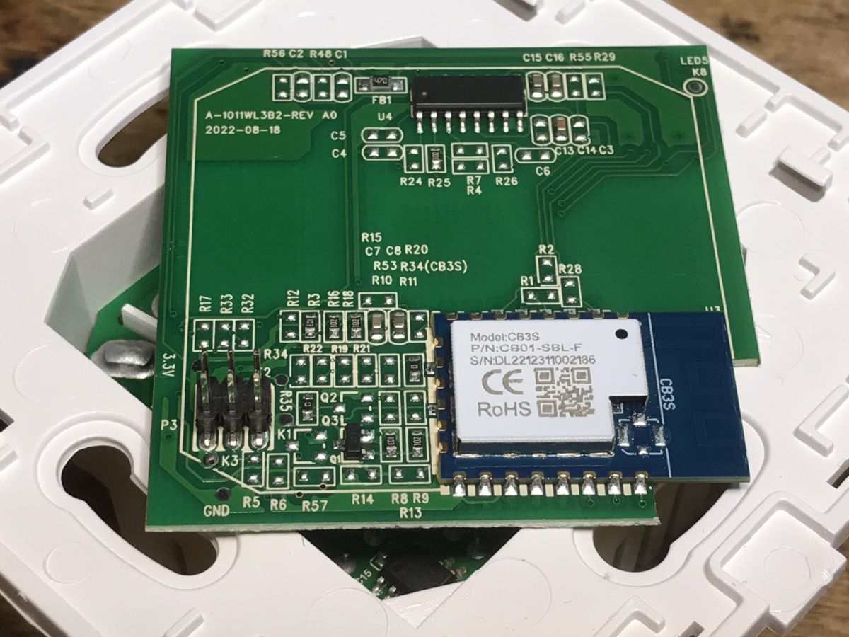

    The switch uses the CB3S WiFi module. The chip in the SOIC is not a TuyaMCU, it's just a touch button controller.
    PCB designation: A-1011WL3B2-REV A0 2022-08-18

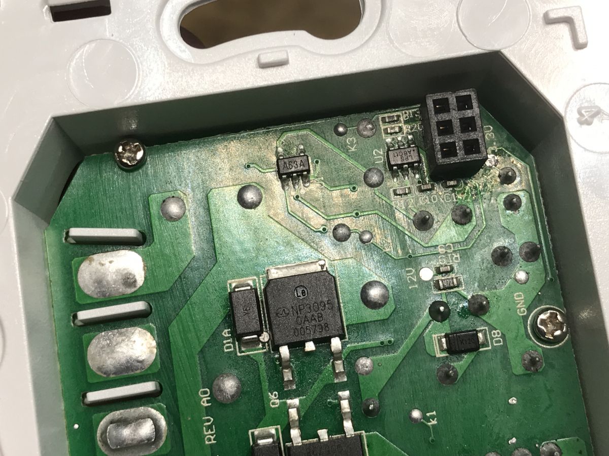

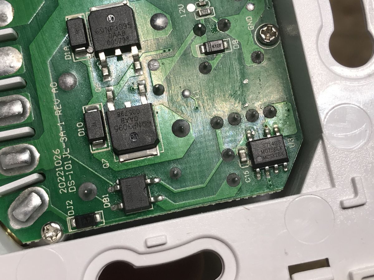

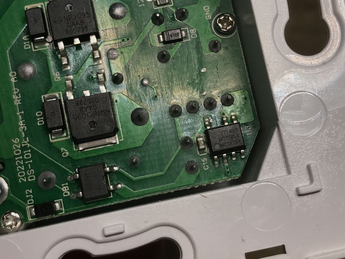

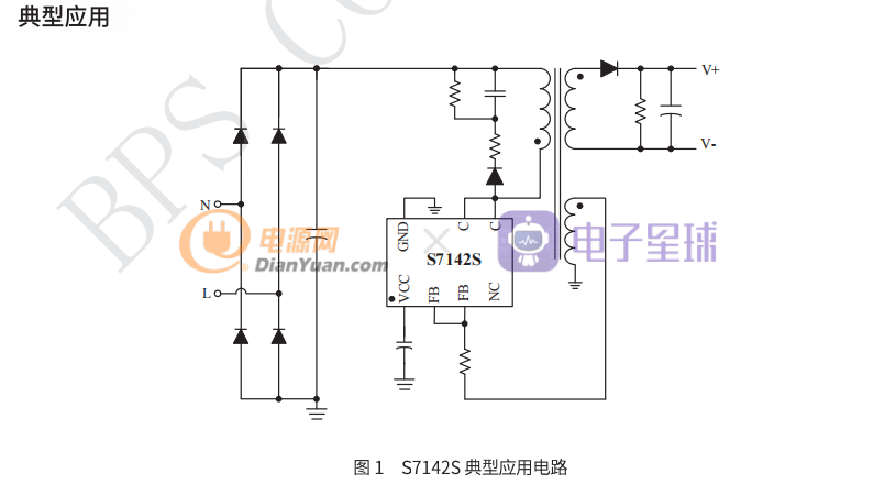

    I haven't analyzed the power section yet, but here are some pics:
    [BK7231N/CB3S] DS-101JL WiFi Single Light Switch Teardown and Flashing Guide for Home Assistant [BK7231N/CB3S] DS-101JL WiFi Single Light Switch Teardown and Flashing Guide for Home Assistant [BK7231N/CB3S] DS-101JL WiFi Single Light Switch Teardown and Flashing Guide for Home Assistant [BK7231N/CB3S] DS-101JL WiFi Single Light Switch Teardown and Flashing Guide for Home Assistant [BK7231N/CB3S] DS-101JL WiFi Single Light Switch Teardown and Flashing Guide for Home Assistant
    On the board you can see S7142S:
    As usual, we have a small flyback converter here. You can also see elements that look like triacs or MOSFETs, NP3095. The small A63A chip is probably the LM321, but I have not analyzed its role in this system, and I have not deciphered the meaning of the LPS A60T1.

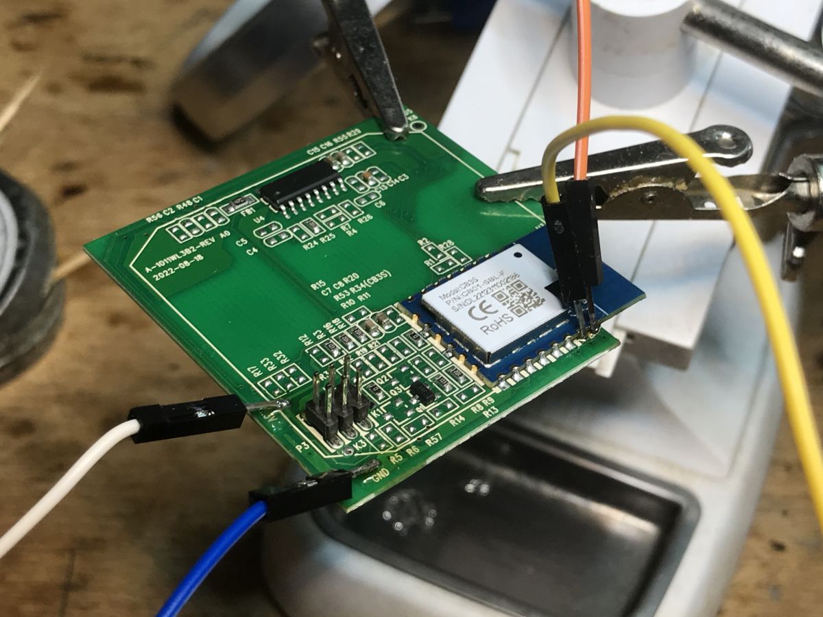

    [b] Firmware change

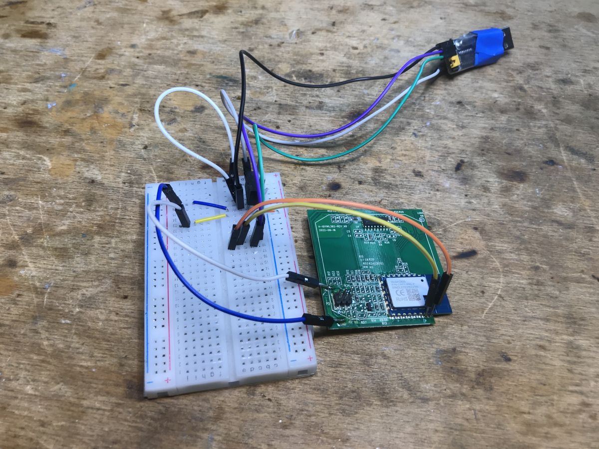

    The purpose of the topic is to change the product firmware, so I will focus on the WiFi module board. I will use BK7231 gui flasher as per:
    First, some flux and time to whiten the pads, ground and 3.3V, as well as RX1 and TX1:
    You can find CB3S pins on the web.
    Then we solder the wires:

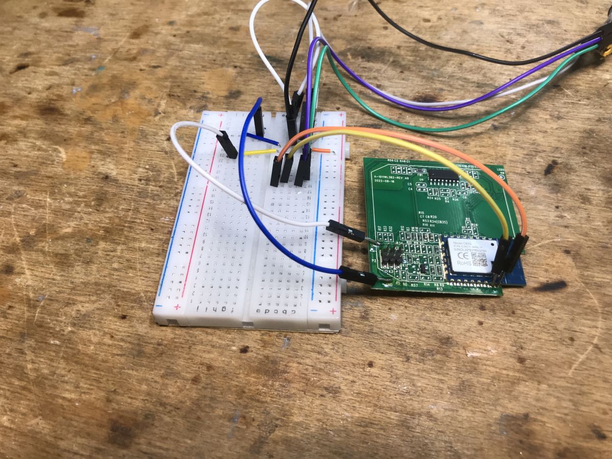

    Ready layout (see BK7231 gui flasher manual):
    BK7231 gui flasher in the latest version can extract the Tuya GPIO configuration The full template is below:
    Description in words:
    - Relay (channel 1) on P6
    - WiFi LED on P22
    - LED (channel 1) on P26
    - Button (channel 1) on P20
    Summary
    The firmware change went smoothly. Now you can use Home Assistant Discovery in OBK to pair the switch with Home Assistant. The double and triple gang versions can also be handled in the same way. Fortunately, there was no additional MCU inside handling anything but communication, it is not a TuyaMCU based switch, so there are no complications or difficulties to set up.
    By the way, this switch may be better to buy in some cases, because it is able to run without N, and also because there are two LEDs on separate GPIOs.

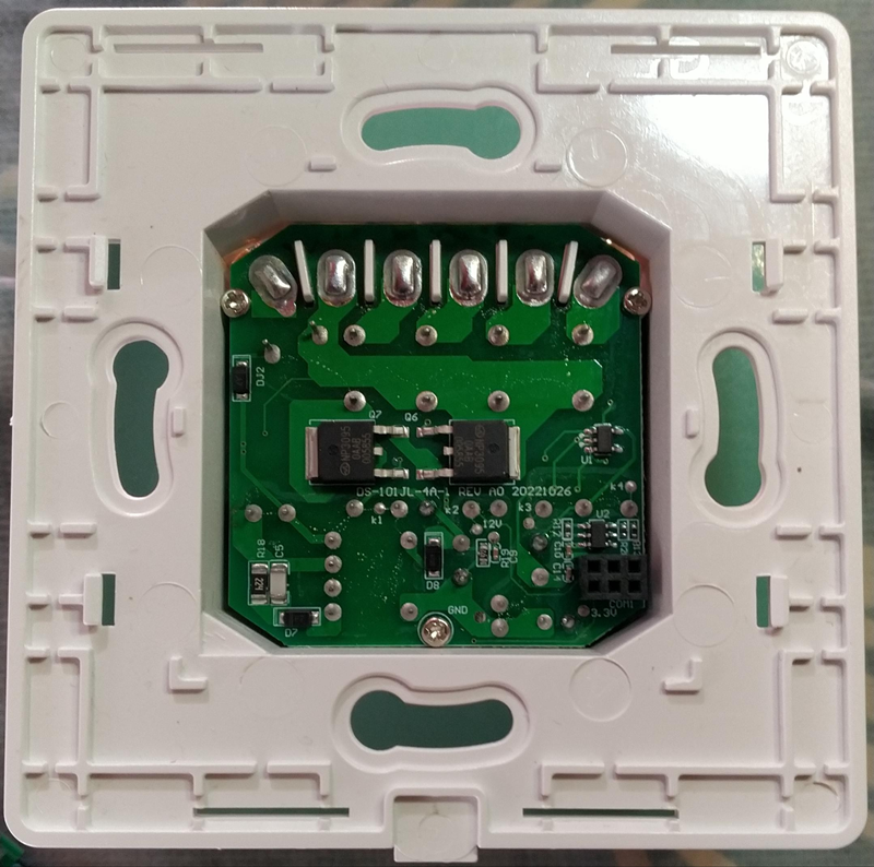

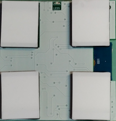

    Here are some pics:
    Green product box with text SWITCH Smart life goes now and logos of Amazon Alexa and Google Assistant.
    Wall switch module DS-101JL with specification description on its casing

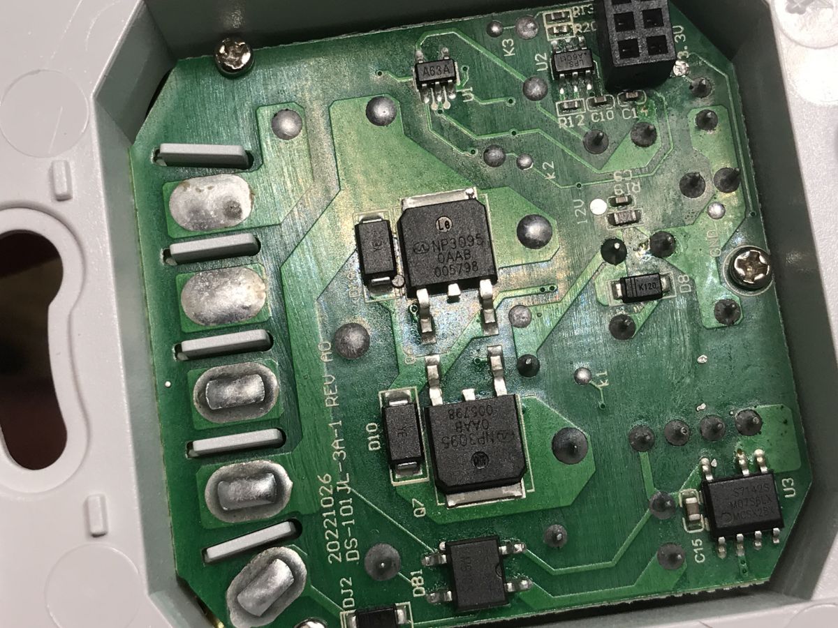

    Close-up of DS-101JL-4A-1 circuit board in a white frame.
    PCB: DS-101JL-4A-1 REV A0 20221026
    Close-up of a PCB with a CB3S module.
    PCB: A-1011CW4B3 REV A0 2022-11-05
    View of a printed panel with four white buttons on a PCB.

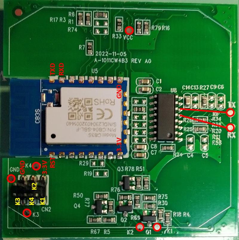

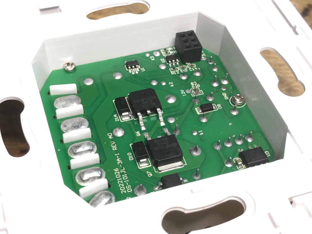

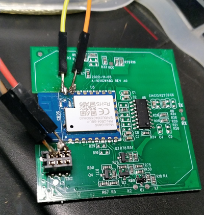

    Here are the possible connection points for flashing:
    PCB of DS-101JL-4A-1 modem with labeled connection points.
    Since I had a 2mm (not standard 2.54mm) pin header, I decided to use that for solderless power connection and soldered jumper cables for TXD/RXD.
    Close-up of a PCB with connected wires.
    RST was momentarily grounded to initiate flashing.
    I could not use the higher baud rates offered by the tool. Ended up using 19200.

    However there was a problem. The Blue LEDs of the switches get lit when active, but the Red LEDs when switched off did not get lit.
    Looking at the Tuya configuration, interesting finding was made:
    "backlit_dp":"16",
    "backlit_io_lv":"1",
    "backlit_io_pin":"23",
    "backlit_select":"1",
    So I set PIN 23 to "Always High" and then all the RED LEDs got lit up.
    Then I set PIN23 to LED and a new toggle button appeared.
    So you can either leave it permanently HIGH or configure a toggle button on webGUI to toggle it. First option is preferred I suppose.

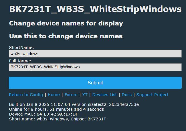

    There was one more issue with the tool.
    I used the option in the tool to configure automatically.
    However the device name did not match the standard default device naming convention of using the last 4 octets of the MAC address
    Name can be changed in Configure names to anything you want:
    Interface for changing device names for BK7231T_WB3S_WhiteStripWindows with fields for entering short and full names.

  • The featured 1-gang DS-101JL was bought for less than PLN 55 (about $12) with free shipping, making it a low-cost candidate for local Home Assistant control. [#20646676]
  • The no-neutral package included a parallel capacitor, and the wiring diagram explicitly states the switch can work without an N wire. [#20646676]
  • The serial flashing work on the CB3S board used exposed pads for 3.3V, GND, RX1, and TX1 on the Wi-Fi module side. [#20646676]
  • One 4-gang unit needed a 2 mm header instead of standard 2.54 mm pitch for solderless power contact, plus jumper wires for TXD and RXD. [#20748402]

How do I flash a DS-101JL single light switch with a BK7231N CB3S module to OpenBeken for Home Assistant?
You flash it over 3.3V serial using the CB3S pads and BK7231GUIFlashTool. 1. Open the switch, lift the board, and tin the pads for 3.3V, GND, RX1, and TX1. 2. Solder wires and connect them as shown in the BK7231 GUI flasher layout. 3. Read the Tuya config, flash OpenBeken, then use Home Assistant Discovery in OBK. [#20646676]

How can I identify the solder points for 3.3V, GND, RX, and TX on a DS-101JL board before flashing?
Identify them on the Wi-Fi module pads, not by guessing from the relay side. The teardown shows the author first tinned ground, 3.3V, RX1, and TX1 on the CB3S board, then soldered wires directly there. For the 4-gang board, another post also marked possible flashing points in a photo before wiring TXD and RXD. [#20646676]
What does the capacitor included with the no-neutral DS-101JL switch do, and why does it have a built-in resistor?
The thread only confirms that the no-neutral kit includes a capacitor mounted in parallel and that it also contains a resistor. The author asks whether the resistor prevents the load from staying energized longer or serves another purpose, but no final explanation appears in the discussion. Treat the resistor’s exact role as unresolved in this thread. [#20646676]

How can I rename an OpenBeken device if the automatic DS-101JL device name does not follow the usual MAC-based naming format?
Rename it manually in the OpenBeken interface. After one user reported that the auto-configured name did not match the usual last-4-octets MAC format, the reply showed that you can change the device name in the “Configure names” screen to anything you want. That fixes inconsistent naming without reflashing the switch. [#21395956]
