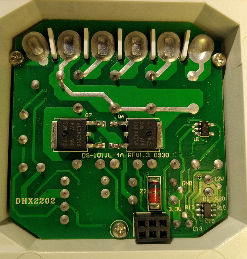

    I now need help with configutaion of the device.
    Since there is a TuyaMCU controlling the touch switches, I need some help with the autoexec.bat to confiure it.
    I am new to this TuyaMCU stuff.

  • Touch controller, not TuyaMCU; export tuya cfg from flash tool
    #2 20581468
    Posts: 14744
    Rate: 12839
    Hello, it seems we live in a small world:
    [BK7231T - WB3S] DS-101JL 3-Gang No Neutral Smart Switch
    This device is not TuyaMCU:
    At least not in my version.
    For me, this SOIC chip is just a touch button controller.
    To get config, please:
    1. in web App, go to Flash, and use this button to get tuya cfg:
    2. paste this file here as attachment or drag and drop it over the flasher:
    it will give you something like that:

  • WB3S pinout and Tuya config extracted
    #6 20581710
    Posts: 14744
    Rate: 12839
    Success!
    Description:
    - Button (channel 1) on P24
    - LED (channel 1) on P14
    - WiFi LED on P1
    - LED (channel 3) on P11
    - Relay (channel 2) on P9
    - LED (channel 2) on P26
    - Relay (channel 1) on P6
    - Relay (channel 3) on P7
    - Button (channel 3) on P8
    - Button (channel 2) on P10
    Device seems to be using WB3S module, which is using BK7231T.

  • #15 20604007
    jkwim
    Posts: 186
    Rate: 25
    The previously attached file works, as shown in my screenshot next to your post. Maybe your flasher is outdated and you need to download latest version?
    Version 1.1.0b worked fine.
    Thanks for all the additional features now:

    #19 20604553
    jkwim
    Posts: 186
    Rate: 25
    I am not sure if the latest version is released, but latest version is first using Tasmota status packet and then uses response to determine whether it's OBK or Tasmota. What could be improved there?
    Two issues that I have found.
    1. Tool determines tha device as a Tasmota but no information is collected/shown.
    2. Instead of Tasmota version, build tool details are shown
