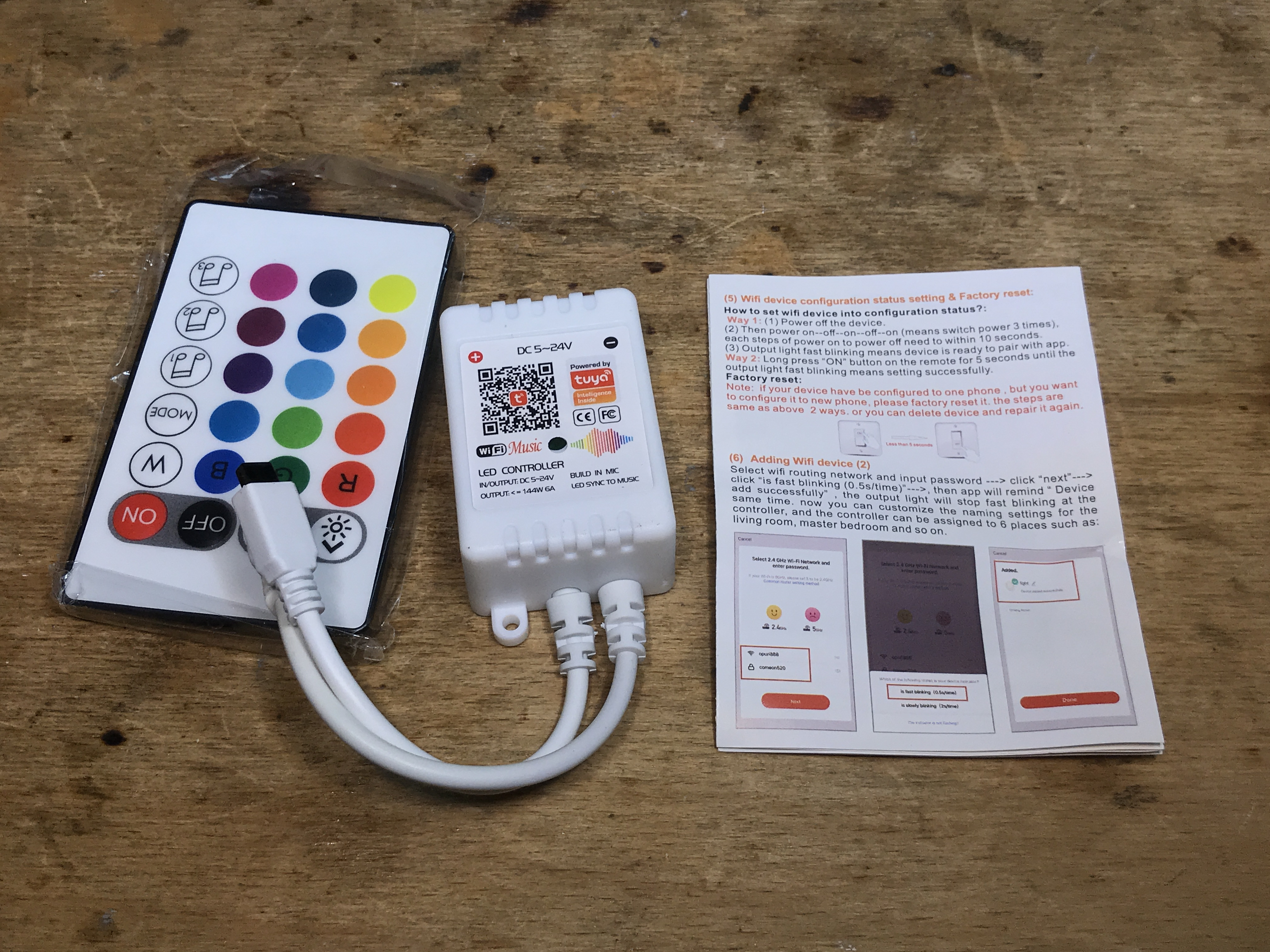

LED controller with remote and instructions on a wooden background.
Today, a short topic - the interior of a very cheap LED strip controller, available for purchase on a Polish auction website, offering WiFi control, remote control and playing to the rhythm of music. This time there will be a not-so-known WiFi microcontroller inside, the TR6260S1, which has only been mentioned on our forum only once or twice. At the moment, I don`t know if it`s possible to change the charge, but if I make progress, I`ll try to document what I found here.

There are no markings on the packaging:
Opened package of LED strip controller on a wooden table. White box with the text LED CONTROLLER on a wooden surface. White box on a wooden background. White box labeled LED CONTROLLER.
The set doesn`t even include a strip of tape to attach the strap:
LED strip controller with remote and instruction manual LED strip controller with remote and manual on wooden background User manual for the Tuya WiFi IR 24 keys RGB(W) LED controller.
