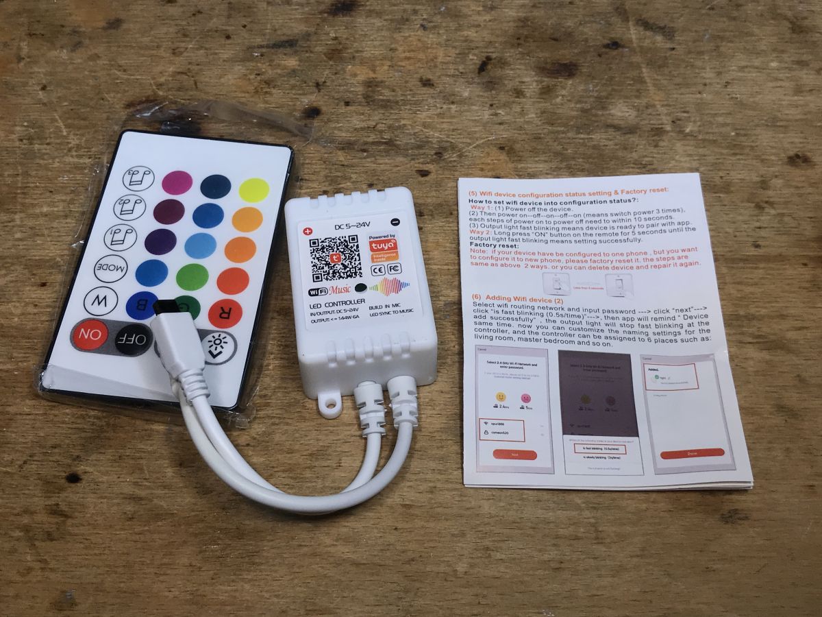

    Today, a short topic - the interior of a very cheap LED strip controller, available for purchase on a Polish auction website, offering WiFi control, remote control and playing to the rhythm of music. This time there will be a not-so-known WiFi microcontroller inside, the TR6260S1, which has only been mentioned on our forum only once or twice. At the moment, I don`t know if it`s possible to change the charge, but if I make progress, I`ll try to document what I found here.

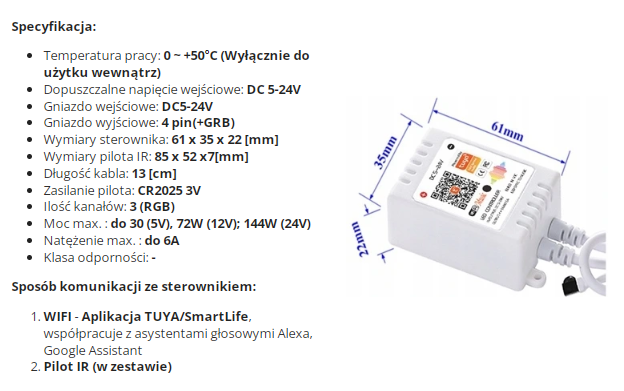

    Screenshot of an online auction displaying a music RGB LED strip controller WiFi SMART TUYA with a remote control and smartphone app.
    Specification:
    Image of a WiFi LED controller with dimensions and technical specifications.

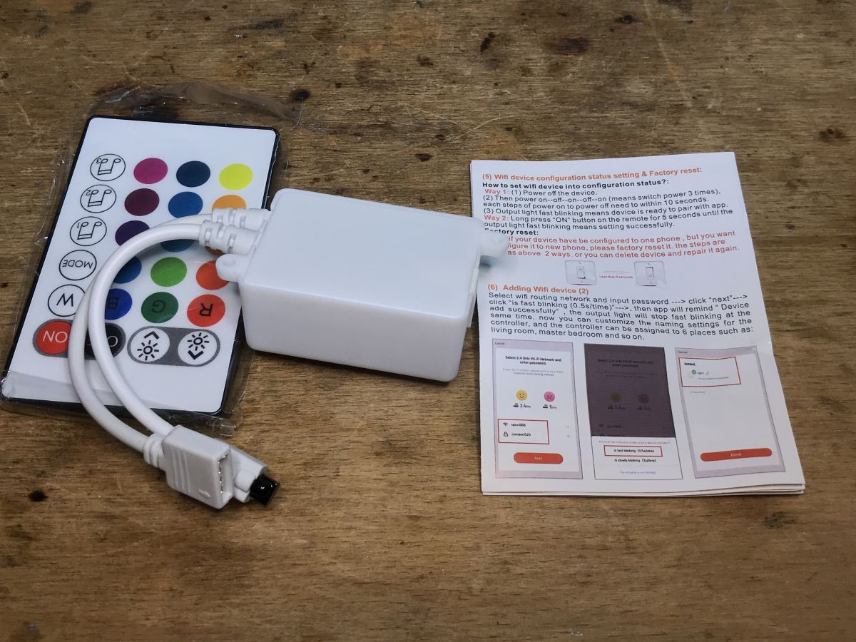

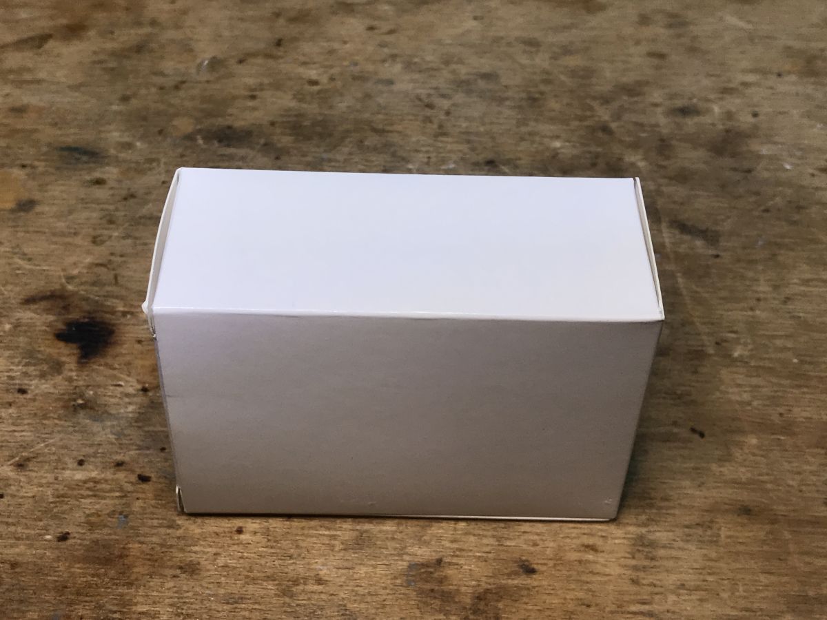

    There are no markings on the packaging:
    Opened package of LED strip controller on a wooden table. White box with the text LED CONTROLLER on a wooden surface. White box on a wooden background. White box labeled LED CONTROLLER.

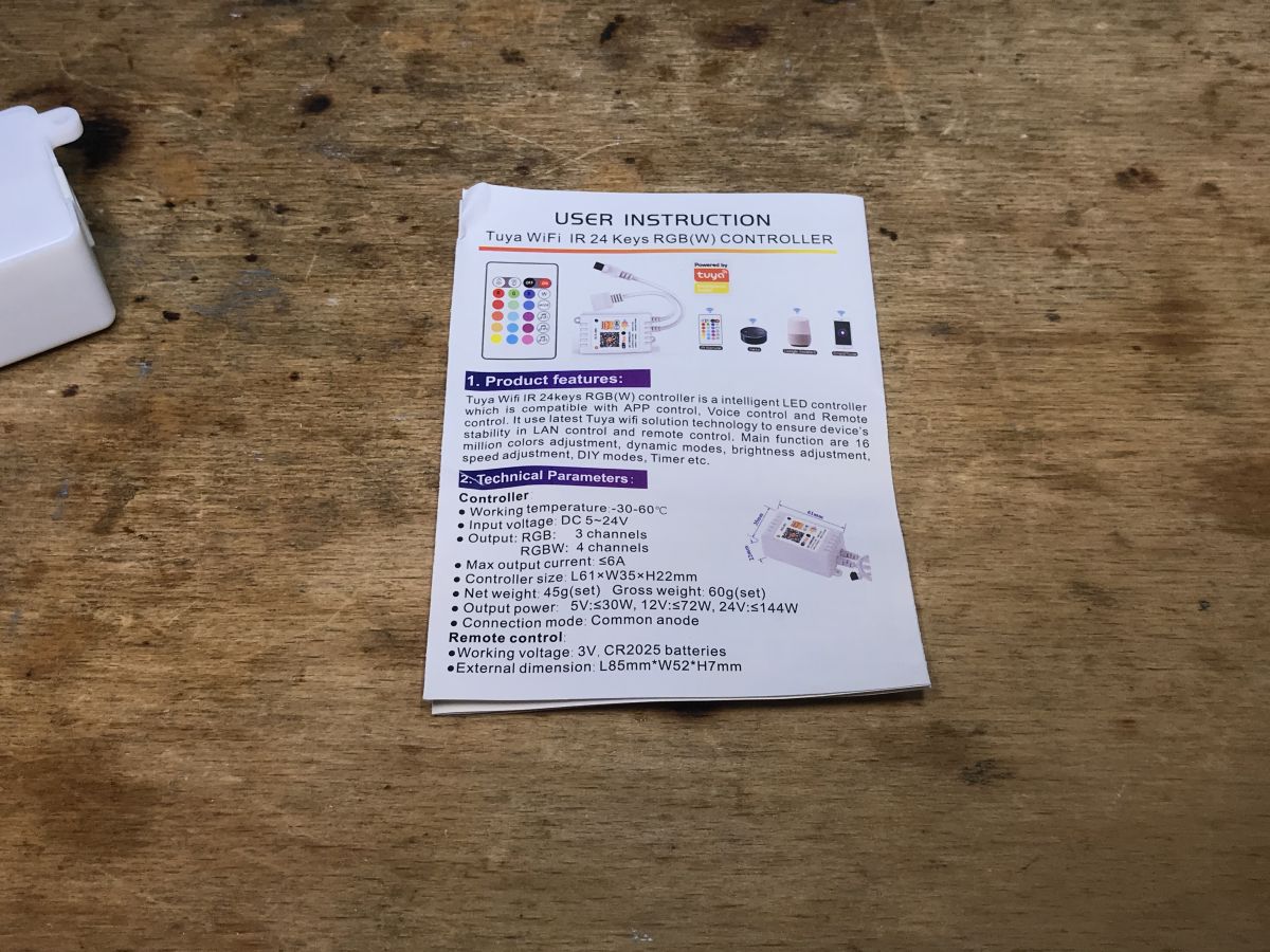

    The set doesn`t even include a strip of tape to attach the strap:
    LED strip controller with remote and instruction manual LED strip controller with remote and manual on wooden background User manual for the Tuya WiFi IR 24 keys RGB(W) LED controller.

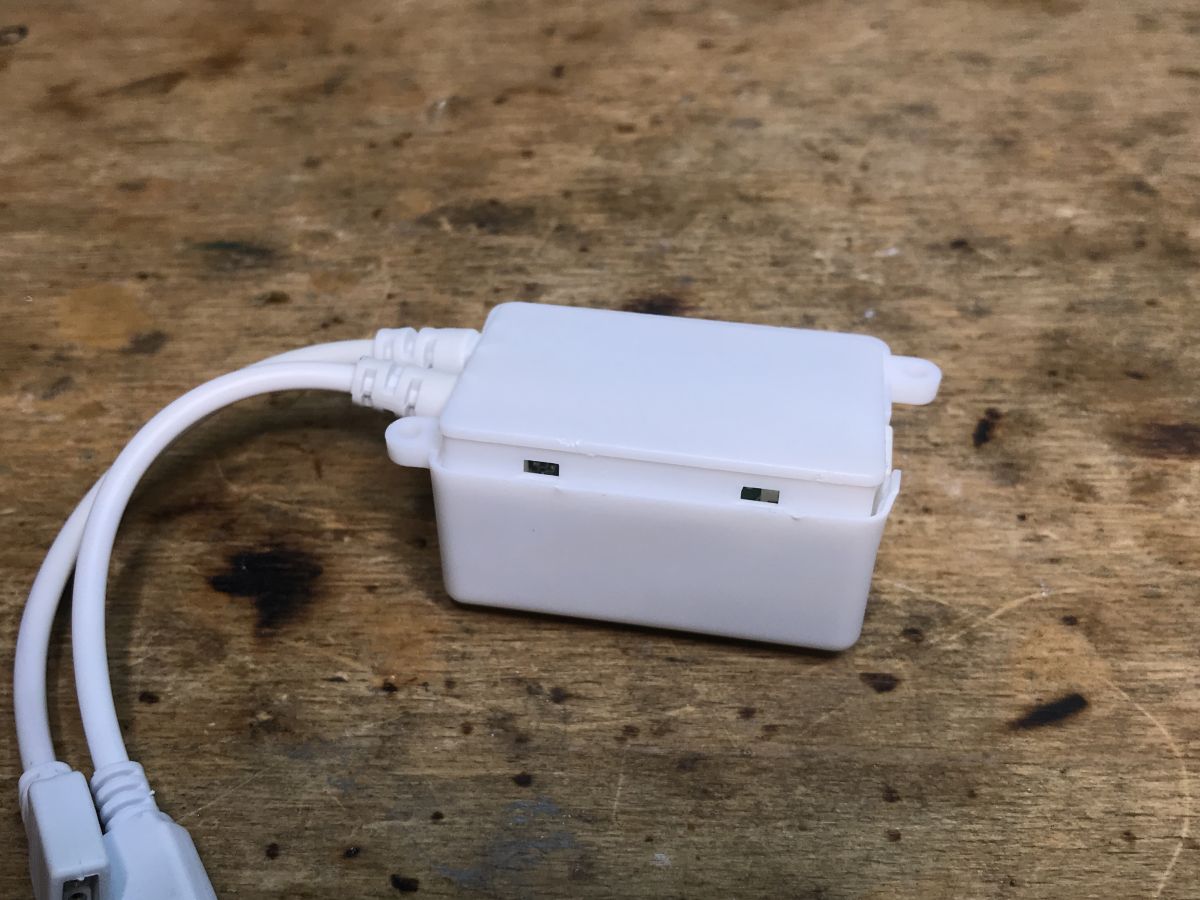

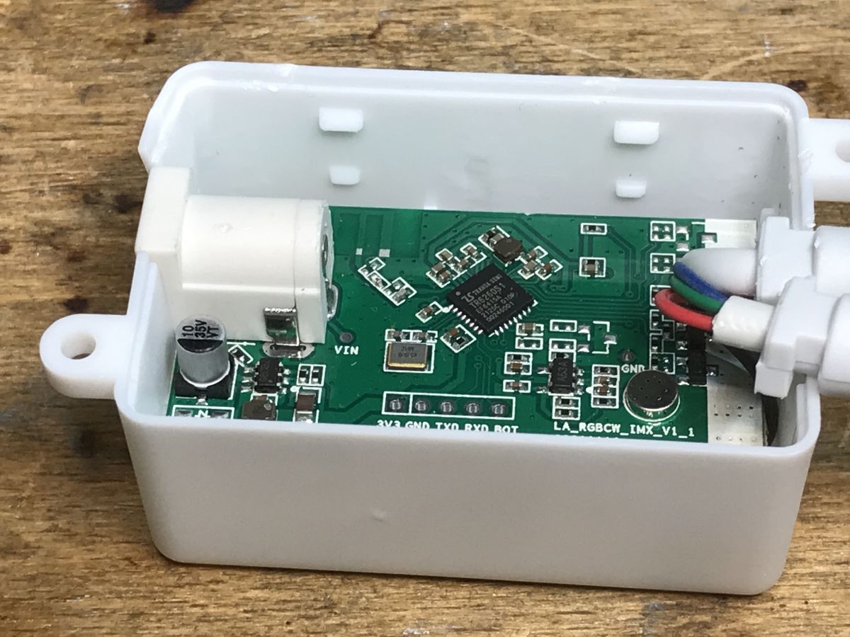

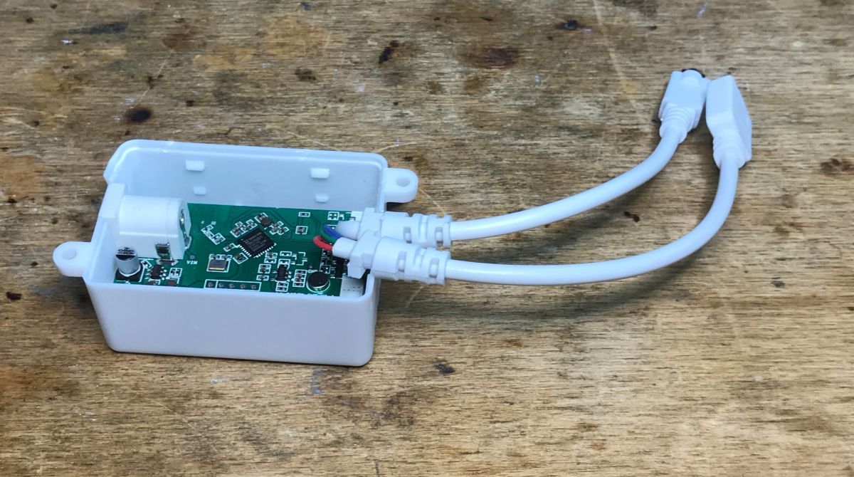

    The inside of the controller

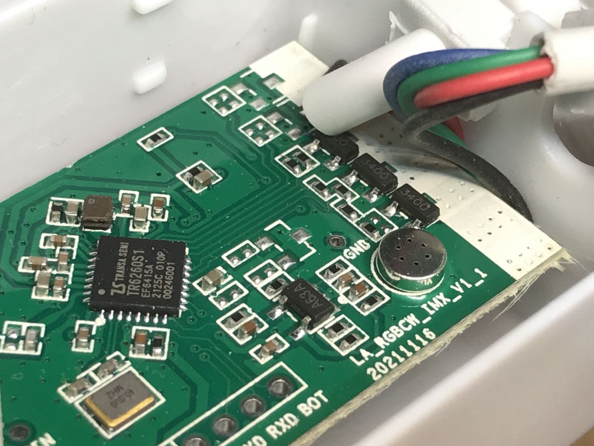

    We pry the cover and experience an unpleasant surprise - inside there is a very unknown microcontroller with WiFi:
    Interior of the LED controller with a microphone and TRS6260S1 chip. Small white plastic box with cables on a wooden surface. Interior of an LED strip controller showing a microcontroller and two output cables.

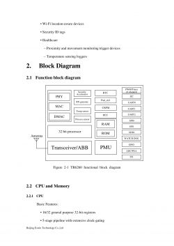

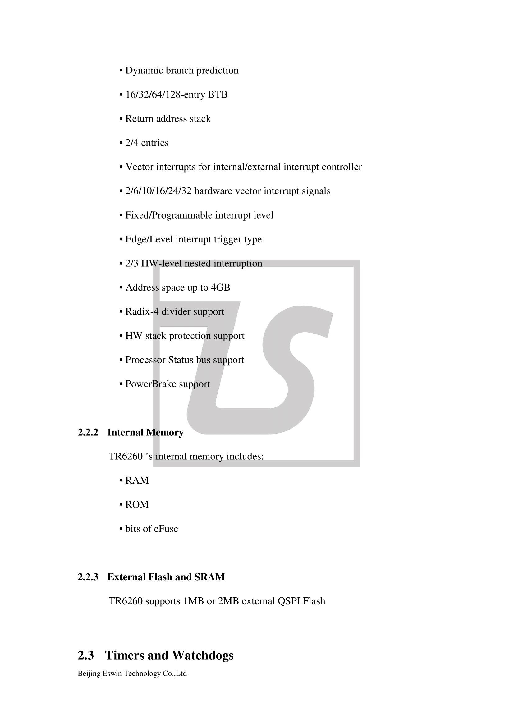

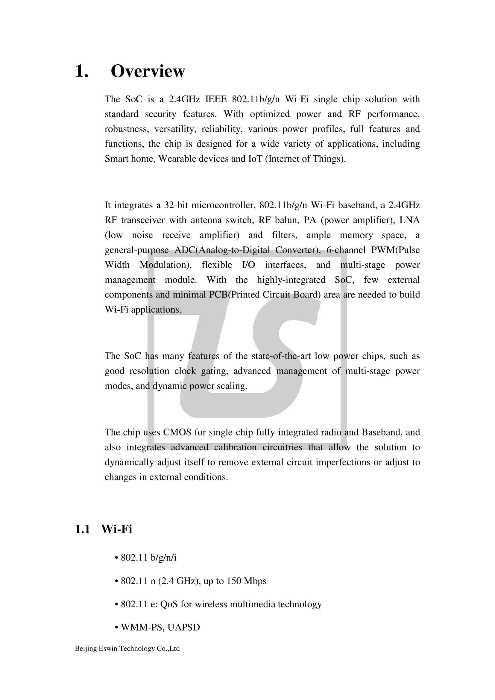

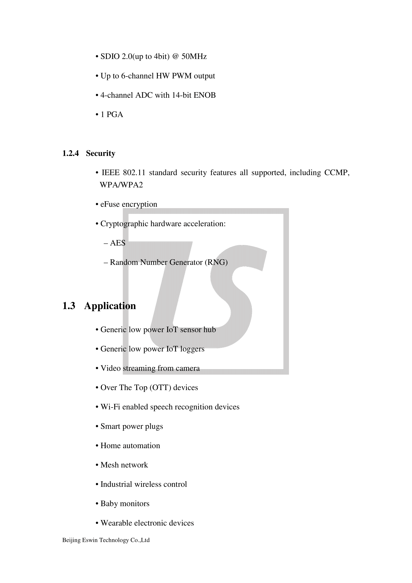

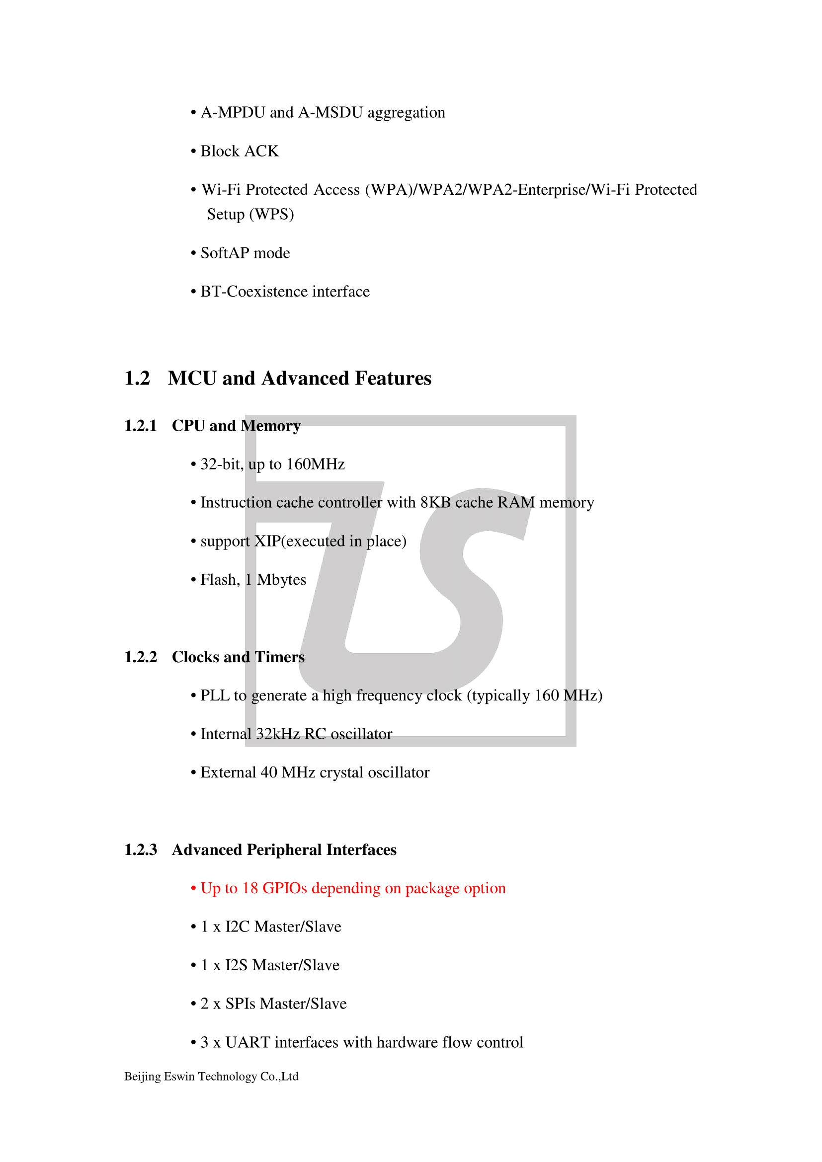

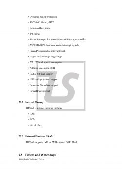

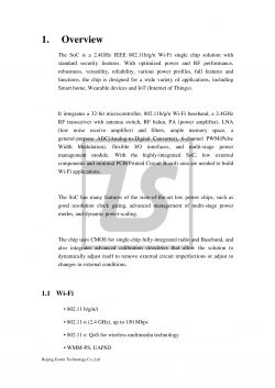

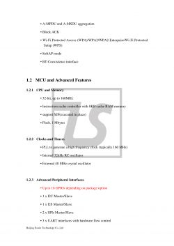

    TR6260S1... there is some information about it on the Internet:
    Fragment of a document describing the TR6260 SoC microcontroller. List of features of the TR6260S1 microcontroller in a PDF document. Technical specifications of the TR6260 chip with features and applications. Block diagram of TR6260 controller Technical specification of the TR6260 microcontroller.
    The pinouts are also described, and there is even some information about the boot mode that reminds me of ESP:
    Truth table of TR6260 functions

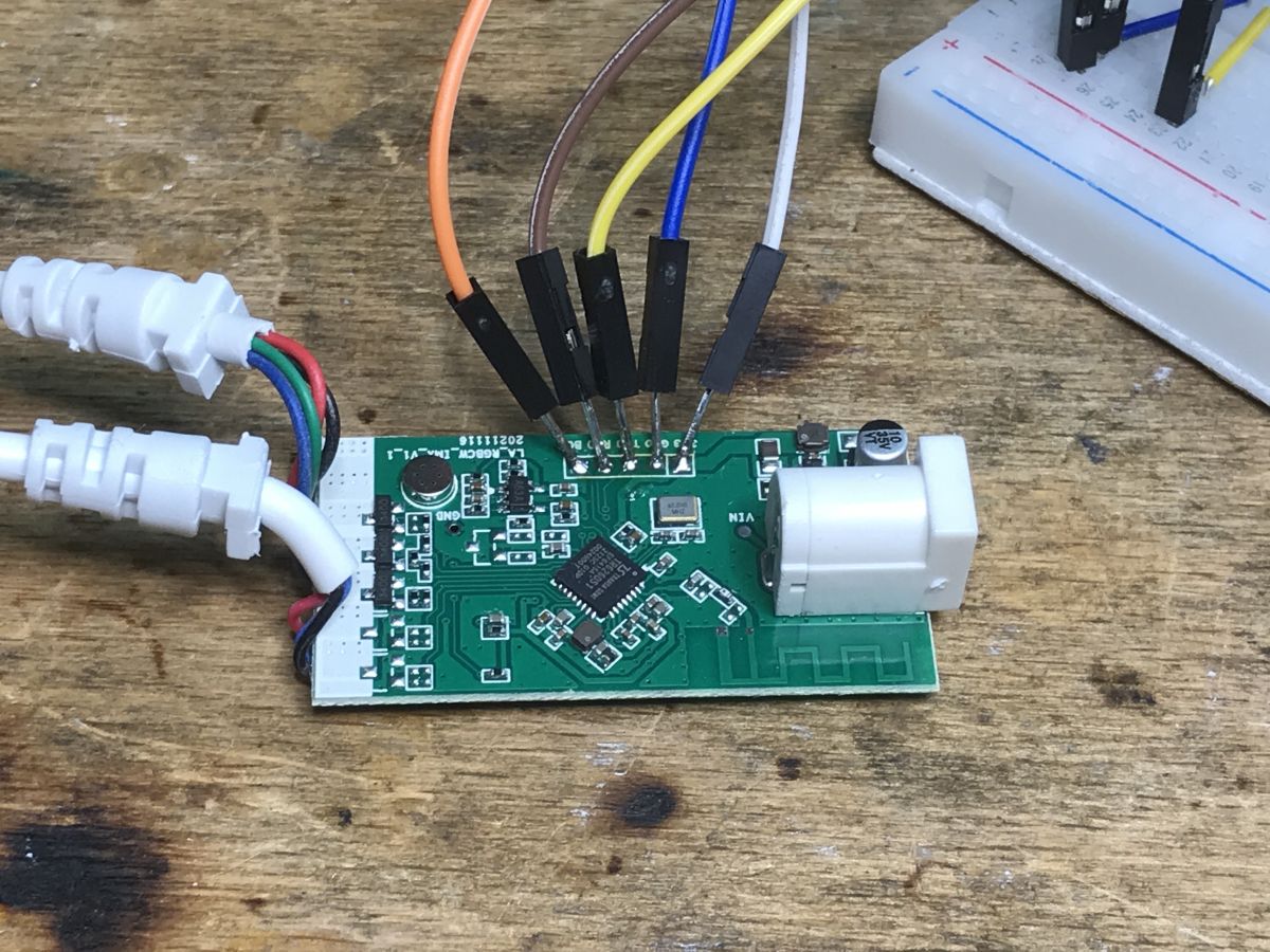

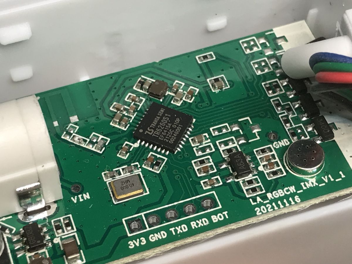

    There are RX, TX and BOT (BOOT) signals on the PCB. I experimented with them a bit, I tried using various programmers from the Internet, also using various similar exotic systems, and I even experimented with Esptool.py, but to no avail. It`s a different microcontroller.
    There is also a microphone on board, which means the strap can respond to sound.
    Close-up of a circuit board with a TR6260S1 microcontroller and a microphone. Close-up of the inside of an LED controller with TR6260S1 microcontroller Interior of LED strip controller with TR6260S1 microcontroller.

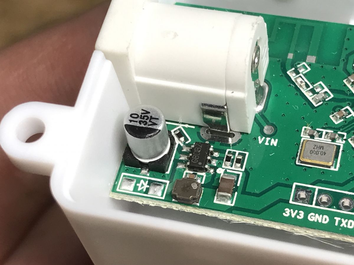

    There is a step down converter in the power supply block, because something must generate 3.3V for the WiFi module from the 12V we have at the input.

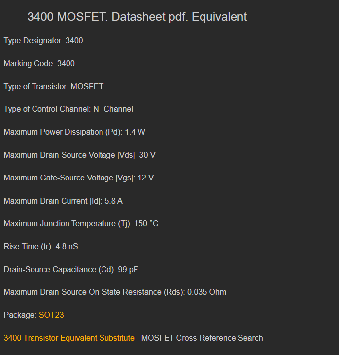

    The transistors have the SMD 3400 code, so probably:
    MOSFET transistor specification with marking code 3400.
    During experiments:
    PCB of LED controller with connected wires for testing. PCB with TR6260S1 microcontroller connected to a breadboard.

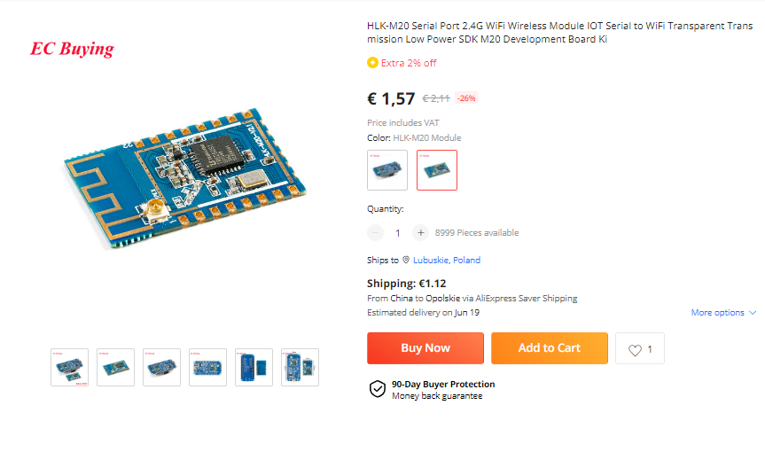

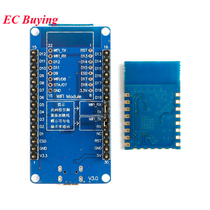

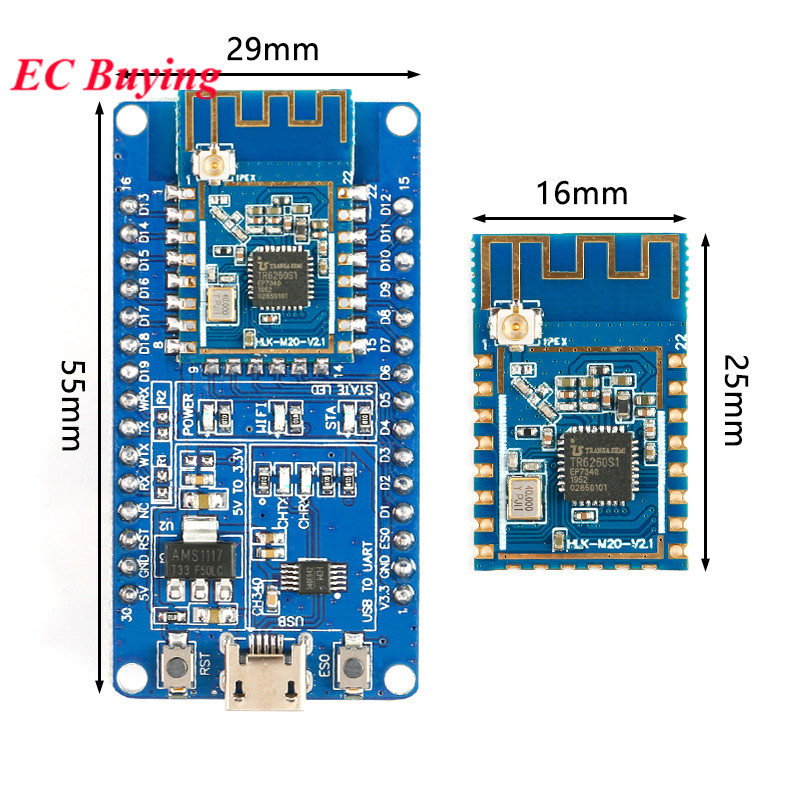

    Additionally, on Aliexpress, I found a development board with a similar module, but there was no information there about what tools can be used for this TR
    HLK-M20 Serial Port 2.4G WiFi Wireless Module IOT Serial to WiFi Transparent Transmission Low Power SDK M20 Development Board Ki
    Photos:
    Screenshot of an AliExpress listing for the HLK-M20 WiFi module.
    TR6260S1 WiFi module on a PCB.
    TRS6260S1
    Development board with TR6260 WiFi module on a white background. Image of two WiFi modules with the TR6260S1 microcontroller. Set of boards with a WiFi module and pin labels.
    Specifications of the HLK-M20 module with TR6260 chip.

    PS: Additionally, I have a feeling that considering the transistors inside, the 144W is a bit exaggerated, but that's already standard in these types of products...

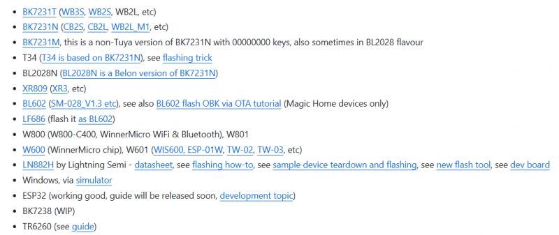

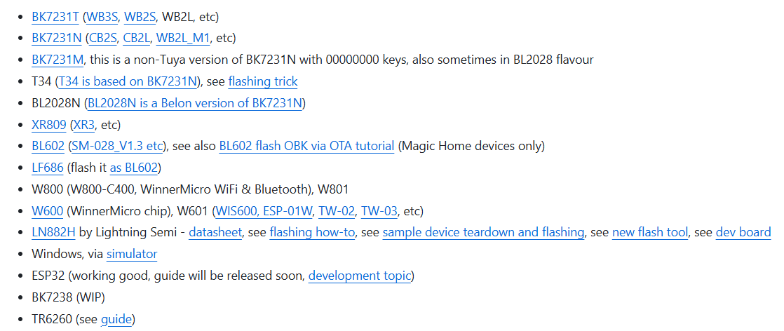

  • Pinned table of flashability and cloud support
    #2 20656591
    tmf
    Posts: 14318
    Help: 2090
    Rate: 2206
    Since you have already described a lot of different devices, some could be flashed, some could not, I have an idea. Maybe in the section we could permanently pin a post with a table - device + infor whether it is reflashable, and additional information - it works in the manufacturer`s cloud, works standalone, etc. This would be very useful for buyers. At the same time, it would promote knowledge about problems with such devices.
  • Existing device list already covers this controller

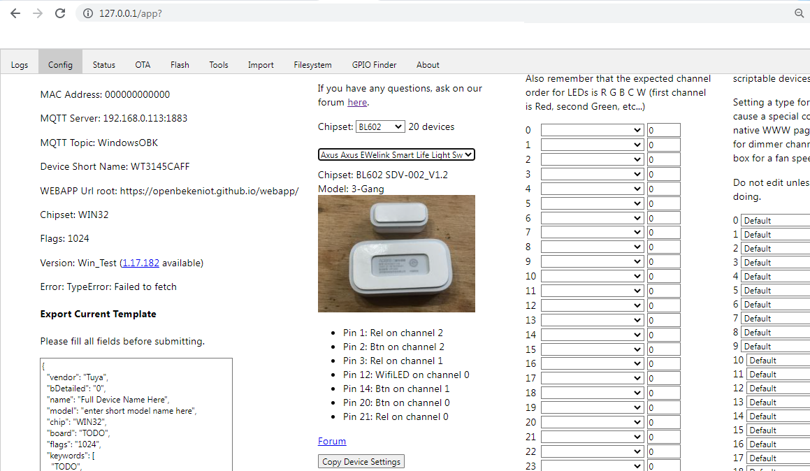

    #3 20656640
    Posts: 14791
    Rate: 12937

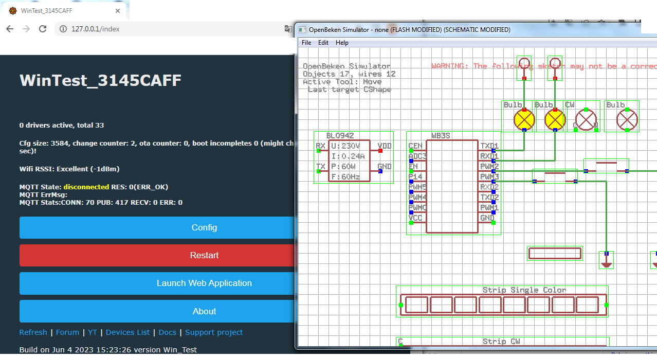

    It`s a good idea, but doesn`t something like this basically already exist?
    We have a topic:
    Global list of interior IoT devices (ESP8266, BK7231, BL602, W600, etc.)
    which basically links to mine electrode-friendly page/aggregator of links to Elektroda from Github:
    The list includes a convenient search engine (by model name, description and tags) for devices, shows one photo of the device and allows you to quickly find the appropriate topic on Elektroda.
    The list itself is made by the community, and its source can be found here:
    https://github.com/OpenBekenIOT/webapp
    more specifically, here is the "database" in JSON:
    https://github.com/OpenBekenIOT/webapp/blob/gh-pages/devices.json
    Anyone can open a pull request and add an entry, I try to do it myself from time to time to keep the list up to date. This topic will also be added to this list when I find some time.
    It is also worth noting that the mentioned list of devices includes both products supported by OpenBeken and those that are not yet supported. In the case of supported products, the list also offers access from the firmware level to be able to configure the device with one click:
    [TR6260S1 Transa Semi] Smart LED strip controller 144W 6A RGB, IR, firmware
    (sorry for the bad image of the device in the screenshot, I`m on mobile internet, everything loads slowly, there is a good image in the database...)
    This is a screenshot from Web App OBK, this is what access to the list of devices looks like in the firmware (or rather in the web app, but it`s not important). There are also links to the forum, to a topic discussing the device, etc.
    PS: Just as a curiosity, I would like to add that an attentive reader will note that in the screenshot there is a local IP address and there are mentions of Windows - this is not a mistake, my software simply supports Windows (together with all MQTT, etc.), and has a primitive simulator for Windows, which allows me to quickly test things even when I don`t have the hardware at hand. Below is a screenshot from the simulator:
    Spoiler:
    So, to sum up, the list is basically there and with a good search engine, the only thing you can think about is how to improve it (better interface, support status, etc.), because with the number of 366 entries (at the time of writing the post) it is simply necessary to keep it just posting on the forum would be impractical. The mini site on Github is better, and it still links to us (Electroda).

    Speaking of compatible hardware, it's time for a little update - TR6260 is newly supported! . You can flash.
    Details:
    How to sflash the TR6260 with open source software? Guide, pinout, booting .
    List of compatible hardware, as at 17.12.2024:
    List of devices compatible with open source software, including TR6260. .
