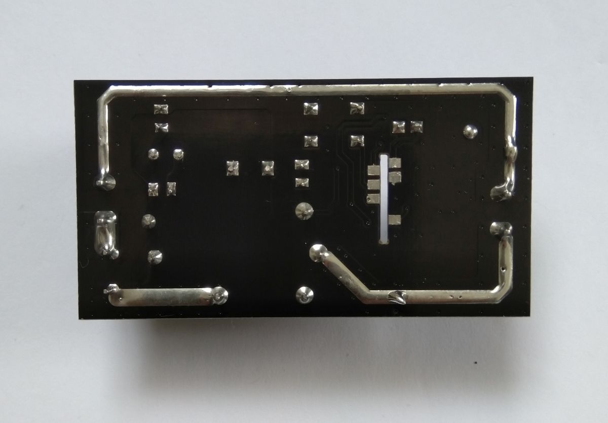

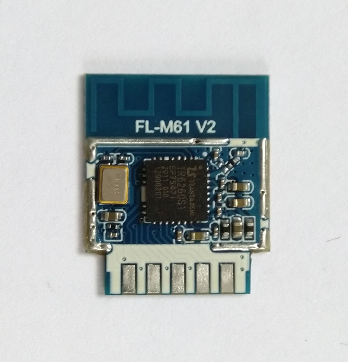

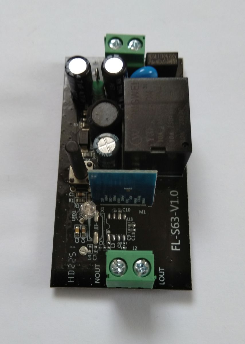

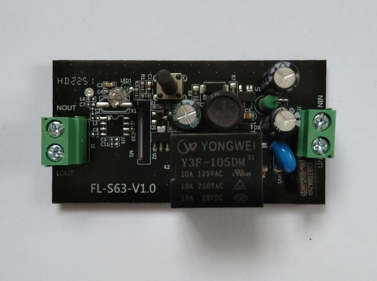

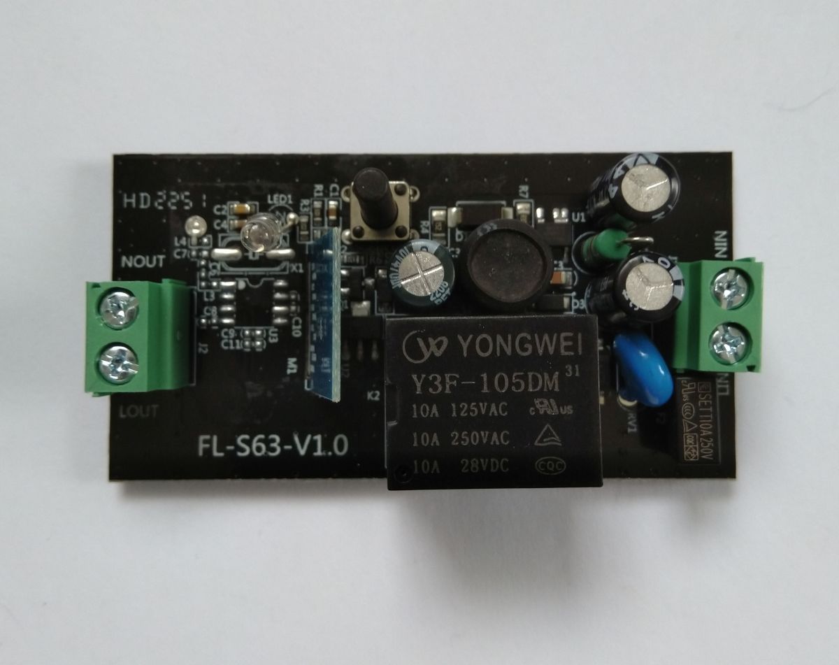

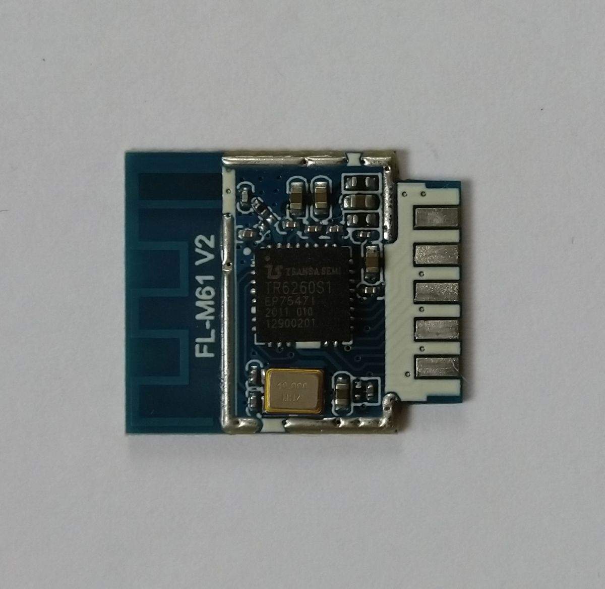

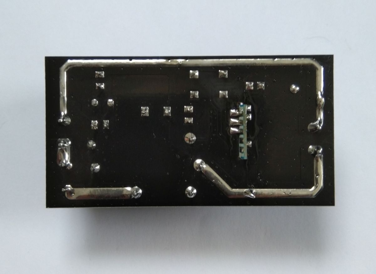

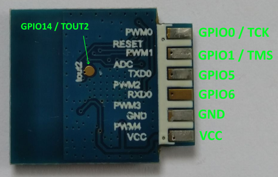

    Hello, I own the relay shown in the pictures. I have soldered out the WiFi chip to show it and to try to change its firmware. Now the question is how and with what to go about this? I am doing this for the first time I can't find any information on this. Is it possible to upload Tasmota or SUPLI? I am interested in what can be uploaded here, not a replacement for another chip. USB to TTL I have a YP-01, thank you in advance for any hints.
    Board:
    [TR6260S1/FL-M61 V2] WiFi Smart Switch how to change the firmware? [TR6260S1/FL-M61 V2] WiFi Smart Switch how to change the firmware? [TR6260S1/FL-M61 V2] WiFi Smart Switch how to change the firmware? [TR6260S1/FL-M61 V2] WiFi Smart Switch how to change the firmware? [TR6260S1/FL-M61 V2] WiFi Smart Switch how to change the firmware?
    WiFi chip:

    Hello, I'm afraid this is a completely new chip, which hasn't appeared even once on our Electrode list yet:
    A quick search on Github also shows that there is no SDK for it, or at least that's my impression.
    EDIT: This is the only result from the Github search:
    https://github.com/Akeeta/Akeeta-SDK-TR6260
    but very poor there...

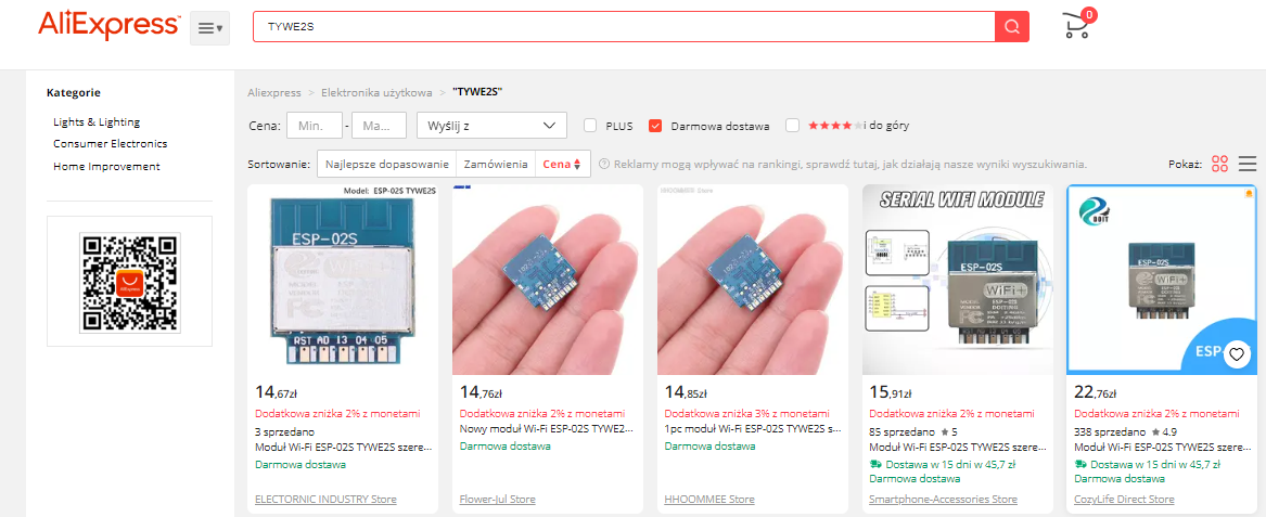

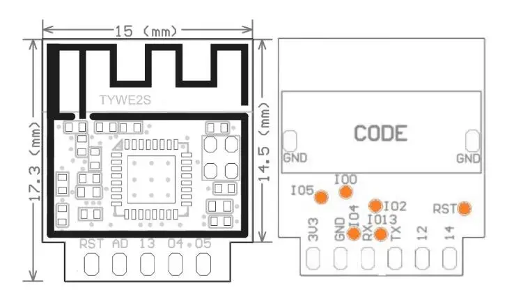

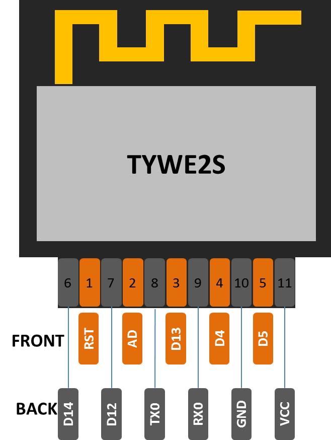

    At this moment I don't see the possibility to change the firmware of this module. The only thing left is to check the pinouts and do a replacement with ESP02S or similar (pinout equivalent of TYWE2S, WB2S, CB2S...)
    https://templates.blakadder.com/ESP-02S.html
    This module can replace modules such as: CB2S, FL_M99_V1, TYWE2S, TYZS6, TW-02, WR2, WB2, WBR2, WR2E, WB2S, WA2, XT-BL02
    Of course when replacing you would also have to check that the pins match for sure, paying special attention to RST and so on.
    You can keep the old WiFi module, maybe you can find an SDK or something new will appear.... you can also try to connect to it with the UART and at least collect its log (if it prints any log on the UART), I don't know, but in the log maybe there would be some additional information about the SDK used.

    @dawkoh there is now a backup and flash tool and an OpenTR6260 firmware that can be flashed to these modules.
    If you're able to follow the new guide to back the existing firmware, that would be very useful.

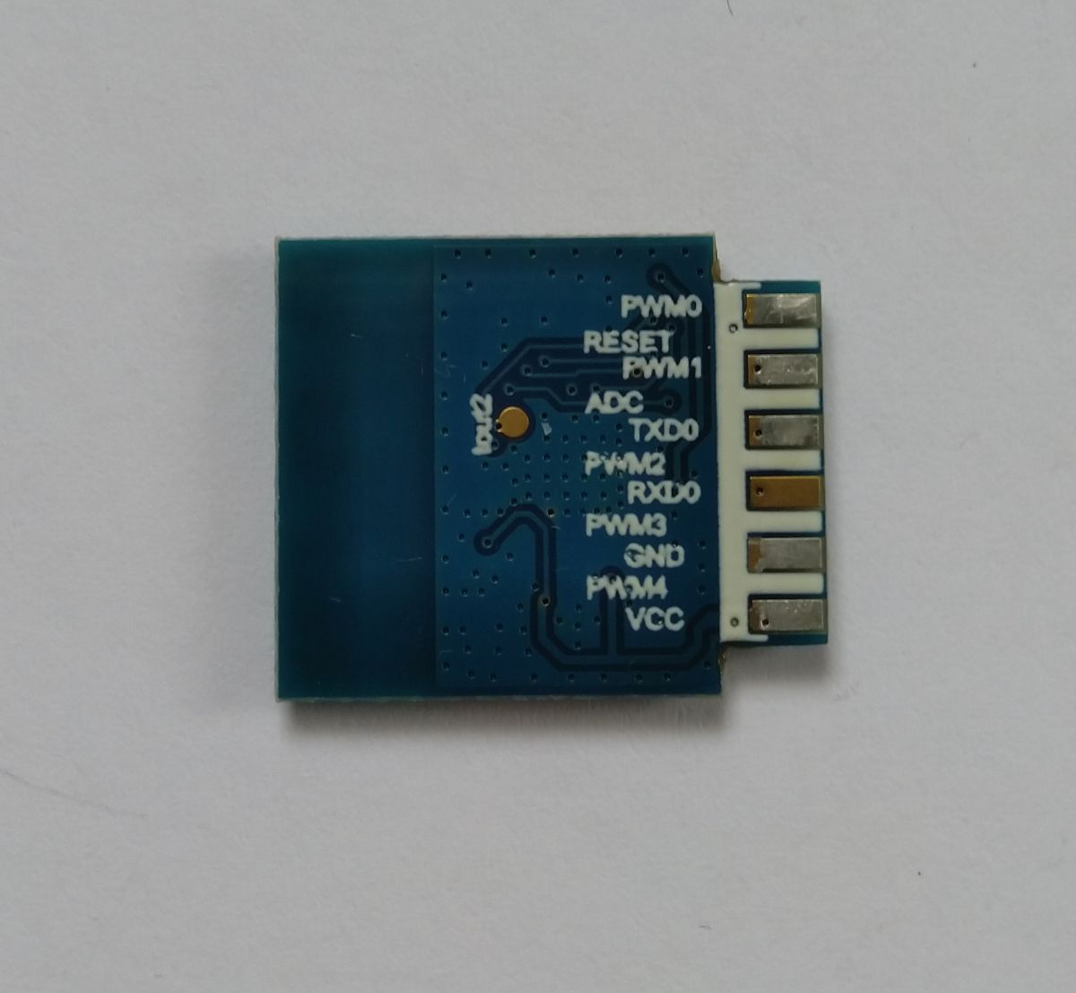

    >>21400373 Hello my friend . Have the same chip on my bench soldered and i am trying to dump the firmware. Can you tell which is the fp14 pin from the schematics in order to enter dump mode ?
  • #5 21846431
    Posts: 5213
    Help: 446
    Rate: 914
    to confirm, you have an FL-M61 V2 module, exactly as seen in the first post?
    Added after 46 [minutes]:
    if so, I don't have this module to be 100% sure, but I think this is true:
    Blue PCB module with GPIO labels and right-side connector; green text lists GPIO0, GPIO1, GND, VCC
    Added after 30 [seconds]:
    obviously, please take a backup first :)

    Needed a clarification . In order to enter uboot-uart mode should i solder GPIO14/TOUT2 to ground or vcc and powerup ?
    GPIO14/TOUT2 needs to be grounded at power-on
    https://www.elektroda.com/rtvforum/topic4093752.html

    >>21846810 So if i am not wrong its ground to GPIO14/TOUT2 and boot . Tried and can not enter uboot-uart . Will check again the uart logs .

    with IO14 grounded at power-on and if you watch TX at 57600 baud you should see this printed
    Terminal screenshot: “[L] entry BootRom” and “[U] uart boot mode”, baud rate 57600
    then you should be able to read/write/erase

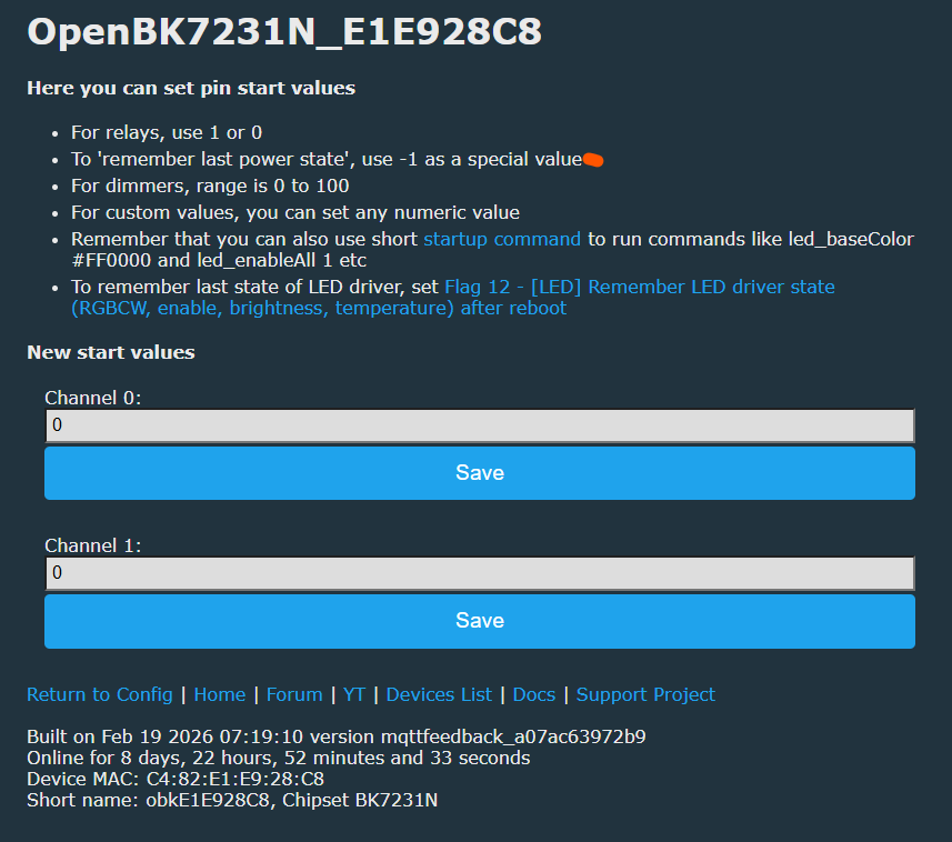

  • #20 21850658
    leon22heart
    Posts: 72
    Rate: 7

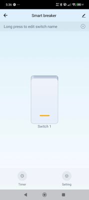

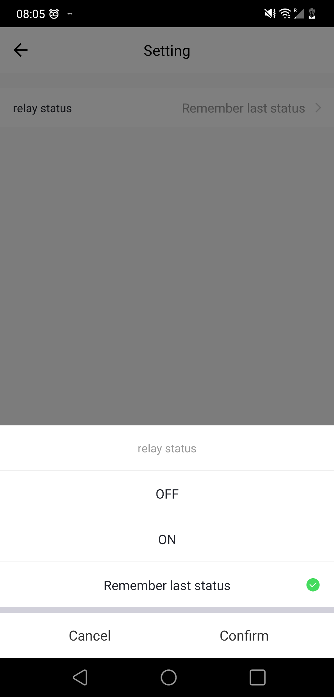

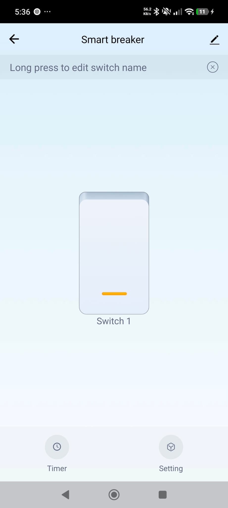

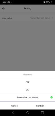

    >>21850654 the toflchanontogl isnt the equivalent of the relay remeber last status \ on \off ?
    This is a photo from my 2nd switch with the same chip. If i am wrong then the template is complete.
    Screenshot of “Setting” showing “relay status” options OFF, ON, and “Remember last status” selected
  • #21 21850665
    Posts: 5213
    Help: 446
    Rate: 914
    ah I see. I think that function is served by setting -1 as seen in 'Configure Startup' for the channel required
