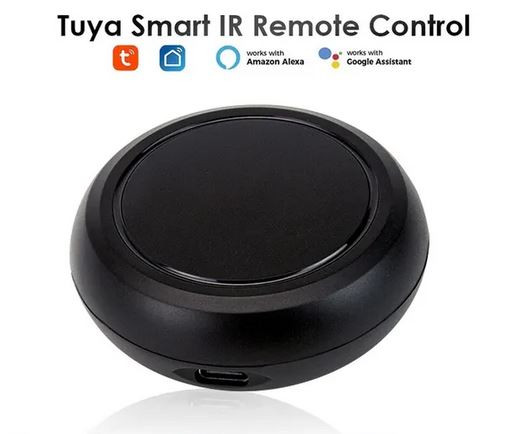

I bought an IRC03 Universal IR remote control from Aliexpress and would like to share my experience here:
Tuya Smart IR Remote with compatibility logos.
Tuya Smart IR Remote Control on Aliexpress page.
https://aliexpress.com/item/1005005942152298.html
The device itself is small, very well designed and comes with a USB C cable. It illuminates the room well in all directions with its seven ir leds.
Universal infrared remote control set with a USB-C cable and manual. Universal IR Remote IRC03 with USB-C Cable and Manual Back of a universal infrared remote control with technical specifications visible.
