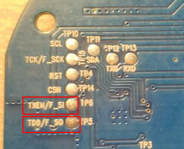

  • Well-labelled test pins on the back expose flashing access, and the pin map lists IRSend on 7, IRRecv on 8, Btn24, and WifiLED.

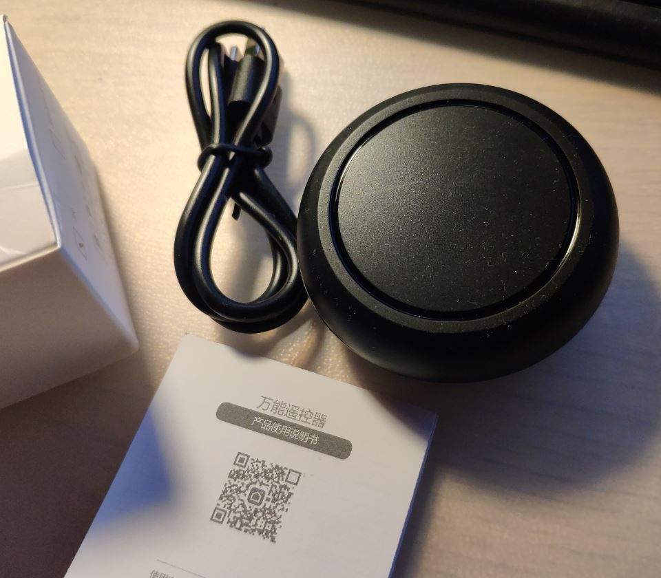

    The device itself is small, very well designed and comes with a USB C cable. It illuminates the room well in all directions with its seven ir leds.
    Universal infrared remote control set with a USB-C cable and manual. Universal IR Remote IRC03 with USB-C Cable and Manual Back of a universal infrared remote control with technical specifications visible.
    This is the information on the packaging and in the instructions (There also seems to be a version with an integrated thermometer and humidity meter.):
    Photo of packaging with a QR code and iOS and Android labels. IR remote packaging with informational symbols. Information on the packaging of the Tuya WiFi Smart IR Remote Controller IRC03. Product specifications on the packaging of a universal infrared remote control.

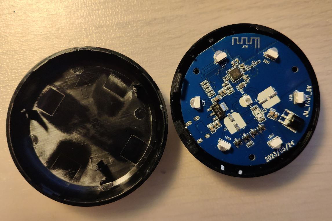

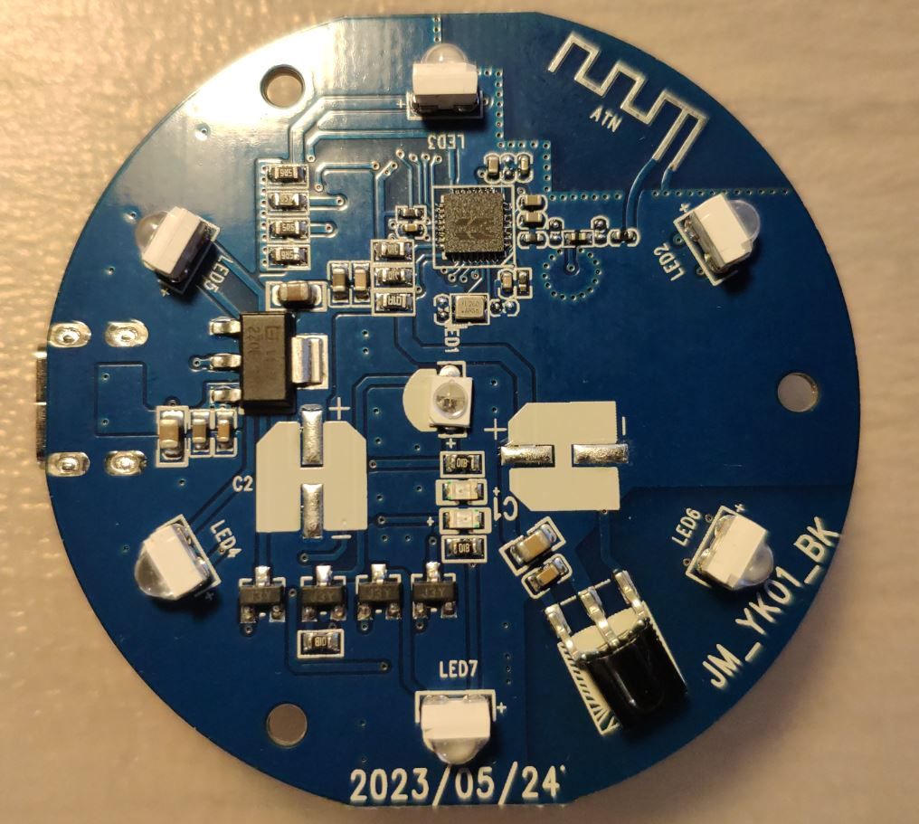

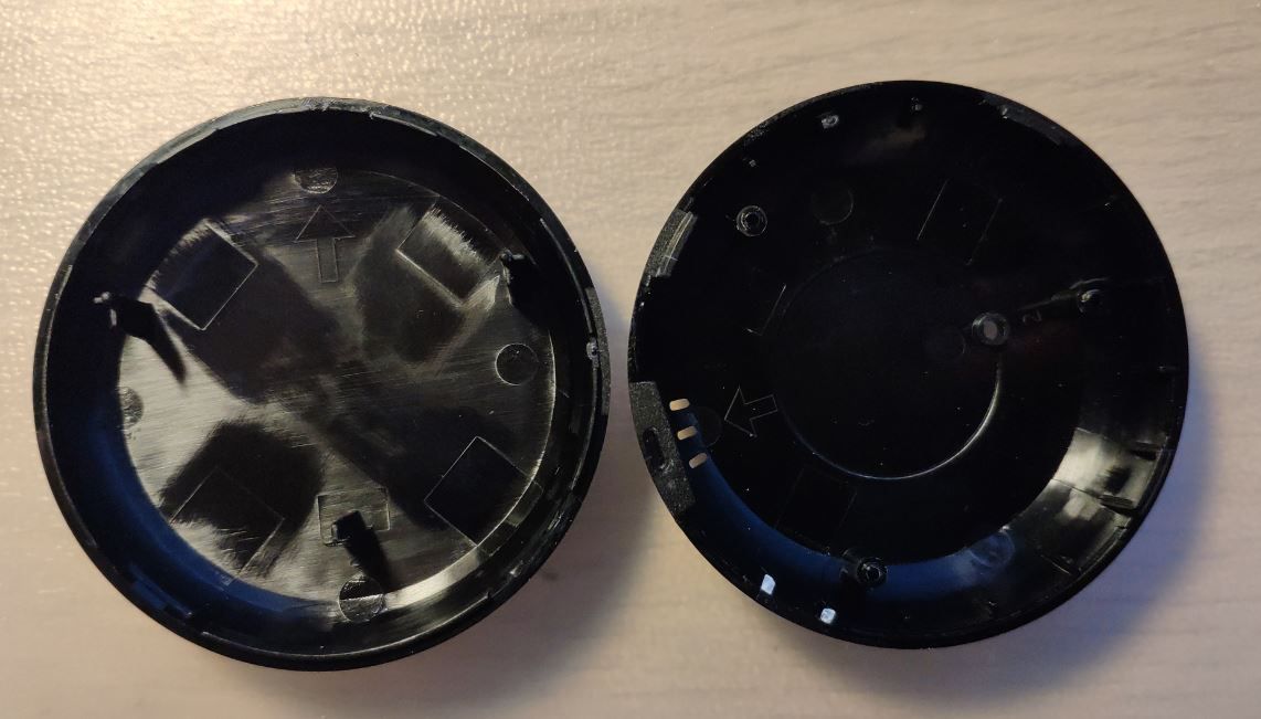

    The housing is easy to open, but care must be taken as the latches (four) can easily break off.
    Two black circular case components with holes and notches. Photo of an open IRC03 Universal infrared remote control, showing the circuit board and interior casing.

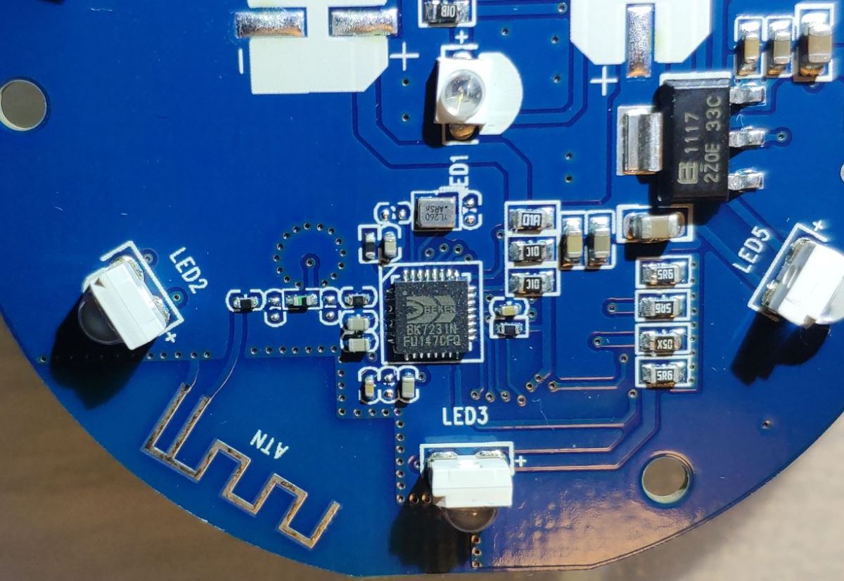

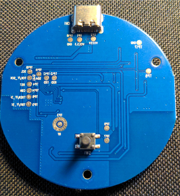

    The device differs from the other documented types. It has only one circuit board and the SoC is soldered on directly without a breakout board:
    Circuit board with electronic components and LEDs. IRC03 Universal device circuit board with visible pin labels.
    As you can read on the ic, it is a BK7231N. Flashing Open Beken works without any problems. Contact is made via well-labelled test pins on the back of the board.
    Close-up of the circuit board of the IRC03 Universal remote with visible BK7231N chip. Interior of IRC03 universal remote with visible PCB and connected wires.
    The Pin layout is as follows:
    PinSetting
    7IRSend
    8IRRecv
    9Btn
    24WifiLED
    Configuration:
    Apart from the slightly different board, it is easy to get the device up and running with Open Beken and connect it to HA. Thanks to the easily accessible TP, everything is without any problems. The pins were quite easy to guess. Everything works as with the existing IR devices.

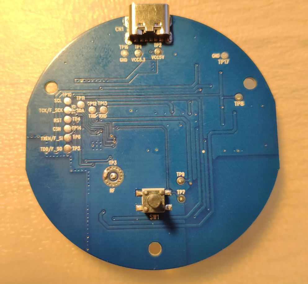

  • RST test point used as CEL reset pin
    #4 20948893
    iff7378
    Posts: 10

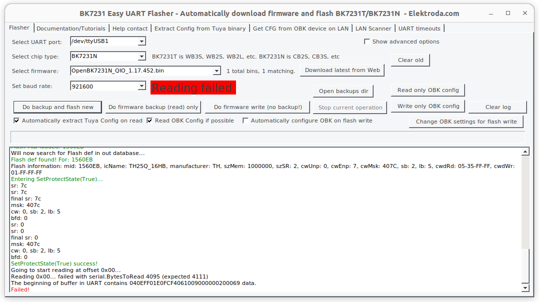

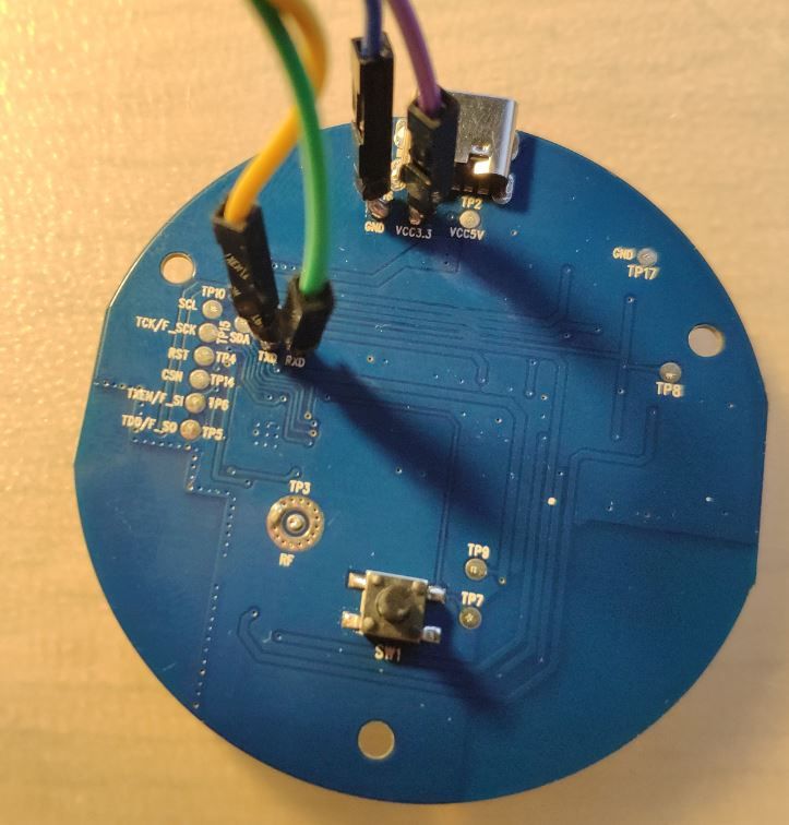

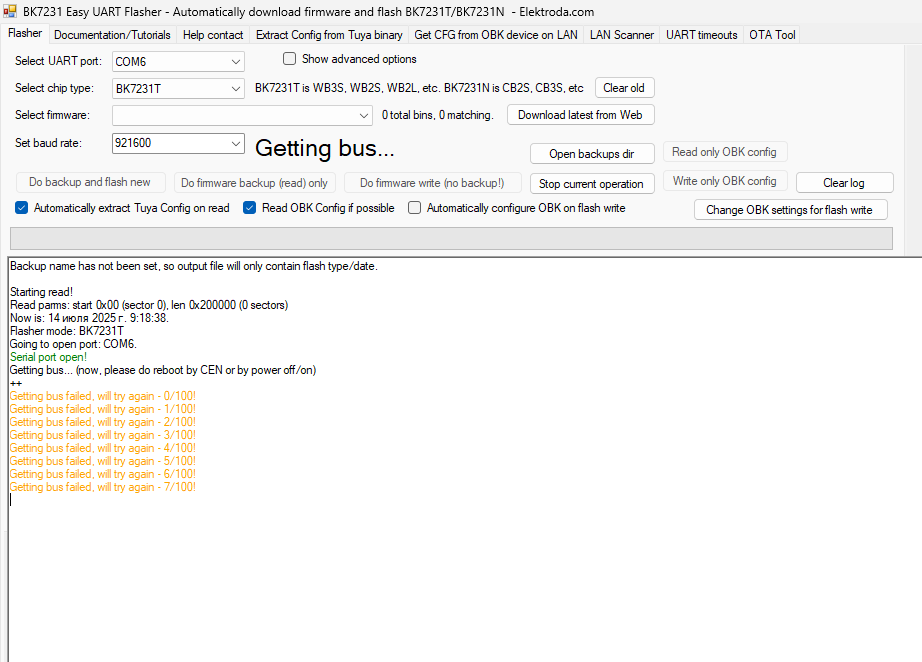

    I just got 3 of these from Aliexpress and am struggling to flash it. I cannot get the Easy UART Flasher to get the bus. Running on Ubuntu, the flasher works great with Mono.
    I have been powering it from the USB C port and just connecting TX and RX to my programmer. I was expecting just to power cycle it by unplugging and reconnecting the USB power.
    Then I tried soldering to GND and 3.3v. Somehow simply soldering the wires to the test ports made the voltage regulator get super hot. I am certain i didn't short the 3.3V and GND pads together, but I mustve done something bad.
    Tried the second one, no luck through USB power. Soldered wires to its 3.3v and GND pads then connected it to the programmer. When trying to power cycle, as soon as I connect the 3.3v line to the programmer, it dies for an instant and the Flasher loses the serial connection. I've used this programmer to flash Tasmota a different IR device with an ESP chip and it worked great.
    These boards don't have a pad for CEN so I don't think I can do that method. Any ideas would be great. I can't figure out why powering it from USB doesn't work.
    Added after 1 [hours] 24 [minutes]:
    Screenshot of BK7231 Easy UART Flasher program showing Reading failed error.
    Success kinda...I got the bus connected. The RST test point is the CEL pin so I used that to reset the chip.
    But now its unable to read the firmware on the chip? Tried all 3 baud rates with no success. The slower baudrate, 115k didnt work with the same failed to read. The faster one wasn't able to set the baud rate.
  • #5 20950309
    Posts: 14755
    Rate: 12879
    Hello @iff7378 . I haven't tried the flasher on Mono. Please try hid_download_py approach:
    Added after 21 [seconds]:
    https://github.com/OpenBekenIOT/hid_download_py

  • Investigating SI/SO pins for WS2812B output
    #8 20974443
    jkwim
    Posts: 186
    Rate: 25
    I have the same product with the same PCB version.
    Just that the screen printing is messed up (text reversed)
    Yours:
    Round printed circuit board (PCB) with various pin labels and components.
    Mine:
    Blue round circuit board with USB-C port on top and a button at the bottom.

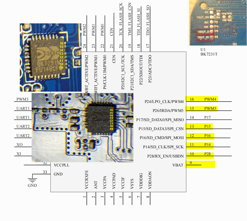

    Having seen the letters SI & SO clearly, I began to investigate more as these could be the MOSI and MISO pins.
    Photo of the back side of a PCB with reversed silkscreen text.
    Recently there was an updated discussion about using MOSI pin for driving WS2812B LED strip.
    So I was interested in finding out whether this IR device also can work as a WS2812B LED Driver.
    Read more here.
    This is my attempt to map the connections from the chip side:
    Diagram and photos of PCB with highlighted pins of the BK7231T chip.
    However so far I have not been able to establish the connectivity to the Test Pad using continuity testing.
    This is something that I want to pursue as then I can make this device also dual purpose.

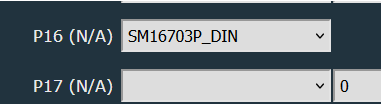

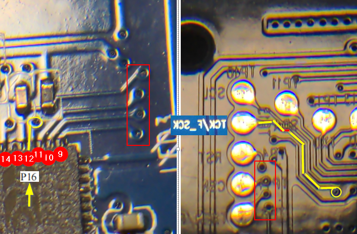

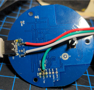

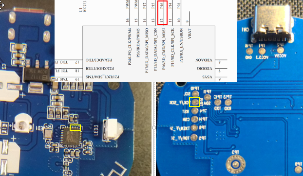

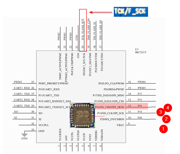

    I revisited the P16 issue hoping to connect some WS2812 LEDs to the unit.
    I was hoping to find a connectivity to Pin 12 of the Chip which is designated as P16
    PCB with a microcontroller and pin connection diagram, highlighting pin 12 labeled as TCK/F_SCK.
    I found that PIN 12 is connected to the pad labelled TCK/F_SCK.
    Close-up image of circuit boards showing PIN 12 and TCK/F_SCK connections.
    I verified the continuity between PIN 12 and this pad.
    Then I connected a WS2812 LED Ring as shown in the following picture:
    Close-up of the back side of a round printed circuit board with connected wires.
    Screenshot of a selection menu with two options for P16 and P17 in the interface.

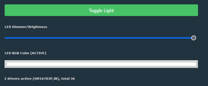

    The LEDs do not get lit up after loading the driver using command:
    startDriver SM16703P
    User interface for controlling LED lights.
    Wonder what am I doing wrong here.
  • #12 21201631
    Posts: 14755
    Rate: 12879
    See related topic:
    https://www.elektroda.com/rtvforum/topic4057187.html
    You need to at least have SM16703P_Init called as well:
    SM16703P_Init 16
    startDriver PixelAnim

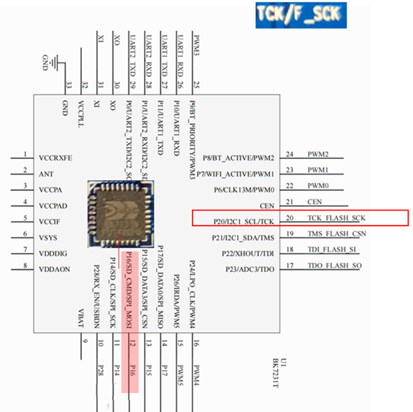

  • Pin 12 appears to map to TCK/F_SCK pad
    #13 21202017

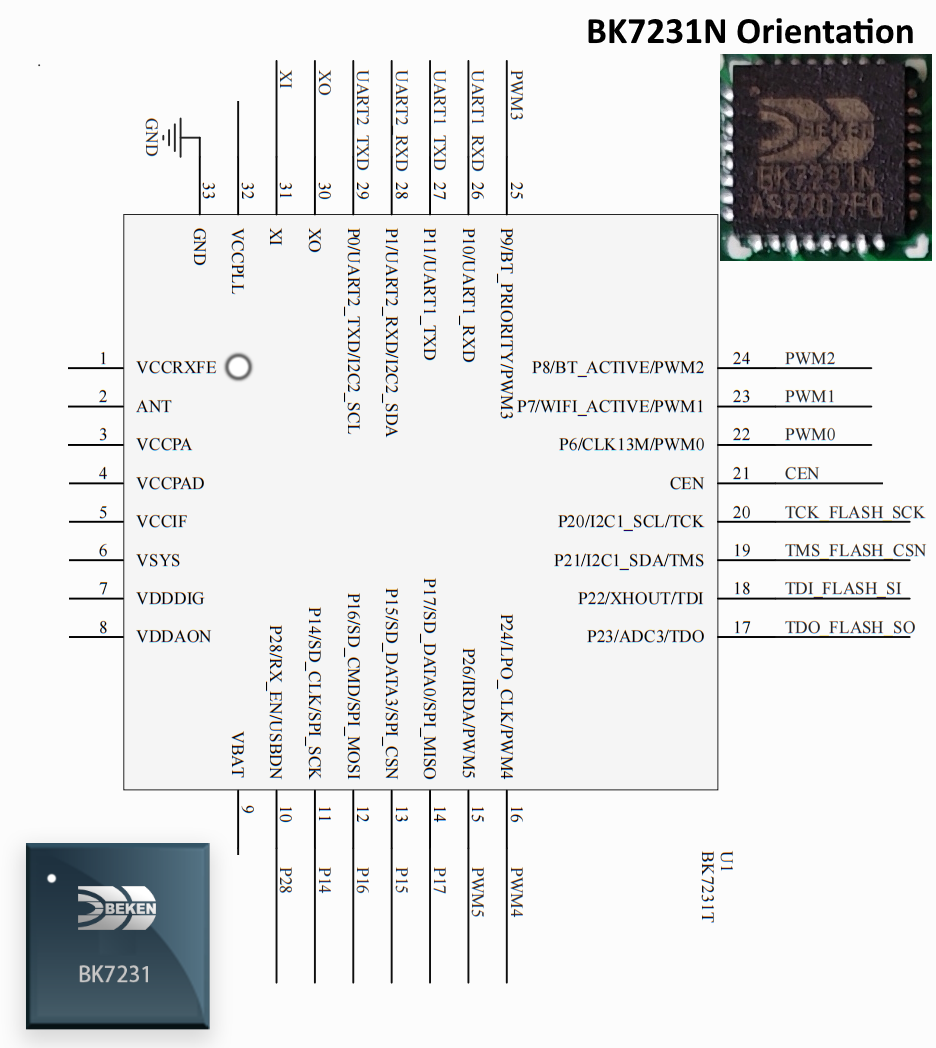

    jkwim
    Posts: 186
    Rate: 25
    Can you confirm whether my interpretation of pin layout is correct here?
    When I look at the chip orientation, PIN 12 is on to the right hand side, 4th pin from bottom.
    The screen print on the device (Which is anyway printed in reverse) designates the pad with TCK/F_SCK which happens to be the 4th pin on the top edge of the chip if counted from left.
    Chip pin layout diagram with labels and highlighted pins.
  • Pin 1 is bottom left on the PCB
    #15 21202312
    jkwim

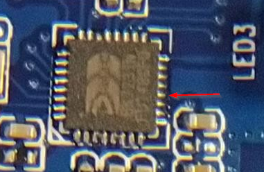

    Posts: 186
    Rate: 25
    divadiow wrote:
    because annoyingly that image is unintuitively oriented with pin 1 on the bottom left. I made the below for this thread/device https://www.elektroda.com/rtvforum/topic4066219.html
    Diagram of BK7231N chip orientation and pinout with a photo of the chip.
    Yes, I also figured it out the hard way now. So the PCB screen print is correct.
    PCB diagram showing pin labels and connection paths.
    Now I need to figure out how to solder a tiny wire strand on to PIN 12 as there are no connections from the chip for these pins.
    Image of an integrated circuit on a PCB with a pin marked by a red arrow.
    I have a fine tip soldering bit but never have attempted a job at this level before. Probably only a single wire strand will fit in there.
    Perhaps its not worth the effort.

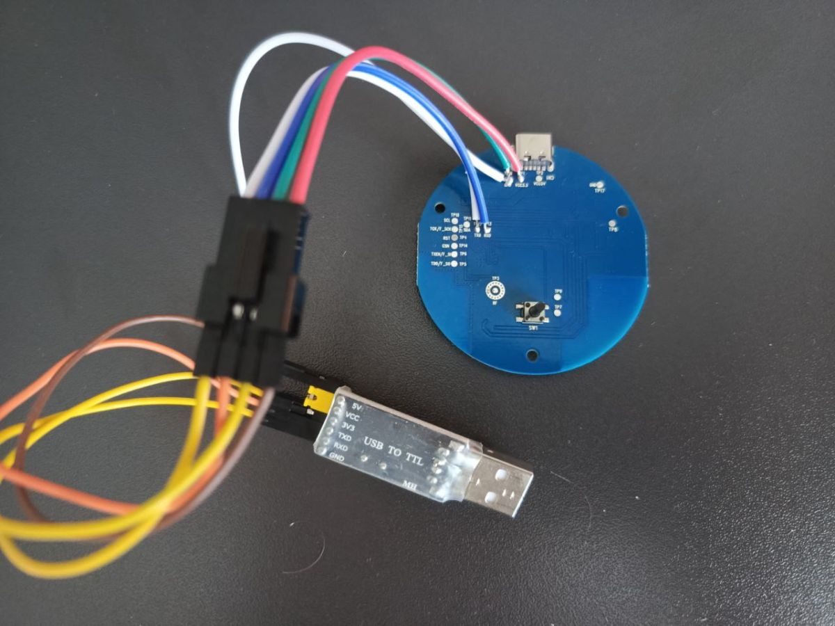

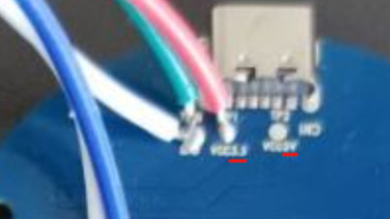

    Posts: 6
    Tell me how to make the board flash - I'm trying to connect the RST pin to GND, but nothing happens. There is no CEN pin
  • #19 21605824
    Posts: 14755
    Rate: 12879
    Hey, CEN is also called CSN, do you have CSN on your board?
  • CSN and RST pins not entering flash mode
    #20 21606092
    ghost320000
    Level 4  
    Posts: 6
    [postid:78e68777c0][/postid:78e68777c0] I have a CSN pin, and I also have a RST pin, but they don't work. I'm connecting via USB to TTL - GND - GND, 3.3V - 3.3V, TXD - TXD, RXD - RXD. When I connect like this, I can see the device on the COM port. Then, when I read, I short-circuit GND to RST(CSN), but it doesn't work. I've also tried turning the power on and off during reading/flashing. I used the following programs on Windows: BK7231Flasher and ltchiptool.

  • #21 21606137
    Posts: 14755
    Rate: 12879
    Ignore CEN/CSN and just use 4 wires to flash - while getting bus, disconnect power wire for a moment
  • #22 21606656
    ghost320000
    Level 4  
    Posts: 6
    >>21606137 I tried it, it doesn't work.
  • #23 21606662
    Posts: 14755
    Rate: 12879
    Is your chip BK7231T or BK7231N?
  • #24 21606685
    ghost320000
    Level 4  
    Posts: 6
    >>21606662 BK7231N
  • #25 21606687
    Posts: 14755
    Rate: 12879
    So, first of all ,why do you select BK7231T in flasher?
    Maybe you need to swap RX and TX?
  • #26 21606705
    ghost320000

    I tried different options BK7231T, BK7231N, BK7231M - did not help.
    If I swap RX and TX, I do not see the device on the COM port at all
  • #27 21606805
    Posts: 5209
    Help: 446
    Rate: 914
    are you powering whole device from USB-TTL adaptor?
  • #28 21606806
    Posts: 14755
    Rate: 12879
    It looks like he takes 5V from USB to TTL and plugs it into 5V lane of the device, which is okay?
  • #29 21606814
    Posts: 5209
    Help: 446
    Rate: 914
    hmm maybe. but this looks like VCC 3.3 is soldered up. VCC 5v is clear
    User Experience: Tuya WiFi Smart IR Remote Controller IRC03 [BK7231N] from Aliexpress
  • #30 21606836
    Posts: 14755
    Rate: 12879
    Oh no, he soldered 5V directly to 3.3V?
