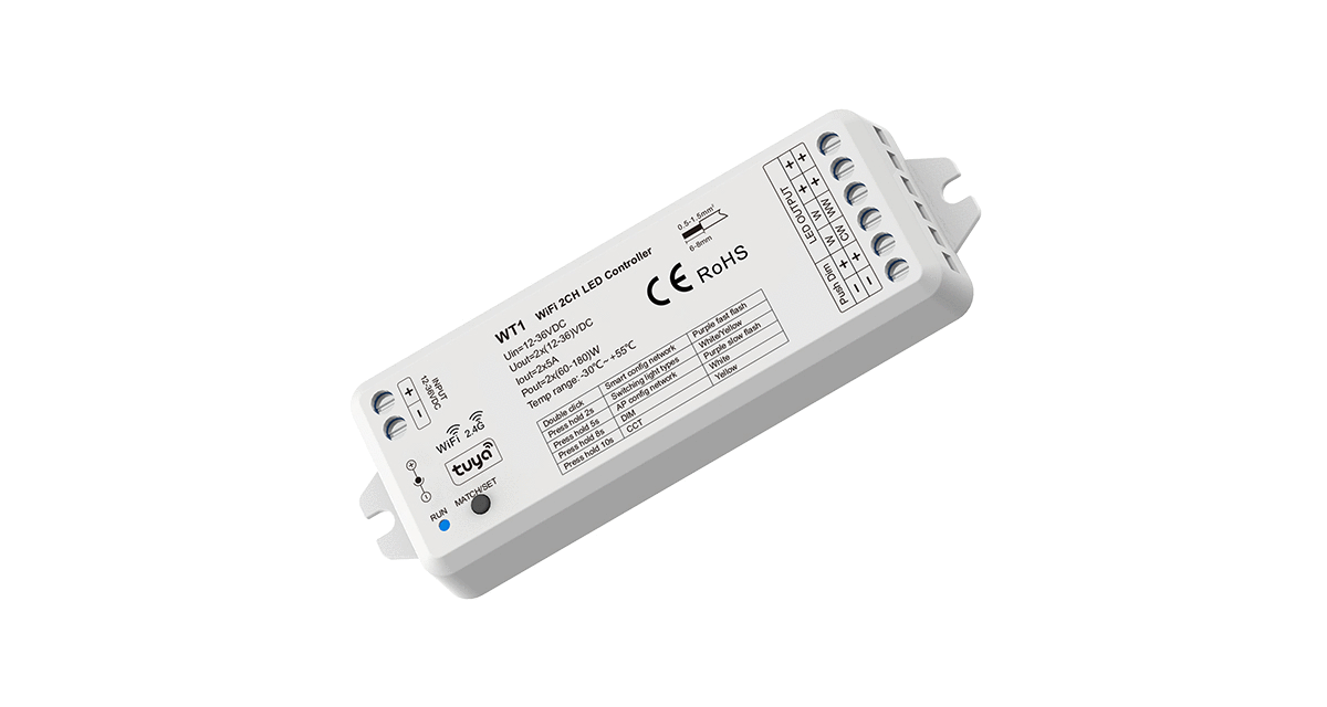

this is my teardown of the WT1 2 channel CCT LED controller. This is a device intended to dim WW/CW strips (CCT mode) but it can be also used as a 1 channel dimmer (DIM mode). One can control it using the Tuya app, dedicated remote control, or a physical push button.
The device is similar to the WT5 Multi-Channel LED controller described in a different Elektroda forum thread. But the whole OpenBeken installation process was not described step-by-step there so I thought I would cover that in this post.
The WT1 controller contains the WB3S chip which connects to WiFi. Additionally, there is also a chip labeled sc95f8615p. It is connected to WB3S via the TXD1 and RXD1 pins and communicates with it using the TuyaMCU protocol.
This latter Tuya MCU chip then controls:
- the PWM output for the LED strips,
- RF communication with the dedicated remote controllers,
- the physical button controls,
- and even switching between the CCT and DIM modes.
So by flashing the WB3S, we do not lose any of these capabilities and only get rid of the dependency on Tuya cloud.
My approach was to:
1) Disassemble the device, solder pins for flashing.
2) Flash OpenBeken firmware using a USB-TTL converter and the BK7231 GUI Flash Tool.
3) Configure the device using the web interface.

The disassembly is simple. The white case contains no screws and is held together by clips. Simply pry open the bottom part of the case and you can access the insides.
Image of Tuya's CCT LED Controller WT1 with visible labels and connectors.
Dismantling the LED controller WT1 using a tool.
(the second photo is illustrative, please unplug all connected wires before opening the case)

Note that this setup assumes that you switch to the CCT mode by holding the mode switch button for 10 seconds.
