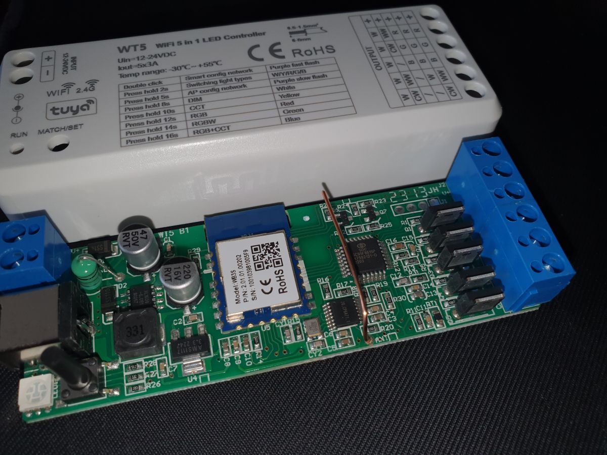

    I bought a "WT5" Multi-Channel LED controller with RF remote support, I am curious if flashing this would be supported as I cannot find any information on it whatsoever: https://www.aliexpress.com/item/1005003394879757.html
    Image of the WT5 LED controller with RF remotes and other accessories, displayed on an online store page.
    From my quick look at the PCB, it looks like it's using a WB3S for Wi-Fi, another chip which I couldn't find any information about (20_cp6a71.1) for RF, and both of them feed into a SOC SC95F8615 that controls the Mosfets. This is just me guessing, I have not actually traced/investigated things. Attached is a picture of the PCB.
    I do have a Logic Analyzer so I could take a deeper look into things if necessary.

    Hello, can you do a 2MB flash dump so we can at least tell whether it's a TuyaMCU or are GPIOs of WiFi module used directly?
    TuyaMCU uses UART1 port of WiFi module to communicate with secondary MCU. Are TX1/RX1 pins of WB3S connected somewhere?
  • TX1 wired to secondary MCU, RX unconnected

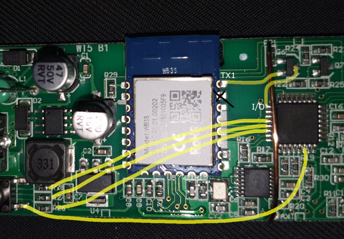

    I did some basic continuity testing. It seems like what you said is the case. TX1 of the WB3S connects to a transistor which connects to an I/O Pin of the secondary MCU. RX is not connected as far as I can tell.
    Also, the switch for setting the operation mode, as well as the status LED, connects to the secondary MCU. I will get a flash dump in a little bit.
    Close-up of a circuit board with highlighted TX1 and I/O connections on WB3S module.

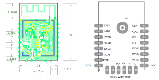

    Where do five MOSFETs controlled by PWM connect?
    Are they using PWM outputs of WB3S or the MCU?
    Technical diagram showing the bottom side of the WB3S module with pin assignments.
    NOTE: following is the image of WB3S BOTTOM SIDE.

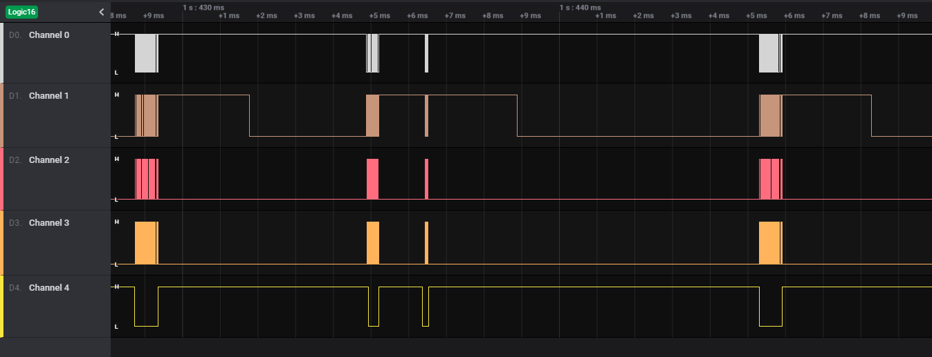

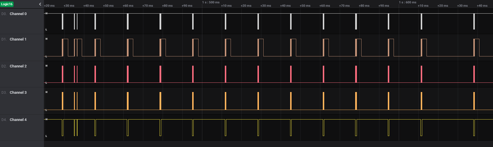

    I have set the controller into DIM mode (Single Channel control) and CCT mode (Warm+Cold white) and captured the TuyaMCU communication, it's attached. I have not bothered to capture RGB / RGBW / RGBCCT because the output looked pretty similar but I could do that later if desired (I've included notes as to which action was done in the output).

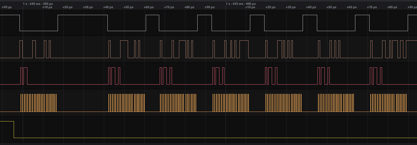

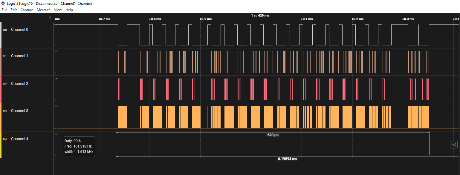

    I have also gone ahead and traced all the connections between the RF Chip and the secondary MCU and connected my logic analyzer. Unfortunately, I have no clue what the protocol could be.
    There are 5 connections between the RF Chip and the MCU. The most sensible thing to me is that it is SPI with a 5th connection being something like Enable or Receive / Transmit (Because these controllers re-transmit everything that they receive, and if I remove power from the secondary MCU, no data is output).
    Attached are screenshots of what I captured when I press a button on the remote (Channel 1 Button).
    I have also attached the capture data where I press Button 1 and then Button 2, it can be opened with Logic: https://www.saleae.com/downloads/
    Screenshot of a logic interface with signals on five channels. Screenshot of a logic analyzer showing signals on five channels. Screenshot of a waveform from a logic analysis of electronic signals for a controller.
    • Channel1, Channel2.zip (22.3 KB) You must be logged in to download this attachment.
    • CCT.txt (1.65 KB) You must be logged in to download this attachment.
    • DIM.txt (949 Bytes) You must be logged in to download this attachment.

    Nice, but we really need more information. This may be SPI with extra INT line where RF chip gives interrupt signal to MCU when something is received:
    Digital oscilloscope captures of five digital signal channels.
    We have both hardware and software SPI working, so if we'd know the details it would be possible to support it as well. Still, I'd prefer to first focus on TuyaMCU, at least for the other users...
    We also need more TuyaMCU captures, including RGB.

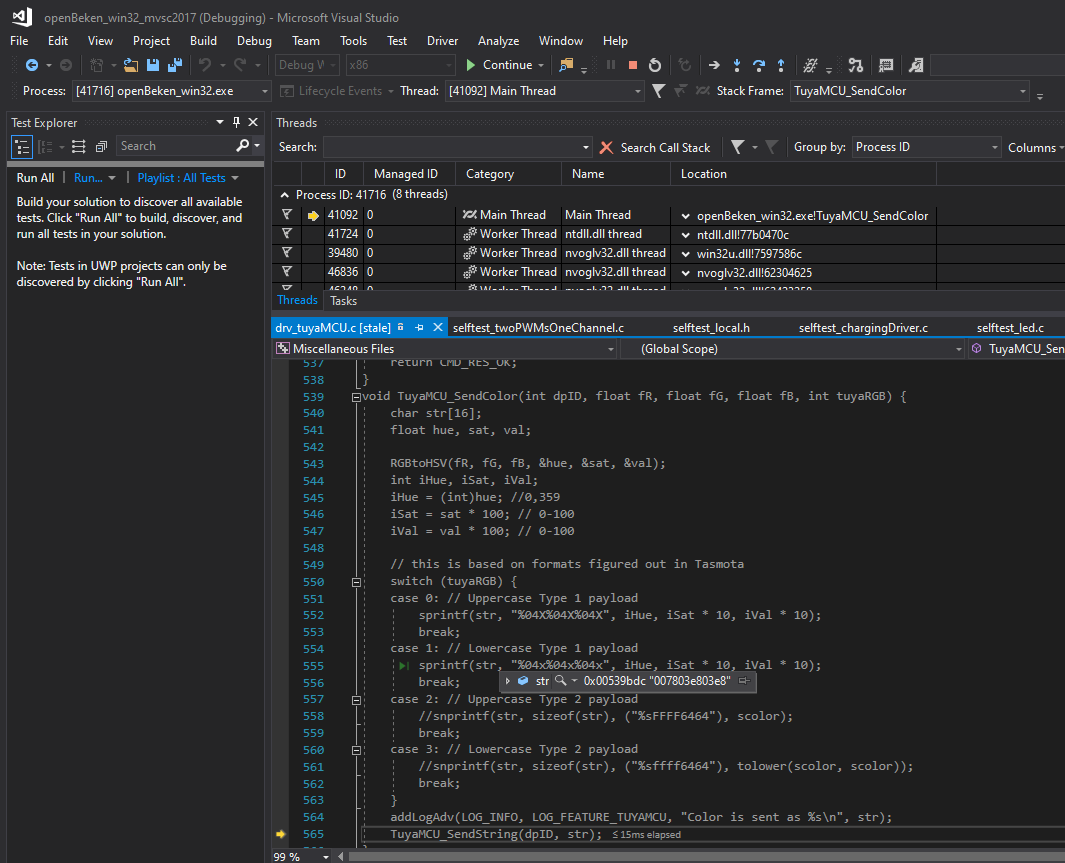

    tuyaMCU_sendColor 24 0 1 0 1
    Yes, I know that format:
    Screenshot of Visual Studio with code related to TuyaMCU_SendColor.
    This is the same as in this topic:
    https://www.elektroda.com/rtvforum/topic3982779.html#20656814
    Even dpID is the same - 24....
    Maybe the approach from that topic can work here and no code changes are required.

    I've checked how the output Mosfets are wired up on the controller. They have a 28k resistor from Gate to Ground, and a 47 Ohm from the secondary MCU to Gate.
    Would it be possible to have an output role in OpenBeken that can be toggled between being Open Drain / not? This would be the easiest way to allow the other Mosfets to be forced off because you would just need to replace the 47 Ohm resistor with like 470 Ohm and connect the Gate to a WB3S I/O pin additionally, and when that is switched into Open Drain it would of course Pin the Gate to GND - I would think it can sink the 10mA current which that would cause.
    Alternatively, I would need to either add a Relay or another Mosfet which of course makes it more complicated.
    Another way could be wiring the Mosfets of the second channel directly to the WB3S and it would then control those channels itself. And since it receives the remote values from the secondary MCU via TuyaMCU, it can just apply the same values.

  • LT8900SSK uses SPI with PKT/13 receive signal
    #23 20700163
    Kinsi55
    Level 4  
    Posts: 22
    Ok, that is something I can figure out later, for now I'd need to be able to receive the remote signals. Gamalot over in the EEVBlog forums was able to identify the chip and found a Datasheet for it: https://datasheetspdf.com/pdf-file/1480873/ETC/LT8900SSK/1
    With that, I was able to confirm that the communication is SPI, and with the right settings, Logic can actually properly parse the communication. I've attached a new Logic capture with some button presses / Notes on them and setup Analyzer. The fifth pin was just what you thought, a signal for when data is received (PKT/13)
    Pressing the same Channel Button multiple times sends the same Data, so what I need to do now is receive this SPI communication on the WB3S, and when it detects that the Channel 2 Button was pressed, it needs to change an I/O pin in one way or another. For testing, I would just connect a relay for now, maybe later I would switch that to the Open Drain "Hack"
    Edit: I just noticed my Soldering failed, which is why there is no MISO communication in that capture, I've fixed that and attached a new one :D
    • SPI RF Capture_.zip (66.79 KB) You must be logged in to download this attachment.
  • #24 20700164
    Posts: 14755
    Rate: 12881
    It would be very cool if we've managed to get that driver running. I can help you with some basics guidance. Do you have some C experience?
  • Question about passively sniffing RF MCU SPI on WB3S
    #25 20700177
    Kinsi55
    Level 4  
    Posts: 22
    Yes, I do have some C/C++ experience. I've done some basic embedded work before with Atmegas and STM32's.
    What I am wondering is, would I be able to only listen to the RF > MCU SPI communication on the WB3S and have the secondary MCU continue to handle it? I've never worked with SPI before in this fashion and this would be my preferred implementation.
    As it stands, theres only a hand full of free pins on the WB3S:
    - EN
    - TXD2
    - RXD2
    - PWM3
    That would be enough for full SPI communication, but then I'd have no way of actually adding a relay, or if we could ignore MOSI or MISO, that would free up a pin for that (Hence, only listening to the communication)
    Also all the ones on the Bottom edge, so SO, SI, CS, SCK but I dont think those are usable?

    #26 20700952
    Posts: 14755
    Rate: 12881
    All WB3S pins are useable, including:
    Pin No.SymbolI/O TypeFunction
    1SOI/OData output pin when data is downloaded from the flash memory, which is used for module production and firmware burning and is connected to the P23 or ADC3 pin on the internal IC
    2SII/OData input pin when data is downloaded from the flash memory, which is used for module production and firmware burning and is connected to the P22 pin on the internal IC
    3CSI/OChip selection pin when data is downloaded from the flash memory, which is used for module production and firmware burning and is connected to the P21 pin on the internal IC
    4SCKI/OClock pin when data is downloaded from the flash memory, which is used for module production and firmware burning and is connected to the P20 pin on the internal IC
    We have even used them in this video:
    https://youtu.be/KU0tDwtjfjw?t=235
    It's good to hear you have programming experience. There are few things you can check to get better understanding of the codebase:
    - BL0942 driver can work in both UART (default) and hardware SPI mode:
    https://github.com/openshwprojects/OpenBK7231T_App/blob/main/src/driver/drv_bl0942.c
    - here is SPI driver itself:
    https://github.com/openshwprojects/OpenBK7231T_App/blob/main/src/driver/drv_spi.c
    - here is a driver that is using GPIO interrupt:
    https://github.com/openshwprojects/OpenBK7231T_App/blob/main/src/driver/drv_bl0937.c
    I am currently not sure how exactly we should handle the communication, but most likely first you'd need to setup an interrupt on GPIO and when it's fired use SPI to communicate with the chip.
    BK7231 SPI is only on certain pins, so maybe it would be better to use a software SPI?
    https://github.com/openshwprojects/OpenBK7231T_App/blob/main/src/driver/drv_soft_spi.c
    Here is a sample driver that uses software SPII:
    https://github.com/openshwprojects/OpenBK7231T_App/blob/main/src/driver/drv_spi_flash.c
    I didn't check the datasheet of your RF module yet, but maybe it would be enough to use one interrupt and the software SPI...

  • WB3S 5V tolerance and RF packet decoding
    #30 20715579
    Kinsi55
    Level 4  
    Posts: 22
    Do you have any idea if the WB3S is 5V tolerant? According to the Tuya datasheet, the max I/O Input Voltage is 3.6, but according to Espressif, the ESP32 doesn't support 5V either, yet it tolerates it just fine - So I'm wondering if you know if that is the case for the WB3S as well.
    I'm asking because the Secondary MCU -> RF Chip logic level is 5V. Not needing to convert that would of course be great :D
    I have figured out the communication mostly and it should be very possible to just passively listen to it and attach functions in Openbeken to remote buttons - Which is what I was gonna do / create a driver for.
    When a Packet arrives, first 0b1011 0000 is sent, which is REGISTER_READ | R_STATUS (48)
    RETURN:
    15 CRC_ERROR R Received CRC error
    14 FEC23_ERROR R Indicate FEC23 error
    13:8 FRAMER_ST R Framer status
    7 SYNCWORD_RECV R 1: syncword received, it is just available in receive status, After out receive status, always keep ‘0’.
    6 PKT_FLAG R PKT flag indication
    5 FIFO_FLAG R FIFO flag indication
    4:0 (Reserved) R (Reserved)
    If STATUS_CRC_BIT (15) is true, the data is just discarded
    else it will then read register 50 (R_FIFO)
    RETURN:
    15:0 TXRX_FIFO_REG R/W
    For MCU read/write data between the FIFO.
    Reading this register removes data from FIFO; Writing to this
    register adds data to FIFO.
    Note: FW (MCU) access to FIFO is byte-by-byte.
    data >> 8 of the first response is the packet size
    Afterwards, this read is repeated until packetSize is met
    and data just gets appended into a buffer
    Once that is over...
    first 0b0011 0100 is sent which is REGISTER_WRITE | R_FIFO_CONTROL
    The data that is written is 0b1000 0000 which just clears the FIFO buffer
    After that, another write to register 7, sending 0b0000 0000, 0b11001100
    I have no clue yet what that does, but it's not really relevant for us

What differences were found between dpID 24 and dpID 28 on the WT5, and how is the Tuya ASCII color format interpreted?
dpID 24 was identified as the main RGB color string, while dpID 28 looked like a longer compound string that may include both RGB and white-channel information. For example, one captured dpID 24 string decoded to 00 73 03 e8 03 e8 for a green test, matching a known Tuya color format already seen in another OpenBeken topic. The thread’s working conclusion was that dpID 24 is the actionable RGB field, while dpID 28 remained less certain and appeared to mirror extra white-related data. [#20689271]
