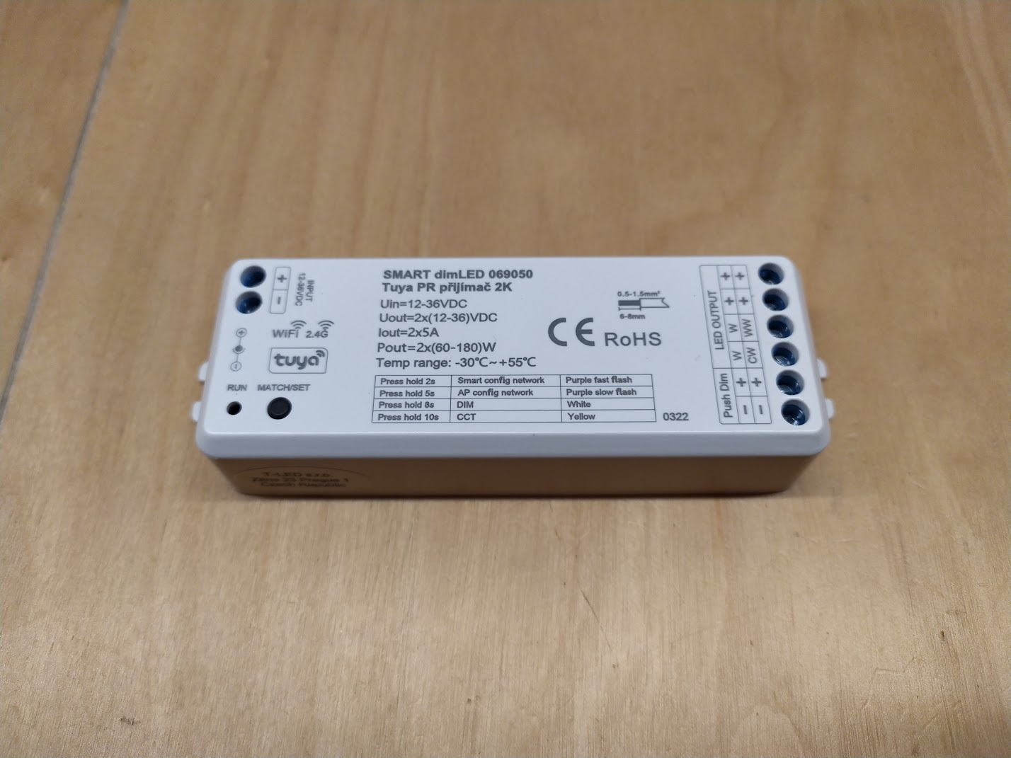

  • Two-channel LED controller WT1 with label and connectors.
    this is my teardown of the WT1 2 channel CCT LED controller. This is a device intended to dim WW/CW strips (CCT mode) but it can be also used as a 1 channel dimmer (DIM mode). One can control it using the Tuya app, dedicated remote control, or a physical push button.

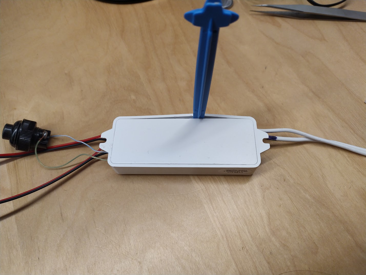

    The disassembly is simple. The white case contains no screws and is held together by clips. Simply pry open the bottom part of the case and you can access the insides.
    Image of Tuya's CCT LED Controller WT1 with visible labels and connectors.
    Dismantling the LED controller WT1 using a tool.
    (the second photo is illustrative, please unplug all connected wires before opening the case)

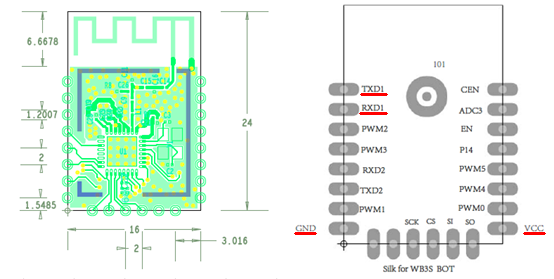

    Diagram of WB3S chip with pin labels.
    Note that this diagram shows the chip from the bottom side, so the pins are mirrored compared to the real photo.

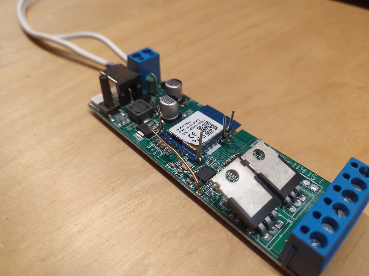

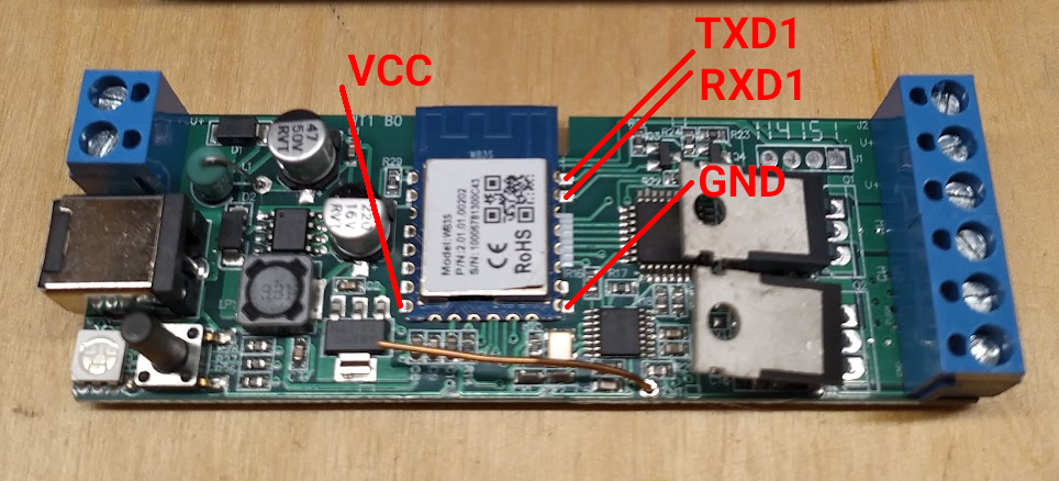

    Close-up of the LED CCT WT1 controller board with marked VCC, TXD1, RXD1, and GND pins.
    As mentioned, inside we find the WB3S chip along with a second chip that controls the PWM. We need to solder 4 pins as shown in the third image. For this I used DUPONT pins and soldered them directly to the WB3S chip pads.

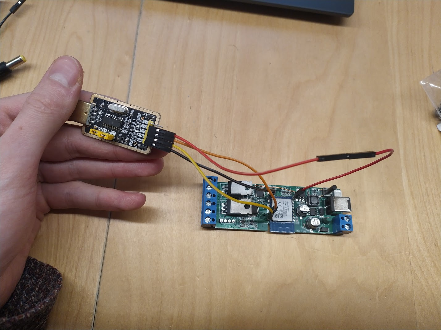

    Then I was able to connect the USB to TTL converter. I used a CH340 based module from Aliexpress that has a 3.3V mode. Using a jumper, I set the 3.3V output on the converter and connected the pins to the WB3S chip:
    VCC <-> 3.3V
    TXD1 <-> RXD
    RXD1 <-> TXD
    GND <-> GND
    For the VCC connection, I used two wires, so that disconnecting and reconnecting the power would be easy. This comes useful later in the flashing part.
    Connecting USB-TTL converter to LED controller

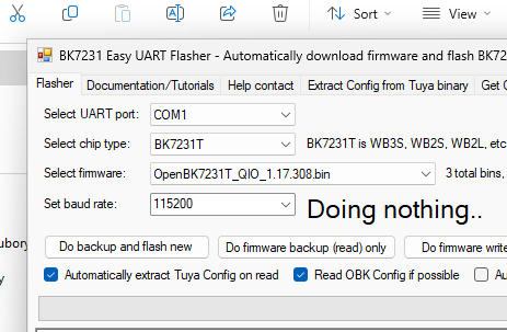

    For flashing, I wanted to use the nice and beginner friendly BK7231 GUI Flash Tool. I downloaded the last version from Releases in Github.
    Because I run Linux, I needed to run the application in a local virtual machine with Windows 11. This part is therefore a bit specific to my setup and most people running Windows natively may skip the VirtualBox setup (skip the next paragraph).
    I connected the CH340 to my laptop and checked that the Serial port appeared as /dev/ttyUSB0. In VirtualBox, I enabled the serial port through Machine Settings->Serial Ports->Port 1. There I set the following:
    Port Number: COM1
    Port Mode: Host Device
    Path/Address: /dev/ttyUSB0
    (Note: I also tried to expose directly the USB device to the guest system but didn't have success flashing the image that way)
    (Second note: maybe one could run the flashing tool using Wine but I didn't attempt that)
    I started the flash tool and the serial (UART) port was detected automatically as COM1. I also set the chip type to BK7231T (=WB3S) and set the Baud Rate to 115200 (the default value was crashing). Finally, I selected the "Do backup and flash new" option and everything went smoothly. During the flashing, the device needed to be rebooted two times. I did this by replugging the VCC cable.
    BK7231 Easy UART Flasher application window with flashing settings.
    For a more detailed flashing guide, I refer you to the Flash tool README.
