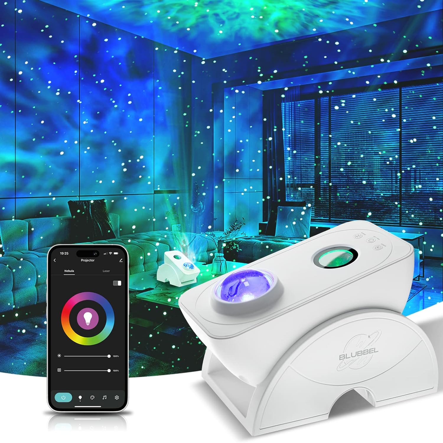

Overview
Galaxy projector displaying colorful lights and a mobile app for control.
This projector has 5 components
- RGB LED, projected through a lens (nebula)
- Laser, projected through a screen (stars)
- Motor, turns the lense and screen, resulting in movement of the nebula and stars
- Microphone, to sync the light to music
- 3 Buttons on the front, to turn on the projector, cycle scenes, activate music mode
Info:
- Chip: BK7231N
- Module: CBU
