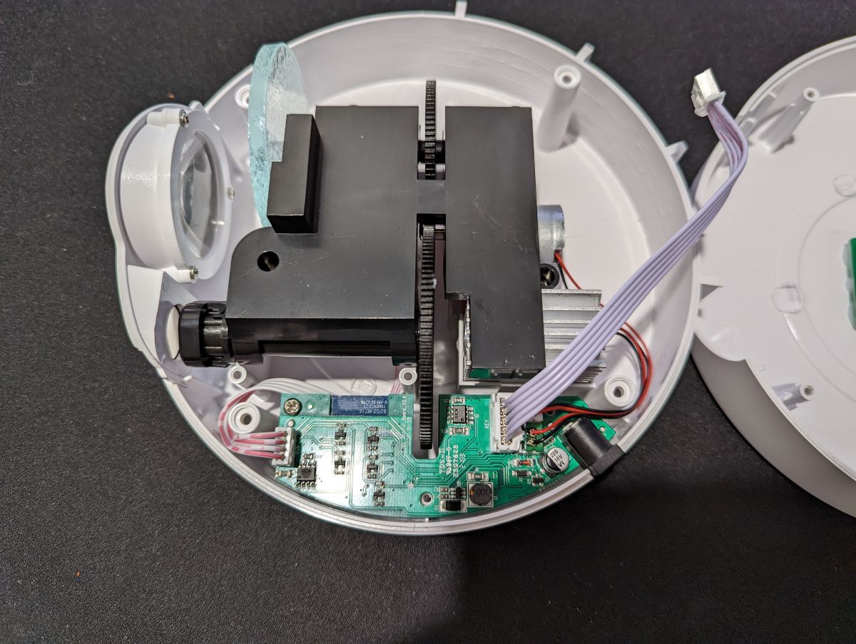

    Interior
    After removing 4 screws from the outside of the housing, the device can be slpit in half. There is a cable between the Button board and the main PCB.

    Remove 3 screws from the PCB to access programing headers.
    Genio Galaxy Smart Lamp - BK7231T - Teardown + Guide
    3rd screw hidden behind motor and laser connectors.

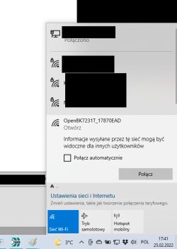

    The BK access point is already visible:
    Connect to the WiFi point created by the BK7231T.
    Here you may need to set our WiFi to a rigid IP, e.g. 192.168.4.10, in case DHCP does not work:

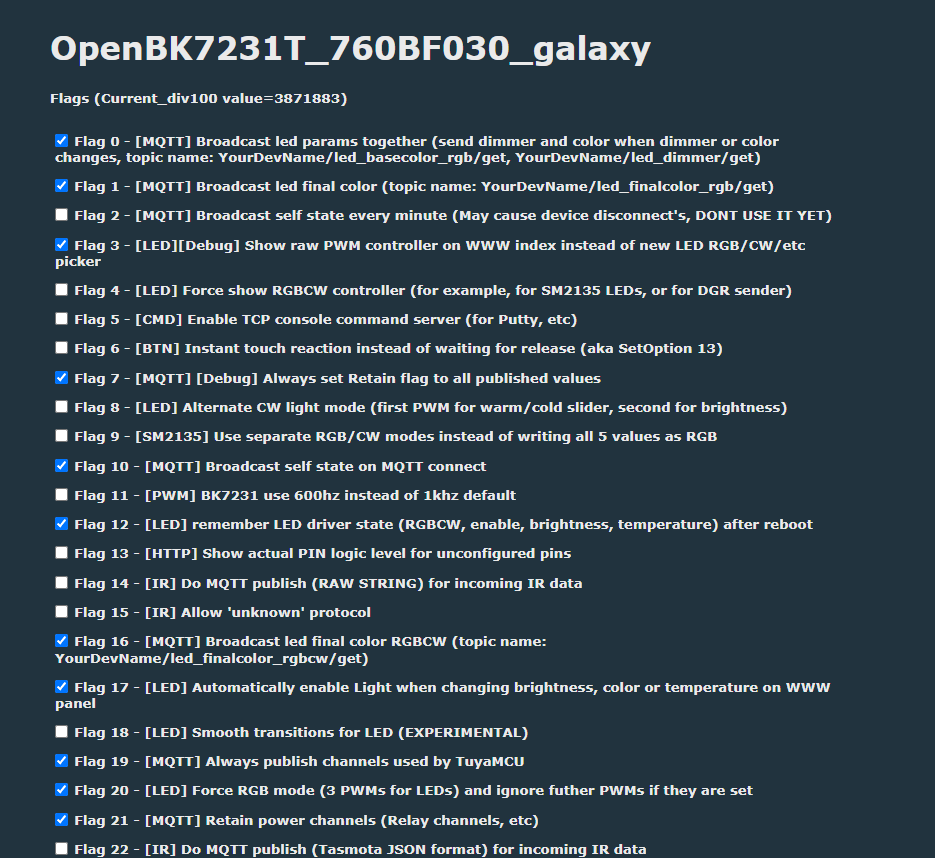

    Pin Configuration
    Once connected to the device. Click "Config" and then "Configure Module"
    Your settings should be as follows. This may vary from device to device and depending on brand so you may have to experiment.
    Click Save.
    Next click "Configure General" It should be set like the following:
    Thank you to p.kaczmarek2 for adding a few custom flags and settings to the firmware to get this working perfectly!

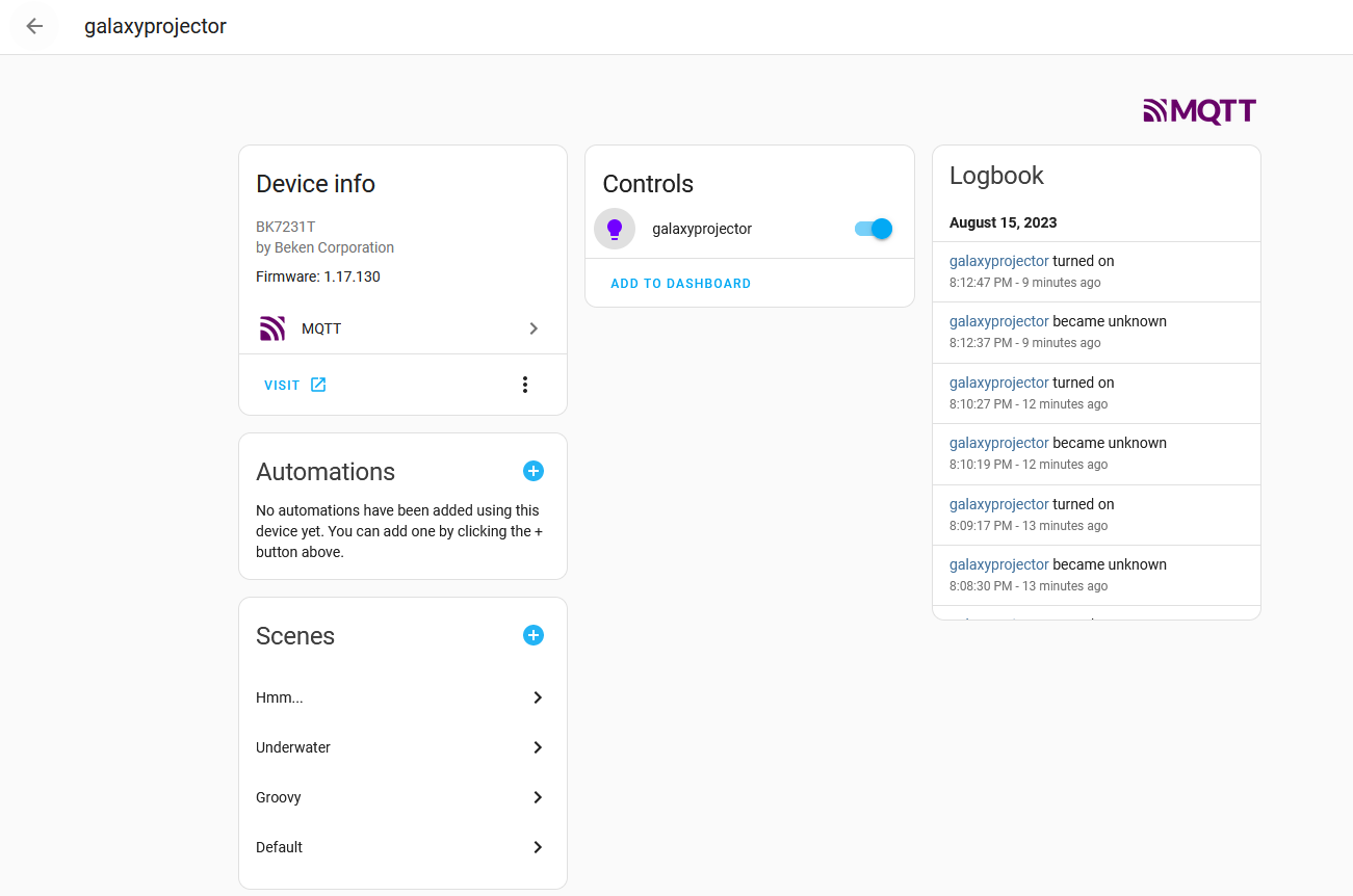

    Your new home screen should look like the following:

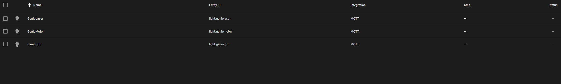

    The Unique ID will be specific to your device and you will need to replace the example code with your device ID. This can be found on the Home Assistant Configuration page of the device. Only copy the Unique ID from the Home Assistant Configuration Page. The rest of the example configuration will not work in Home Assistant:
    Adjust the unique ID to suit each part of the device e.g. OpenBK7231T_760BF030_galaxy_light, OpenBK7231T_760BF030_galaxy_laser and OpenBK7231T_760BF030_galaxy_motor. 3 of the same Unique IDs will not work and Home Assistant will only detect 1 entity.
    Once you have restarted Home Assistant you should have 3 entities named light.GenioRGB, light.GenioLaser and light.GenioMotor. Keep in mind changing the name of these entities in your configuration willl change the name that they are displayed with.

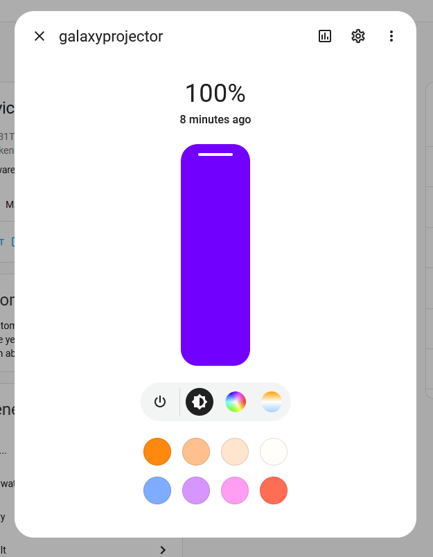

    Operation

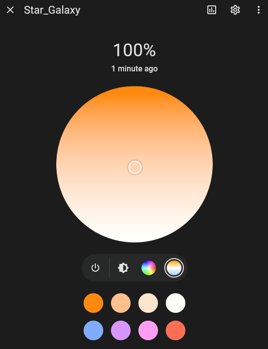

    You should be able to select any RGB colour from the colour wheel, turn on the laser to any brightness and adjust the motor to any speed. Something to note is that the Laser and Motor are electrically connected within the device. This means that setting the laser to maximum brightness with the motor off will result in a dim laser output. Activating the motor immediately increases the laser brightness. The motor can spin extremely slow and this will still allow full brightness of the laser. I assume this is an effort to prevent the laser from damaging the internals of the device and outputing a static beam. Finally the button on the side of the device has been set as a master ON/OFF button for the lamp. It should retain all brightness values when toggled. You can change the function of this button by changing the assignment of the button channel on the module configuration page.
    Your device should be fully operational now!

    This device was a very interesting to support. I have never seen a device using PWMs for motor and laser before, especially in conjunction with RGB LED.
    I had to add a special flag for this device, because currently OpenBeken is using a number of PWM roles to determine whether a device is a single color dimmer, or a CW, or RGB, or RGBCW, just like Tasmota...
    And in case of your device OpenBK recognized it as RGBCW and tried to treat Laser and Motor as C & W LEDs!
    That's why the extra flag was needed, to force RGB-only mode.

    I have followed the setup instructions and have managed to get my device working as expected. After playing around I have found that you don't have to add all the flags to get the device to work correctly. I only have Flags 3, 10, 20 and 27 turned on and the device appears to function as expected.
    I've had to modify the Home Assistant code a bit to get it to work with my setup. Feel free to try this if you having issues.

    As the light was detected automatically on my setup I took that part out as it was just doubling up. It is a bit of a pain that now have 3 entities on my overview tab. I don't really use the laser and guess I could just remove those options.
    It's interesting to note that if you just leave the default MQTT and turn off flag 20 you can control the laser and motor via the temperature tab. unfortunately, the control of the laser and motor appear to work opposite of each other when you move the slider. IE the laser get dimmer when you move it to the "Warm" setting but the motor gets faster and vice versa when you move the slider to "Cool"
    You can change Pin 6 to PWM_n and this does fix the opposite issue but then create another one as the motor spin to high speed when the laser is at full brightness and slows down when the laser is at low brightness. You also have to deal with the temperature slider and it would be nice to have it like the original function of the device. the other issue is that when you turn the device off the motor turns on.
    The other issue in doing the above is you can only turn the laser on and off and not have any of the RGB colours so it was not really the best solution in the end.
    I tried splitting the temperature slider into warm and cold sliders but so far have not had much luck. I wonder if there would be a way to get OpenBK to split the channels so home assistant picks them up as separate sliders. Not sure how you would achieve this and I would say you couldn't have the RGB going at the same time as the laser and motor. So again probably not a solution
    I have tried also tried to set the channel types to different things to see if I can trick home assistant into thinking those channels are something else but I couldn't get it to bring up anything else and I assume that is because home assistant sees it as a light and those options are not available. I guess making a custom entity would be a way but getting it to work could take some time.

  • #6 20695133
    jnh5383
    EDIT: Problem fixed - Wasn't thorough enough! Didn't realize that the three entities wouldn't show up under the MQTT integration. Found them under the Entities tab in "Devices & Services". Everything is there, naming and all. Hope this helps someone!
    Awesome to see this device is supported! Flashed it and got the primary light to pop up in Home Assistant. However, I cannot get the laser and motor to show up in HA no matter what I do.
    I tried altering the provided example with my unique device ID, creating this:

    This looks correct to me, and I pasted it into my configuration.yaml in HA. However, the laser and motor still don't show up as light entities, and the main color wheel that alters the galaxy color has temperature control that dosen't work properly.
    Here's what the device looks like in Home Assistant:
    Home Assistant user interface with galaxy projector.
    And here's the only light entity provided, note that the temperature wheel is available when it shouldn't be:
    User interface showing the control of a galaxy projector light set to 100%.
    Has anyone else ran into this issue, or can link an article that explains further about attaching custom configuration OpenBeken devices to Home Assistant?
    I really appreciate the help, and thank you for all the hard work!

    I'm experiencing a similar issue.
    The temperature control works, but there's a problem: when it's cold, the laser and motor turn off, while in warm temperatures, the opposite happens. It seems that these channels need to be separated and assigned to sliders. However, achieving this without coding a dedicated device specifically for this purpose poses a challenge. Although reaching out to the Home Assistant forums might be an option, it's uncertain whether there are enough users with the same device to prompt their assistance. Regardless, it's worth a shot.
    Using the OP's custom MQTT code, I managed to make the motor and laser visible. However, they appear as separate entities on my Home Assistant overview dashboard. Since I don't often use the laser, I've omitted that part for now.
    Unfortunately, I don't see a straightforward solution to consolidating the motor and laser entities within Home Assistant, unless the platform itself introduces features like building custom light entities or incorporating a dedicated device for such cases.
    I'm not certain about the specifics of the Tuya integration, and there might be some crucial data that we lack. Although I don't have an unmodified device to verify, it could be worthwhile for someone to investigate this aspect before flashing using the Tuya IoT website.
    For those considering flashing this device, I recommend gathering this information beforehand, as it could greatly assist in setting up the device correctly.
    The only approach I've found that might work involves using something like Template Light. Although it appears user-friendly, I haven't had the chance to experiment with it. However, a challenge with this solution is that the MQTT data from OBK would still be sent to Home Assistant, so finding a way to prevent this transmission would be necessary.
    Since OBK currently lacks the capability to create custom MQTT setups, our options seem limited. While the OP's MQTT script did function, it did result in multiple entities. While having them combined would be preferable, it's uncertain whether this option will become available soon or even at all.
    It would be great to see OBK give us a way to create custom devices like this one and have the ability to send this data to home assistant. I do believe there is the option to create custom MQTT scripts coming but I am not sure what the timeline will be for that. For now we just have to play the waiting game.
    Added after 29 [minutes]:
    You could try to make a custom component in home assistant if you have the know-how. Creating custom components.
    It is a little beyond my level of skill and again I still think you will have the issue of OBK sending the MQTT data and getting a double up of devices. Until there is a way we can stop the MQTT data being sent then I don't really know of any other way.

    Would the ability to do a custom (hand-edited) HA discovery YAML help with HA integration?
    This could help, but I still think we would have the issue of the device having separate entities in Home Assistant.
    The issue is that the laser and motor register as a colour temperature slider in Home Assistant. If there is a way to split the cold and warm channels apart, then we could control the laser and motor separately.
    Home Assistant app screen showing color temperature selection.
    The behaviour at the moment is when setting the colour temperature to 100% warm or 2000K, it turns the motor on to 100% but turns the laser off. Setting the colour temperature to 100% cold or 6493K turns the laser on 100% and the motor off.
    The behaviour I would like to see is instead of a colour temperature slider, there are two sliders. One for the laser and one for the motor. They need to be combined with the RGB to make one component in Home Assistant.
    I'm not sure a custom yaml from OBK would achieve this, but it's worth giving it a go. This would solve problems with other devices I have if we are able to send our own yaml instead of the OBK auto-generated one. It would also be great if there was an option to turn off the sending of the auto-generated yaml as well so we can make our own custom yaml in home assistant should we need to.

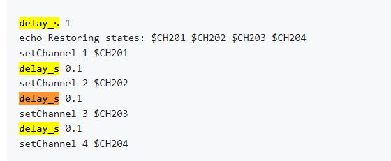

  • #20 20862061
    Posts: 14615
    Help: 655
    Rate: 12632
    delay_s does not work currently in backlog, but it works in a script:
    Script code using delay_s and setChannel functions.
    Moderated By p.kaczmarek2:

  • #22 20864362
    Posts: 14615
    Help: 655
    Rate: 12632
    wolfieeewolf wrote:
    Do I need to make a new file and link it to the "addChangeHandler Channel10 == 35" ?
    This is good question. The solution is to use startScript command along with unique ID, like 1234, and before you start new script instance, stop the old instance with stopScript
    wolfieeewolf wrote:
    I also tried to add Flag 18 to smooth out the transitions but it makes the lights flash. It only seems to be an issue with the autoexec light cycle. When I change the LED colours in HA with Flag 18 on it works fine.
    This will not work with channels. The Flag 18 is for LED driver, so if you want to have smooth changes, then you have to set color by led_basecolor_rgb FF0000, etc. That way you can get smoothing working.

    In my post linked above I'm describing to issues I've found:
    - The projector it turns off itself automatically after about one hour.
    - When you turn the device on using the main switch it doesn’t remember the last state of lights/laser/motor when it was on before.
    Maybe with your expertise you are able to provide a solution for these issues.
    Best,
    Helge
  • #24 21123233
    rhyss
    Did anyone end up figuring out or know of a way to turn off the button light when the device is not projecting anything? the light is too bright at night. Before flashing the device the button was off until the projector was turned on.
  • #25 21123268
    Posts: 5062
    Help: 438
    Rate: 893
    >>20858945

    Posts: 14615
    Help: 655
    Rate: 12632
    I've updated OBK backlog command and now delay_s will work in backlog block.
    So, this will work now:
    backlog setChannel 1 123; delay_ms 500; setChannel 1 234; delay_ms 500; setChannel 1 345; delay_ms 500; setChannel 1 456; delay_s 0.5; setChannel 1 567

Use the latest OpenBeken UA batch build and enable Flags 3, 10, 20, 27; users report full RGB, laser, and motor control with this minimal set [Elektroda, wolfieeewolf, post #20542657]
Home Assistant shows a temperature slider instead of laser/motor—why?
HA auto-discovers the extra PWM channels as C/W LEDs, merging them into a colour-temperature control. Manual YAML mapping or custom discovery YAML separates them into two independent light entities [Elektroda, wolfieeewolf, #20695139; p.kaczmarek2, #20696536].

How do I stop duplicated entities from MQTT discovery?
Disable OpenBeken’s automatic HA discovery (setOption MQTTDisableDiscover 1) and publish a hand-written YAML; manual discovery avoids doubled RGB entities [Elektroda, p.kaczmarek2, post #20695194]
