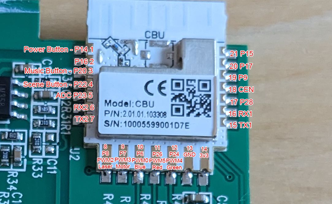

    - Chip: BK7231N
    - Module: CBU
    Close-up view of the projector's circuit board with labeled ports and buttons.
    It's quite close to the device showcased here, but it features a different chip, Tuya module and construction, so I figured it would be worth documenting. Nevertheless, most of the work has been done for the Genio projector so it was easy to get this one running. Thanks @joelstevens1101 and @p.kaczmarek2 for your work!

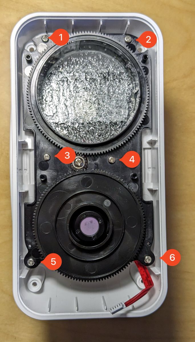

    Teardown

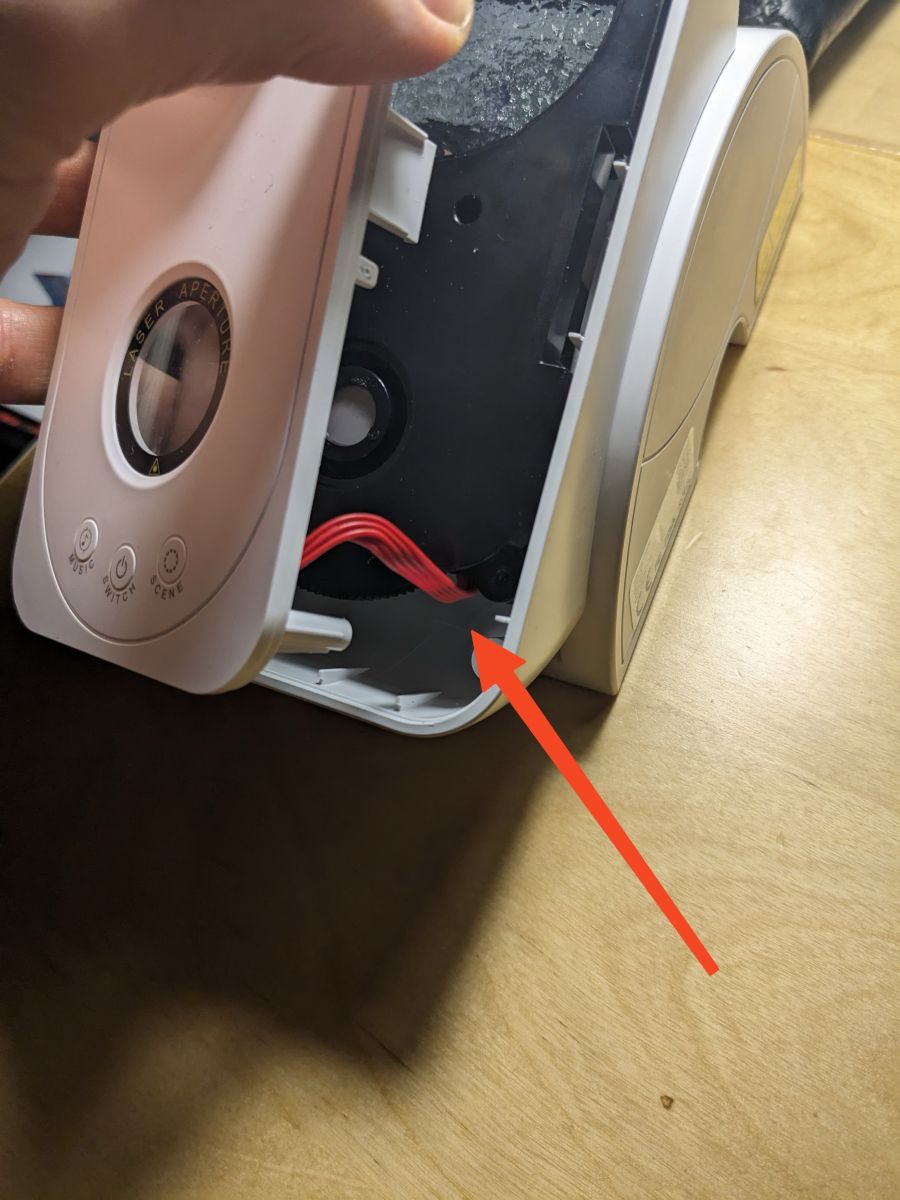

    Remove the 4 screws at the bottom of the device. They are quite hard to reach, you need a very short phillips head screwdriver.

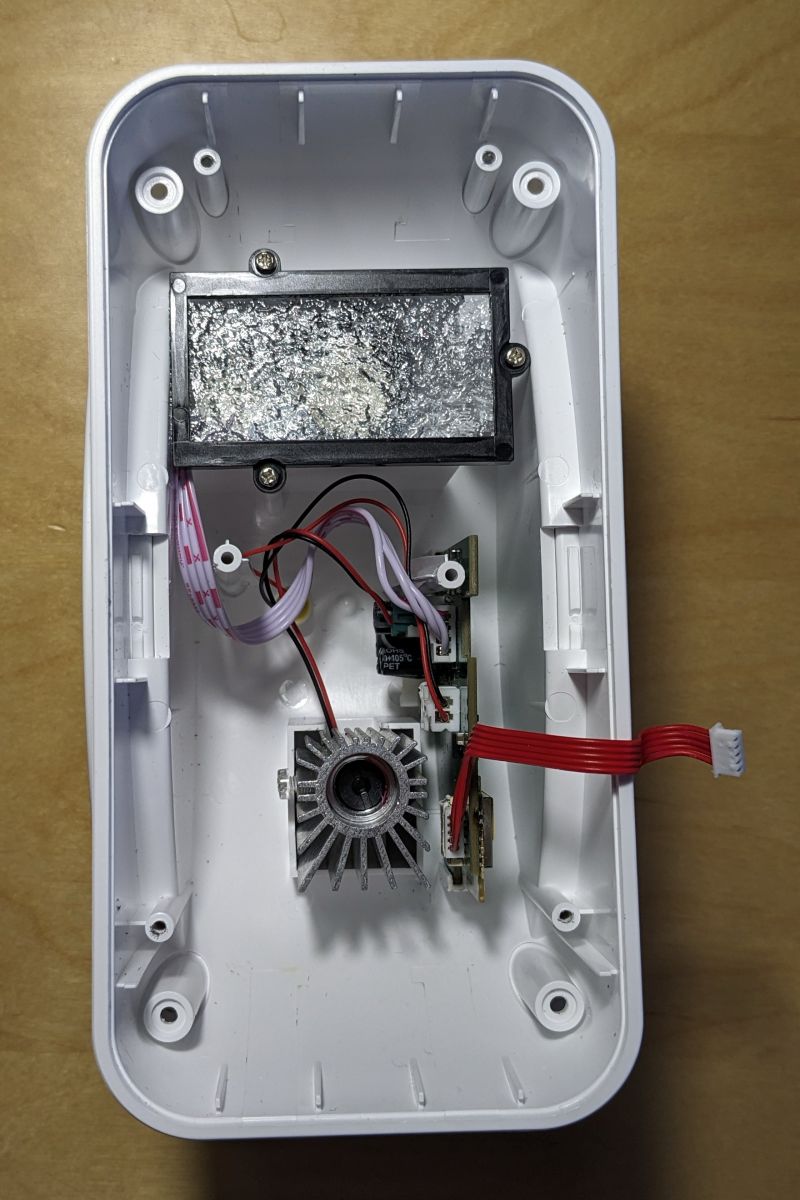

    Lift off the top cover to right hand side. Caution: The button board is connected with the main board, so you need to unplug the red cable before removing the cover completely.
    Close-up of the projector's interior with an open casing, showing a red cable connecting the buttons to the main board.
    Remove 6 more screws from the black middle frame.
    Interior view of a starry sky projector with labeled components.
    Remove the lense and the screen. The motor is attached to the frame on the bottom. When moving the frame make sure you don't damage the cables. Either put the frame to the side or unplug the cable with pliers.
    The main board is glued in place. I had to wiggle it for some time with moderate force to get it out. When pulling out the board, again pay attention to the cables.

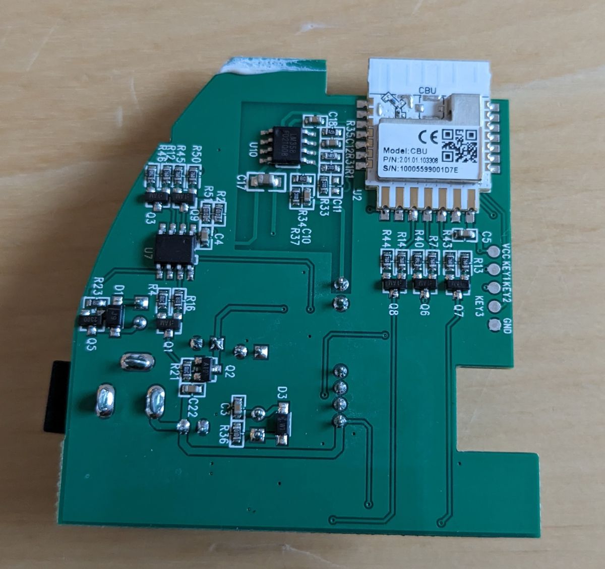

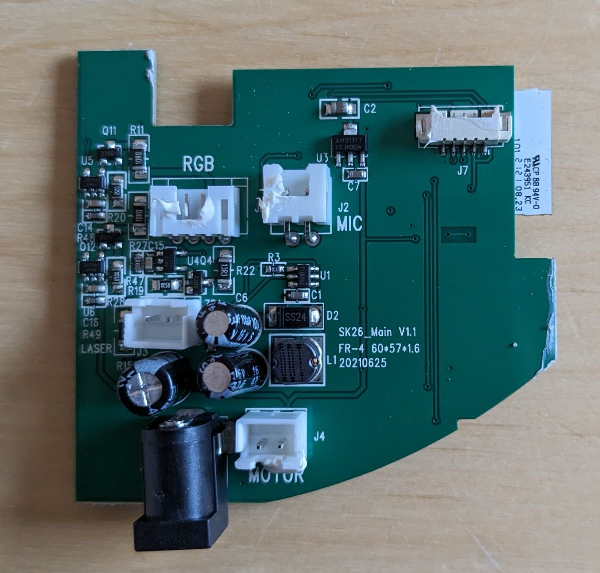

    You did it! The board looks like this:
    Top view of an SK26 projector circuit board with component and connector labels.
    LED projector circuit board with various components and a CBU module on the surface.

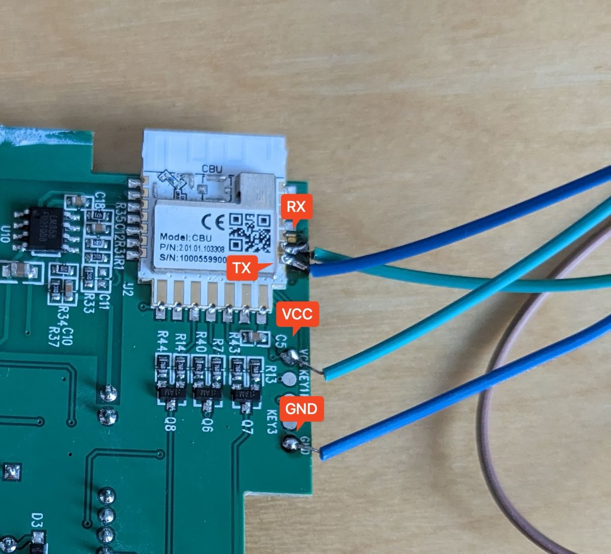

    Flashing
    For VCC and GND I used the pads below the module, as they are easier to solder to. They are labelled. TX (Pin 15) and RX (Pin 16) are on the right hand side of the chip. Tin your wires and pads, flux will help you. To solder, just connect the wire with the pad and touch it with the iron briefly.
    Circuit board with marked RX, TX, VCC, and GND pins
    Connect the soldered wires to your programmer. I used a NodeMCU that I had lying around as described here. Conveniently it also operates on 3.3V so I had no issue with voltage conversion.
    The BK7231 GUI Flash Tool works just fine for flashing. It is quite straightforward: Make sure you select the correct COM port and BK7231N as the chip. Start the backup and flashing procedure and power cycle the chip when prompted. Note: Only reset the chip, not the programmer. You can find the backup of my devices ROM attached to this thread.
    readResult...-23-05.bin (2 MB)You must be logged in to download this attachment.
    Should you not able be able to get a connection to in the flash tool, double check your solder joints. The ones on the chip in my picture actually short TX and RX, so I had to redo them.
    After flashing is complete, power cycle the device again. A new Wifi network should appear. Set up the device to join your local network. Confirm you can connect the device to it using your Wifi.
    Congrats! That was the hard part - the new firmware is flashed. You can now desolder the wires you used for flashing and put the device back together.

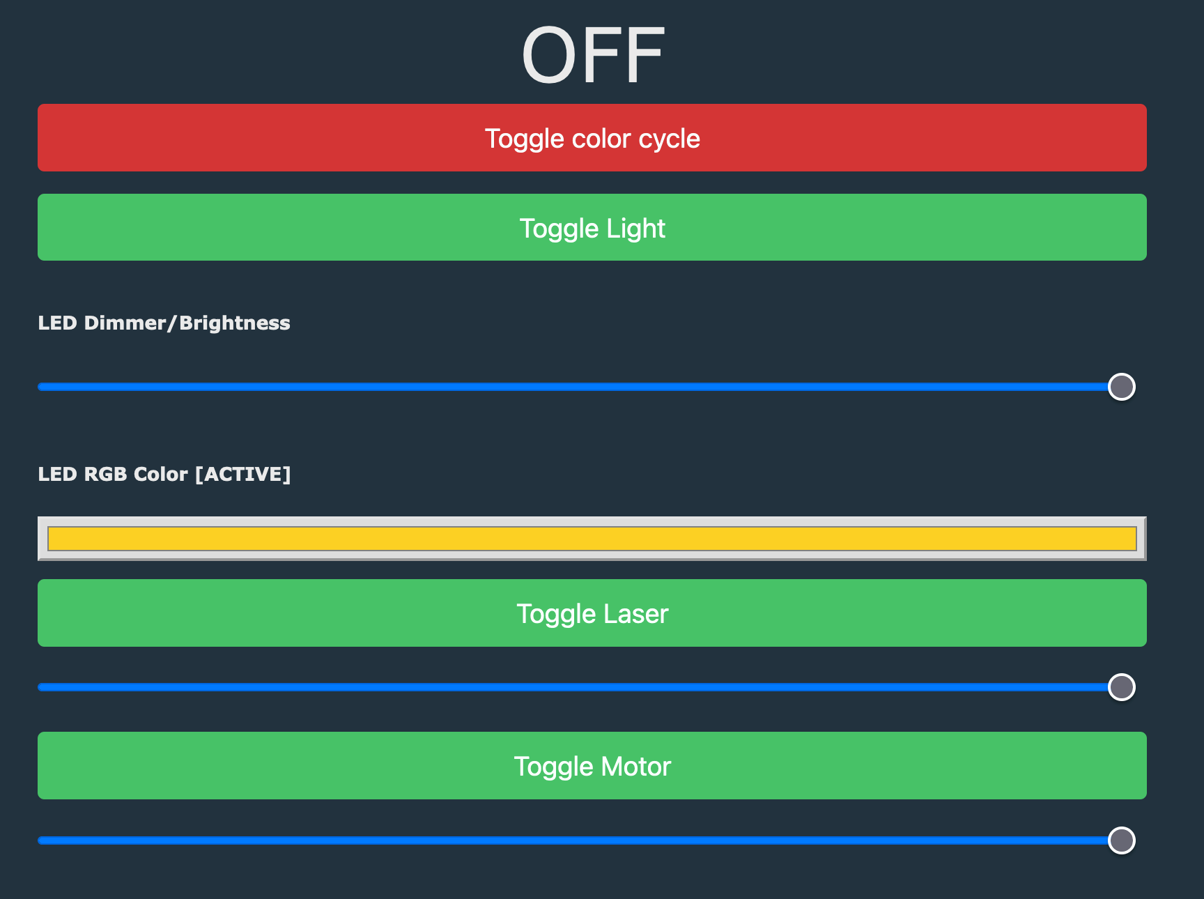

    After restarting, on the main page you should be already able to control the RGB LED. But we are not done yet.
    To get the motor and laser working head over to Filesystem, click Create File, confirm autoexec.bat as the name and paste the following content into it. It will couple the state of the of the LED to the motor and laser and set startup values for them.

    Confirm with Save, Reset SVM and run file as script thread.
    Now the main menu should look like this:
    LED projector control panel with various options such as mode switching and brightness settings.
    You can toggle the LED, Motor and Laser and control the brightness and speed. Also there is a button to automatically cycle the colors. The color pallete can be customized at the bottom of the script.

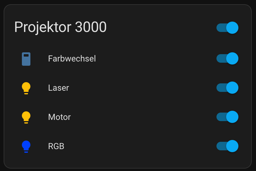

    Homeassistant
    This config adds the light, motor, rgb and the color cycle mode to Homeassistant. You will need to adjust the mqtt topics to match your configuration.
    Projector 3000 app interface with control options enabled.

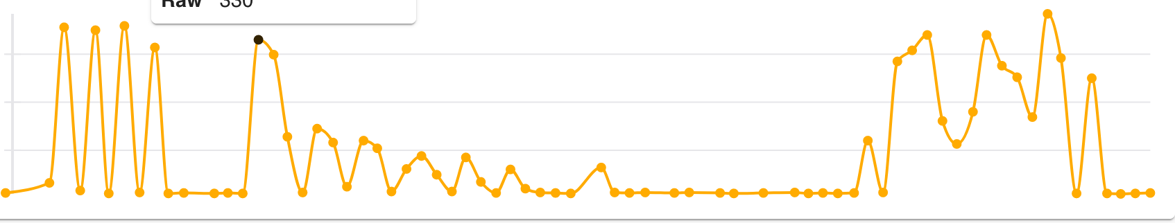

    Microphone
    The projector has a builtin piezo microphone to sync the light to music. I wasn't able to get that working. I assume it's connected to PIN 5 (ADC) but I can't tell if the readings correlate to the music.
    Graph showing fluctuating raw values on the y-axis over time.

    How is the microphone supposed to work?
  • #12 20864806
    similicious
    Posts: 8
    I'm not sure. The microphone is connected via two wires. If I follow the traces correctly, they go into an LM358 IC, which is an amplifier of some kind. Then I just assume that the signal goes to Pin 5 of the module, which is the ADC. I set that pin to ADC in OBK and plotted the readings in MQTT-Explorer - you can see the graph in the post. That data could be used to find peaks in the audio and then sync to color changes or to toggle the laser. But I don't know how to go about that.
    Maybe I will look into it someday. For now, I'm more than happy with the integration. Thanks again! :)

    Hi, thank you for this great work! I received my sk26 today which I ordered after I had discovered this thread. I already use two sk20 star projectors with ESPHome (there's a software jailbreak available for them but the security exploit doesn't work for the sk26). The reason why I wanted the sk26 in addition to the sk20 is because of the availability of blue laser while for the sk20 only green laser is available for purchase (at least in Europe and on Aliexpress).
    I wanted to inform you about this ESPHome project for the sk20 which could probably server as good starting point for building an ESPHome configuration also for the sk26:
    https://github.com/M4GNV5/esphome-SK20-Nebula-Light/blob/master/nebula_light_device.yaml
    I will certainly look into this myself later, right now I have some other ESPHome projects that I want to finish first. But maybe someone else has time and interest in checking out the ESPHome config https://github.com/M4GNV5/esphome-SK20-Nebula-Light/blob/master/nebula_light_device.yaml for the sk20 already.
    This is a picture of the sk20:

Open it in three careful steps. 1. Remove the 4 bottom screws with a very short Phillips screwdriver. 2. Lift the top cover to the right and unplug the red button-board cable before fully removing it. 3. Remove 6 more screws from the black middle frame, then move the motor frame gently so its cables are not stretched. The main board and several plugs are glued, so pull on connectors with pliers, not on the wires. [#20863828]

Which pins and pads should I use to flash the BK7231N/CBU board in the SK26, and how do I wire TX, RX, VCC, and GND correctly?
Use the labelled power pads under the module for VCC and GND, then solder to TX pin 15 and RX pin 16 on the chip side. The author chose the lower pads because they are easier to solder than the fine-pitch module edge. Keep the programmer at 3.3 V; a NodeMCU used as an FTDI bridge worked without level shifting. Tin both wire and pad first, add flux, and touch briefly with the iron. [#20863828]
Why does the BK7231 GUI Flash Tool fail to connect to a BK7231N projector, and how can I troubleshoot bad solder joints or a TX/RX short?
It usually fails because the serial wiring or soldering is bad, not because the SK26 is unsupported. The author reports a real failure case: the joints in the photo actually shorted TX and RX, and the flash tool would not connect until those joints were redone. Check four things: correct COM port, BK7231N selected, solid 3.3 V power, and clean isolated TX/RX joints. When prompted, reset only the projector, not the programmer. [#20863828]

How do I add the SK26 Galaxy Star Projector to Home Assistant over MQTT with separate controls for RGB light, laser, motor, and color cycle mode?
Publish four entities over MQTT: one RGB light, one laser light, one motor light or fan-style control, and one switch for color cycle. The shared example defines separate topics for led_enableAll, led_basecolor_rgb, toggler_enable0, toggler_set0, toggler_enable1, toggler_set1, and channel 10 for the color-cycle switch. You must edit the topic prefix, such as home/living-room/star-projector, to match your own MQTT structure before Home Assistant discovery or manual YAML will work correctly. [#20863828]
